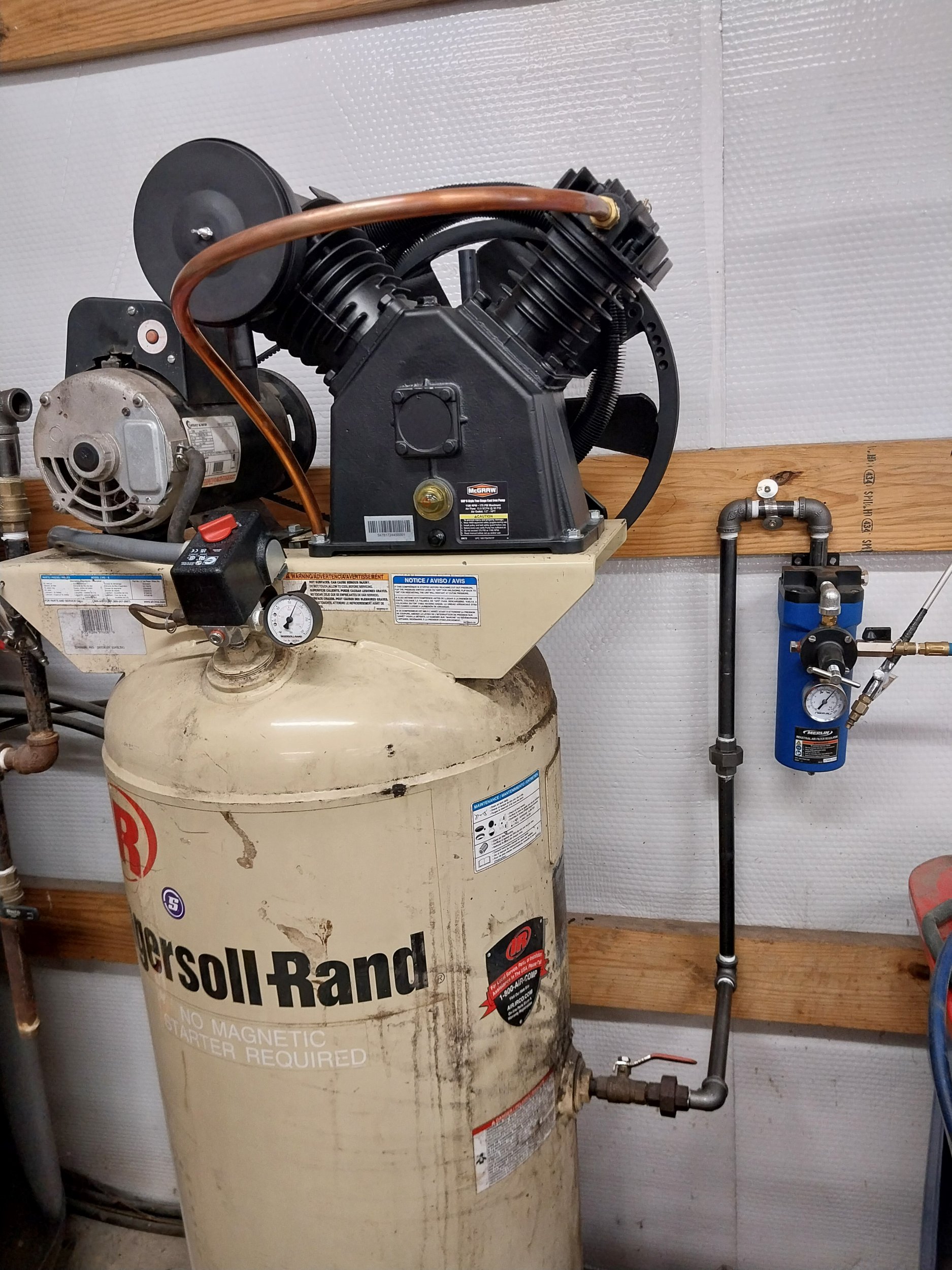

    Yesterday, my 23 year old Ingersaw -Rand air compressor pump retired. This puppy has the 120 gallon tank, a 5HP (6hp peak) electric motor, produced 11.8 CFM at 90psi, or 12. (something) at 130 psi with a 175 max psi pressure (I generally run it at around 150 psi).
    Maybe we need a moment of silence for my dead air compressor...
    I was dressing down a few welds when the compressor kicked in with a horrible screeching noise, so I shut it off immediately. This morning, I checked the oil level, it was a bit low, but not that low. I topped it off, because, well that is just the natural reaction. It didn't help, the noise was still there. I didn't expect it would solve the issue, buy why leave the simple chance go? I pulled the belt guard off, I thought maybe the belt died or the pump might be starting to locked up. The belt is good, the compressor pump turns freely, and the electric motor is good. I did notice that if I rotated the compressor by hand back and forth I could feel the change in direction giving me a thump, low in the pump body. I ***ume the rod bearings are not in very good shape. Not exactly what I wanted, but it has served me well for over 23 years, and hasn't seen the best care. I am my own worst enemy here.
    The biggest issue right now is the I too am reaching the end of my building days. This current project of modifying the dash to install gauges has extended into more then 3 weeks already, and looks to be less then 1/2 way there. I probably don't need this level of compressor any more, but I'm not quite ready to go without an air compressor either.
    I suspect buying a replacement pump is probably the cheapest direction to go, since the tank is in good shape (I have always bled the water off every day), and the electric motor works very well. The current pump is a single stage, side by side, two cylinder, with a cast iron block.
    I was somewhat surprised to find replacement pumps ranging from a low price of $99 to up past $1900. I'm pretty sure I don't want the $99 special, but I really don't want a $1000 pump either (I didn't pay much more then that for the entire compressor when I bought it new). Funny how old minds work sometimes...
    There seems to be a pretty wide selection in the $120-$150 price range, then the next step looks to be $220-$300 range, both "ranges" are listed on amazon & bay. If you go to an actual compressor parts outlet, the replacement pump is in the $600-$800 range.
    Other then at the compressor parts outlet places where their pumps are mostly two stage, which ups the CFM range (which isn't going to be much of a benefit to me, I seldom had an issue with the 11-12 CFM while I was working, I sure don't see a problem now).
    To me it looks like many of the lower prices pumps deliver the 11-12 cfm, but the max psi is down in the 100- 125 psi range, the higher the price, the higher the max psi. The $200-$300 range have a psi in the 130 range. Is that going to be an issue? I have never had a low pressure air compressor.
    Another thing I see is that there are a lot more 2 cylinder pumps in the V form, then there are in the side by side form. both look to mount to the plate on the compressor in a similar setup. I don't see a space issue with my compressor, but am I missing something else that may be important?
    I also do not see any pumps with a cast iron block, but there are a few with cast iron sleeves in an aluminum block, I ***ume those would be better then no cast iron sleeves?
    Any one have some advice?

    At this point, buying a new, complete, large capacity, compressor unit won't happen unless I have no choice. If faced with that, I would probably buy a smaller unit, and wait for it to catch up when I ran it out of air. It would remind me of the early days... That would ****, again.
    I do run air powered impact tools, die grinders, and air sanders. and a plasma cutter of this compressor, so changing all that stuff over would be pretty costly too.
    This current unit, being 23 years old, probably doesn't have many replacement parts available anymore. Even if parts could be had, I suspect a crankshaft and rods (which I believe is where the problem is) would probably exceed the cost of a replacement pump, then I would have to tear the pump apart and rebuild it myself. I can have a replacement pump here by the end of the week.
    I do have some concerns about connecting a new pump to this old tank, manufacturers tend to change that kind of stuff every 10 years or so, just to screw with you.
    Has anyone here actually changed out a compressor pump with a different one?
    Guess it looks like I have to decide if I want to spend $150, or $250 and take my chances with the lower psi numbers. The reality is, it only has to work better then a new $250 compressor unit for another 5-10 years.

    So I ventured into our local HF store tonight. They only show that they have 2 options, both are in stock in the store. The smaller one is only 5.4 CFM single stage, the big one is 17.5 CFM two stage! The big one is roughly $100 more (at $239) then the smaller one. The one I currently have was a 12 CFM single stage (at its lowest rating). Both HF pumps are V two cylinder pumps, my current pump is a side by side two cylinder pump.
    The smaller HF pump would be easier to mount up and make work, but I'm not sure 5.4 CFM could do the job for me (less then 1/2 of what I've had the last 23 years).
    The big HF pump is huge. It has a very large flywheel/fan/belt drive on it (maybe 4" larger diameter larger then the one on my unit). The flywheel takes a very wide single drive belt, nearly 2x wider then the "B" belt that drives my old pump. I'm pretty sure the flywheel off my pump will not fit the HF big pump.
    It also has a very wide foot print, I'm not sure it will clear the motor on my tanks platform, or if it will even fit on my platform (I do have material to add to my tank platform in house, if I need to go that way). Then the supply line to the tank is 3/4 diameter, where mine is a 1/2" diameter.
    The flywheel may be the deal breaker. I have never seen that wide of a "v" drive belt!
    Looks like I might be back to ebay or amazon (don't like either option), or pay 2x the price from a compressor outlet.
