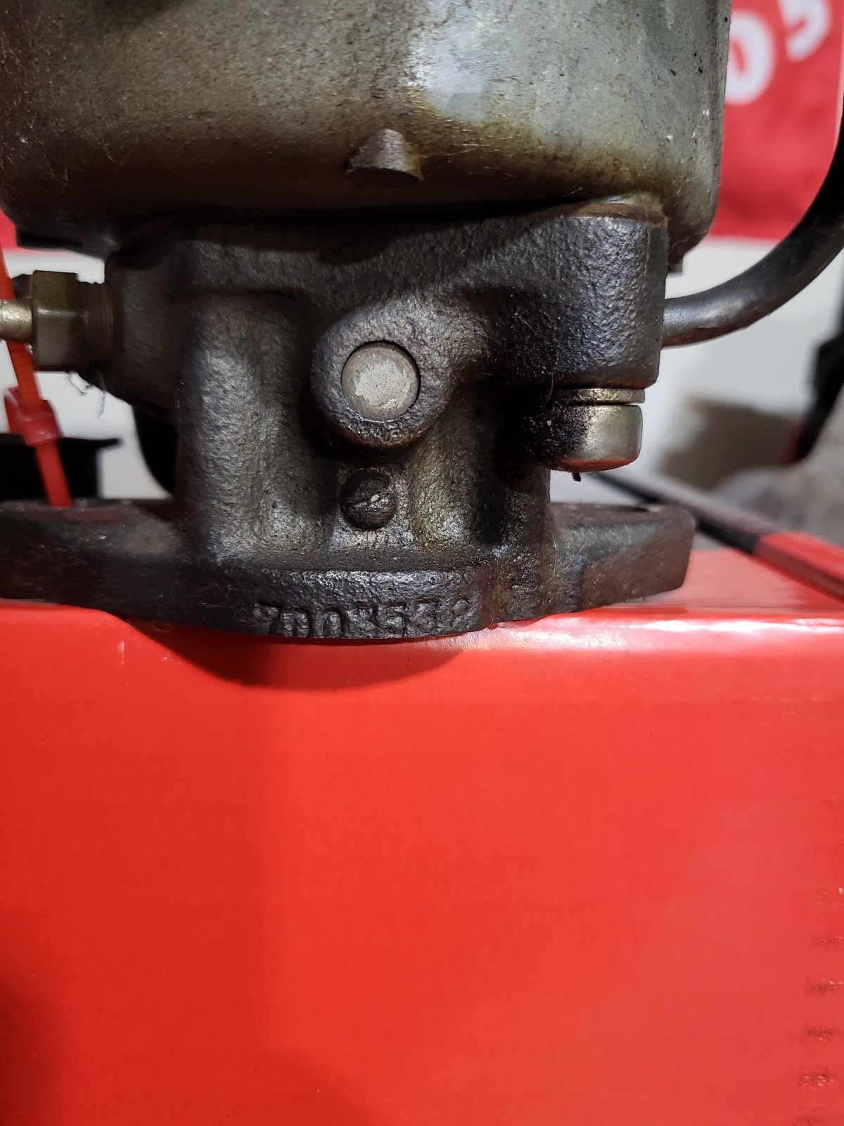

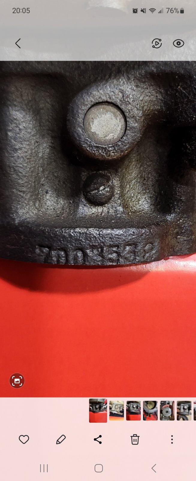

    It's a Rochester carb, it was in a 56 Chevy 235.
    Any guesses as to the stamped number? Trying to get the rebuild kit for it....
    I'm thinking 7003538 or ????
    Not of my guesses (there were a few more lol) are on the carb doctor website. Screenshot_20220913_200543_Gallery.jpg Screenshot_20220913_200526_Gallery.jpg Screenshot_20220913_200543_Gallery.jpg Screenshot_20220913_200526_Gallery.jpg 20220913_195435.jpg
    Thanks in advance

  2. fordflambe
    Joined: Apr 9, 2007
    Posts: 574
    fordflambe
    do a rubbing and see what you get
    JorgeFleet48 likes this.
  3. jaracer
    Joined: Oct 4, 2008
    Posts: 3,056
    jaracer
    I'd rub a piece of chalk over the numbers and then wipe off the body.
  4. wheeldog57
    Joined: Dec 6, 2013
    Posts: 3,857
    wheeldog57
    I see 7558 as last 4, good luck
  5. squirrel
    Joined: Sep 23, 2004
    Posts: 60,031
    squirrel
    that's a casting number. You need the number that was stamped on the br*** tag, held on by one of the screws on top. It's long long gone.
    kevinrevin, SS327, XXL__ and 4 others like this.

  8. HEATHEN
    Joined: Nov 22, 2005
    Posts: 9,058
    HEATHEN
    from SIDNEY, NY
    Clean off the gasket surface where it bolts to the manifold. I've seen lots of Rochester B carbs that had the last four digits of the I.D. number stamped there.

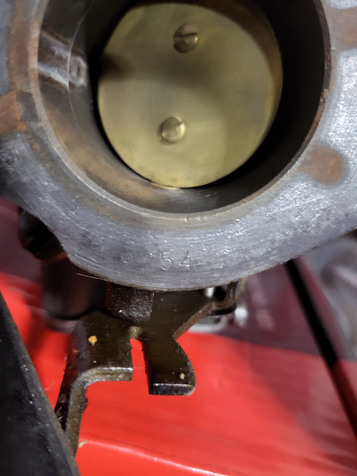

  9. JorgeFleet48
    Joined: Jul 11, 2019
    Posts: 82
    JorgeFleet48
    Well that's why I come here for knowledge, there it was 9254, right where you said.

  13. HEATHEN
    Posts: 9,058
    HEATHEN
    from SIDNEY, NY
    7009254 is from a 1956 Chevrolet p***enger car with a Powerglide.
    JorgeFleet48 and squirrel like this.

  15. sunbeam
    Joined: Oct 22, 2010
    Posts: 6,396
    sunbeam
    Motors manual only list 7009254 and 7009255 in 56

  17. carbking
    Joined: Dec 20, 2008
    Posts: 3,979
    carbking
    The 7003538 is, as mentioned, a casting number for a throttle body "blank" which could be machined a number of different ways, and used on a number of different Rochester type B carburetors.
    The 9254, again as mentioned by others in this thread, is the last 4 digits in part number 7009254.
    7009254 was used on a 1956 Chevrolet 235 p***enger with powerglide.
    One rebuilding kit number is a CS-337.
    This link shows application: https://www.thecarburetorshop.com/Kchevrolet1.htm
    Jon
