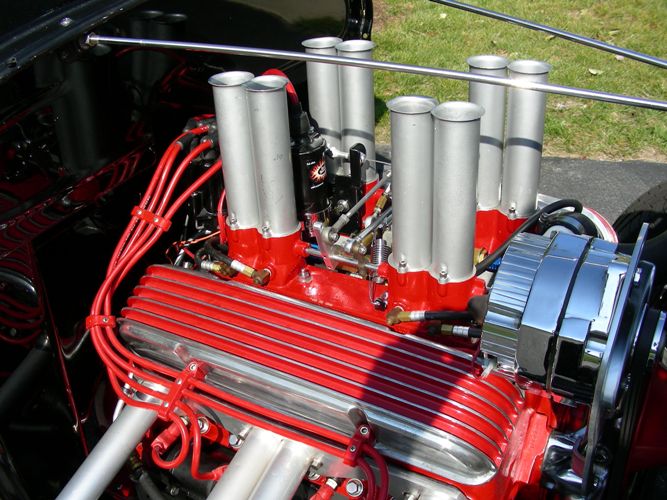

  16. My son's Model A hot rod - This is a real 302 ......from a Trans-Am Program parts bin......with vintage mechanical Hilborn injection. Flywheel dyno'd at 418 HP @ 7240 RPM. Some guys get more out of them, but we did not want to push our luck....
  17. DDDenny
    Posts: 22,433
    You had me at 302, tell us more!
