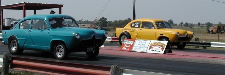

    Somewhat related and something I learned 50 years ago (+/-) in Engineering School at Mizzou: 355/113 comes out to pi for 7 (iirc) decimal places. I'll never remember the actual decimal numbers but I'll always remember 355/113 (2 fives, 2 threes, and 2 ones, the first 3 odd numbers). This is MORE than adequate to calculate cubic inches for any engine we'll ever be building. Perhaps if you're scratch-building an F-1 or Indy engine it might need to be more accurate.
    And fwiw Tommy McCray (weekender on here; RIP) called the engine in his national record holder yellow Henry J that he built in the mid 60's a 301. I wish I would have asked him if he punched a 283 or used a 327 block. Too late now.
