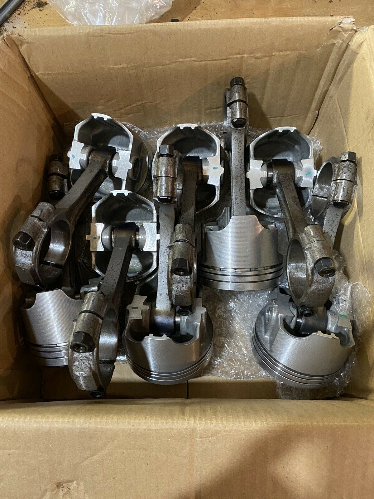

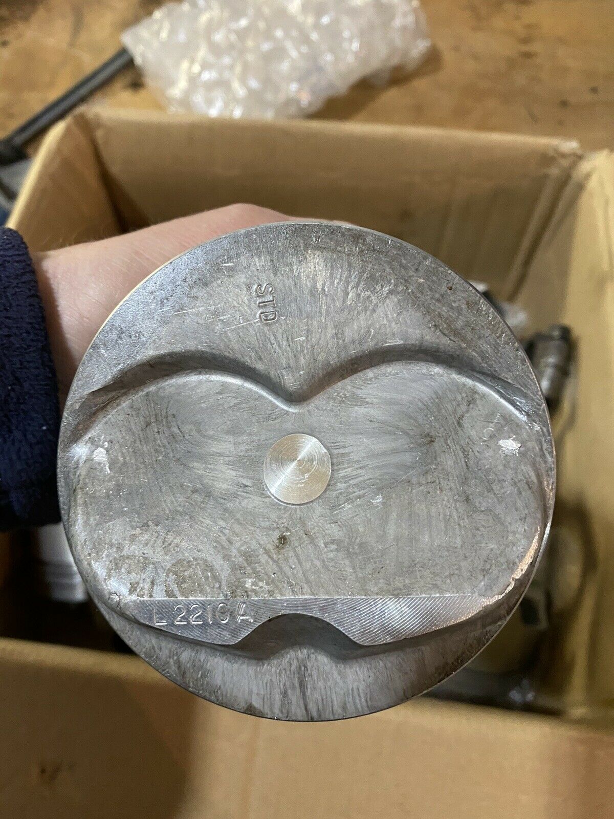

  21. irunonbeer
    Joined: Feb 1, 2018
    Posts: 11
    irunonbeer
    Not sure where to post this but if there is a better place please let me know, thanks! Good morning all! I have a set of stock bore TRW L2210 pistons for a 302. I know this is a long shot but does anyone have the same pistons in .030 or .060 over they would trade for these? I am building a 302, turns out the small journal 327 block I have had already been bored .030. I need to sell or trade these to buy the correct ones for it. I was told these are large journal rods with new ARP rod bolts.
