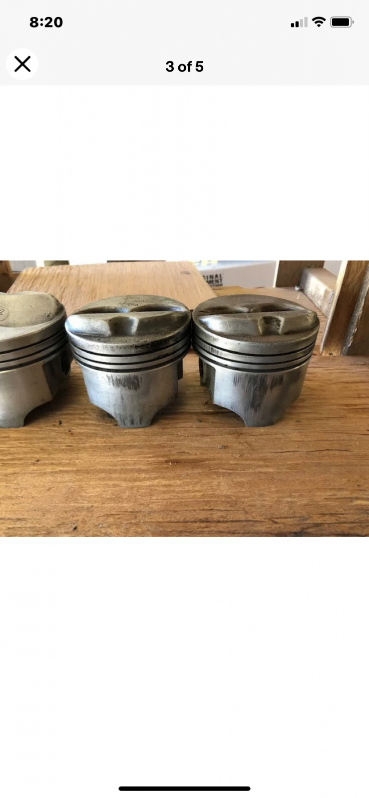

    I am looking at a set of .060 over 302 pistons and 2 have scuffing on the sides. What would cause that ? Are they still good to use? Thank you B5DAA32A-6A2C-47A9-8FC3-3865E41E56B6.png

    Dont like that, either lube issue, as in insufficient film, or tight. Over heat is usually more of a 4 corner scuff due to material around pin boss. Either way, their ash trays, Wisceo, SRP, JE make new pistons, go that route. Spend money in Pistons, will pay off.

    Thank you, kinda what I was thinking! Have a great day!

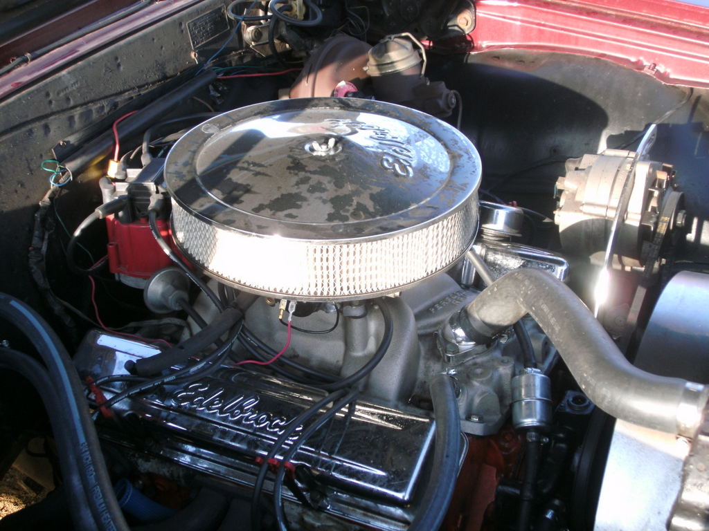

    well someone woke the dead here . been reading it for hours . almost forgot where it all started !! anyway . kinda on topic . seems like i read that gm made the 305 because it was the best all around compromise for bore x stroke.how does that compare to a 302 ? built the same wouldnt they have close to the same hp/ torque / rpm .?ive got a 283 and a 305 horded in one of my garages . is it stupid not to s**** them both . seems in the day of 454 sbc of the shelf , none of it makes much sense ! or is that ot ? i did have a built 283 in my old malibu with a muncie behind it . may not have really been fast . but , sure was fun to hit second in . and with the posi it kept you on your toes !..sure seemed fast 1965 malibu 007.jpg 1965 malibu 017.jpg 1965 malibu 013.jpg

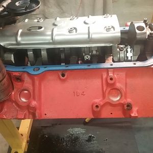

    Typical heads that can be used on a 302, 462 camel humps... donated to my buddy cuz his kids are building a sbc g***er.. teaching them how to build their first engines tomorrow. 20211218_145148.jpg
  30. GlassThamesDoug
    Joined: May 25, 2008
    Posts: 1,949
    GlassThamesDoug
    Yes 302 sj cranks were used in some HD 283 applications. How to tell is they have single notch in round flange. 5.7 sj rods can be pink or green code, green (floated) is more rare. The 327 blocks were same 2bolt sj castings used for 302. LJ castings are easy to locate, LJ cranks are available all the time on EBAY. Fundamentally a 3in stroke, 5.7 pink con rods, 4in bore is all it takes. TRW original design with GM part numbers are also available. All parts to build a component correct 302 are available ... its how much you want to spend. Cylinder heads are everywhere...no longer special, 462, 492, 291, 041, 040, 186, ..... MORTEC will give you casting, forging numbers that can be used for 302s. Camaro oil pans, windage trays and studs were available from GM 10yr ago, original intakes and correct carbs are available as well. Cams with correct grinds are available by at least 10 different cam grinders. This should answer.... YES its not difficult.
