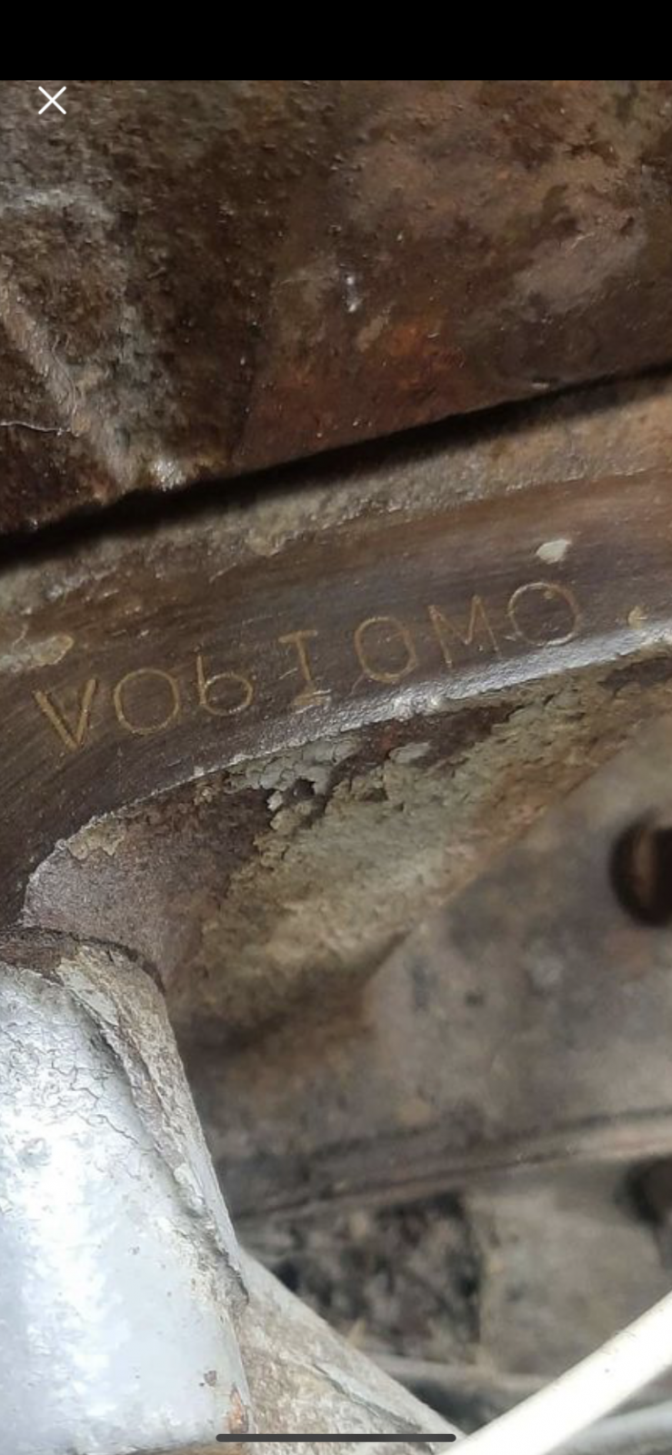

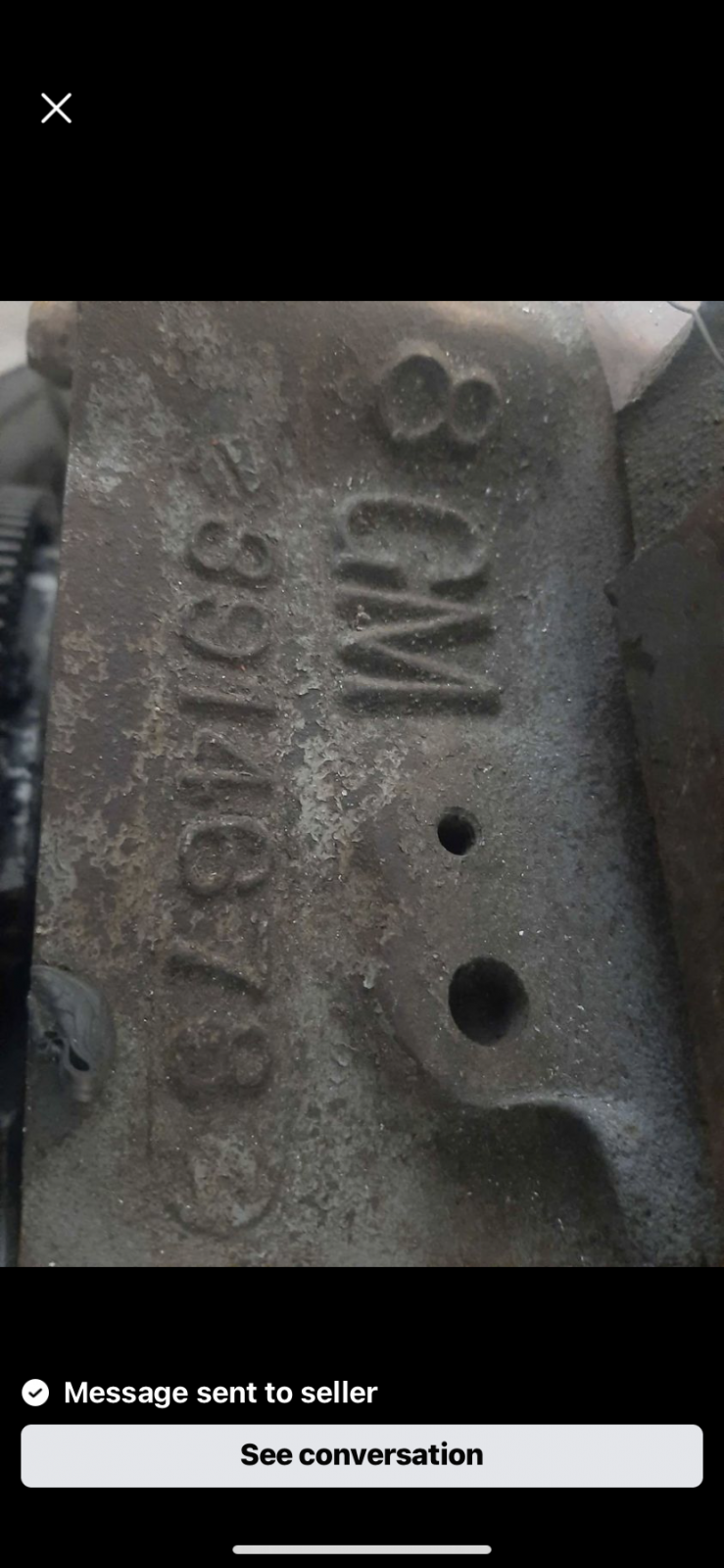

    New question everyone, I need help. Is this a true 1968 Z-28 DZ302 engine?? The heads are 333882. The block casting number and stamping numbers are in pics.... Thank you

    DZ is a 1969.
    MO is a 302 1868 stamp, could be 68 LJ, or 67 SJ. Check crank flange, round with one notch is sj. No difference in basic performance. Casting number is a LJ 302,327,350 block. www.Mortec.com
    Deuces and Bob Lowry like this.

    Give us more details, you for sure have a correct block and suffix code but those ‘882 heads are ‘70’s era smog heads. Large 76cc chambers and 1.94 In, 1.50 Ex. valves. The ‘68 302 would have 3917291 castings, chambers about 64 cc (?) and 2.02 In, 1.60 Ex. valves.
    Maybe more than the heads has been changed.
    Deuces and 26 T Ford RPU like this.

    In 70s... it was common to drop compression for the lower octane field. Easiest with sbc was open chamber heads.

    Yeah, I get that. The reason for my post was what might have been done with that engine over the last 54 years? Crank, pistons, cam, let alone the externals. No one knows without looking.
