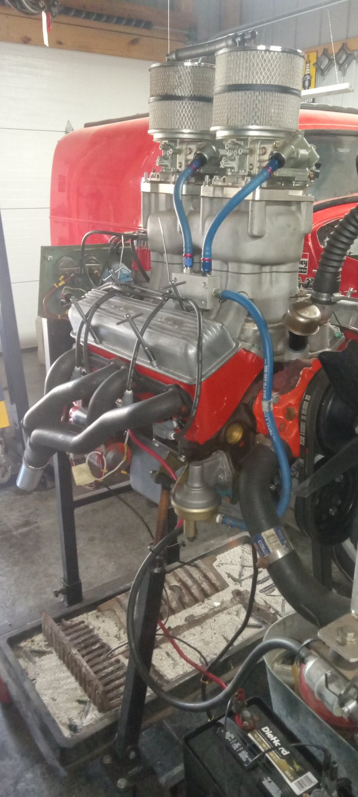

    I just got time to ****on up this hybrid. LJ block... SJ rotating ***embly using Milodon thick main brgs. 20220721_171711.jpg
    Deuces, rod1, brigrat and 1 other person like this.

    Going in... loaning this 302 to brother. Need room on engine stand. For my 67 302 build.
    Probably run tunnel first, then switch to single 4bbl. Run the early Nova next year, see what it can do..
