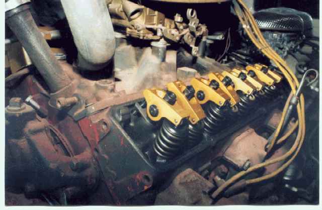

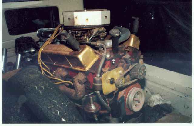

    In '68 I bought a new Z28. It had a forged crank that was not cut for an automatic. The rods were shot-peened and it had a manifold designed by some aftermarket company, can't remeber which. The two blocks for Z's were the MX and DZ. I normally shifted mine at 7200 and it would hit 8000 in fourth. That's 160 mph on I-29 north of Sioux Falls. It did hit 10,000 rpm on my Sun SST-10 tach a couple times. I currently have a 302 with a four-bolt main 0010 block and an original Z28 crank in the back of my '34 pickup. It's got roller rockers, pushrod guide plates, screw-in studs, Bowtie 1 heads, Victor Jr. intake and a real 780 Holley 3310 (not 750). It says Moroso on most of the outside pieces and also on the little sewing machine motor that drives a cogged belt to the water pump. I haven't opened it up, but I think it's a roller cam, too. I tried to sell it at one time, but nobody wanted to give me what just the heads were worth.

    Is that the original motor you bought in the Z28 or another 302 motor you got your hands on?

    This came out of a Camaro that had been drag racing at Thunder Valley in Marion, SD. Nobody in his cl*** could come close to his times so he decided to change cl***es. The car was sold without the engine but he didn't want the engine used anywhere near. As I was visiting from Iowa, it was available to me. The funny things on the top of the valve covers are exhaust scavengers. A hose went to the collector and as the exhaust speeded up. it pulled a vacuum in the crankcase to help seal the rings. Also, theres a deflection plate for the ****tershield between the block and flywheel. And I'm pretty sure the flywheel is 40 lbs fo high rpm launches. There's a neat Moroso pointer on the distributor shaft and a degree plate on the manifold so you can set the timing without a light. I originally bought it to get the heads but never broke it down.
