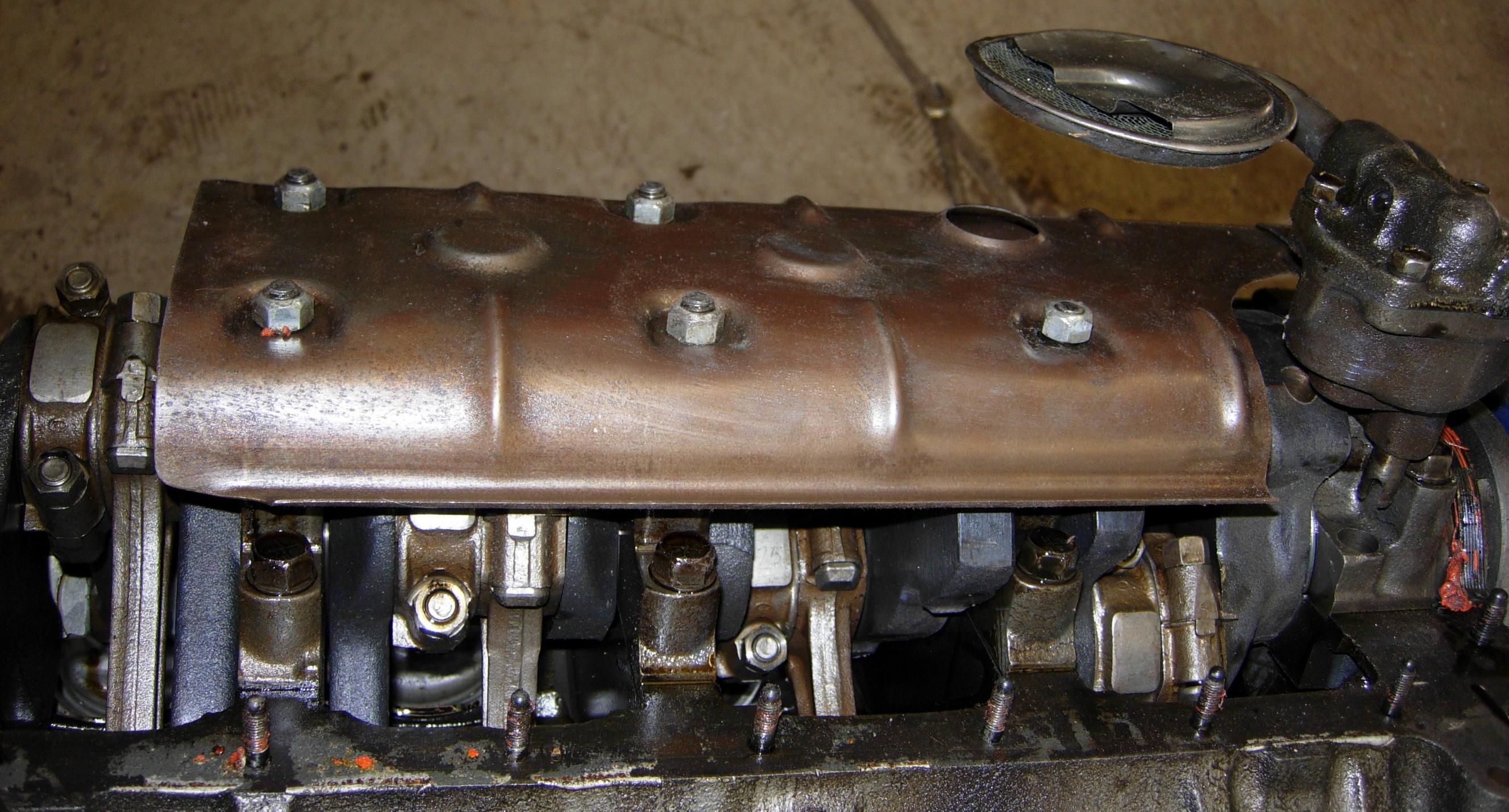

    This one's a 305. The cl*** was 307 and under.
    It will do whatever you want. I guess they are not real 302's without the proper casting number.
  16. Boy it sounds like time to get rid of the one I have.
    It is a clone with a an original 302 large journal crank/ rods/ pistons.
    I made it with a 3970010 block, And a smaller set of heads with 194 valves non accessory hole's with 194 valves, fully ported. A fully balanced ***embly / rods side clearanced
    Had it in a 70 Vega / chy 8/34 / 391 suregrip / 13 lb alum flywheel.
    / It would twist up too 8000 grand. The little car beat quit a few hemi cuds on telegraph rd in Mich in the 70s.
      513.4 KB
      210
    Deuces likes this.

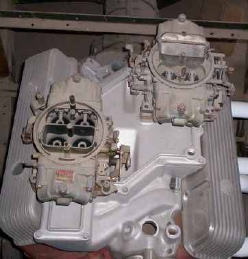

    It's just mocked up right now. I've got 3 different intakes to play with when I get my Anglia going again, this is one of them. It's an Offy, not a GM. That's probably not gonna happen very soon since I'm working on the 55 right now, not the Anglia.
