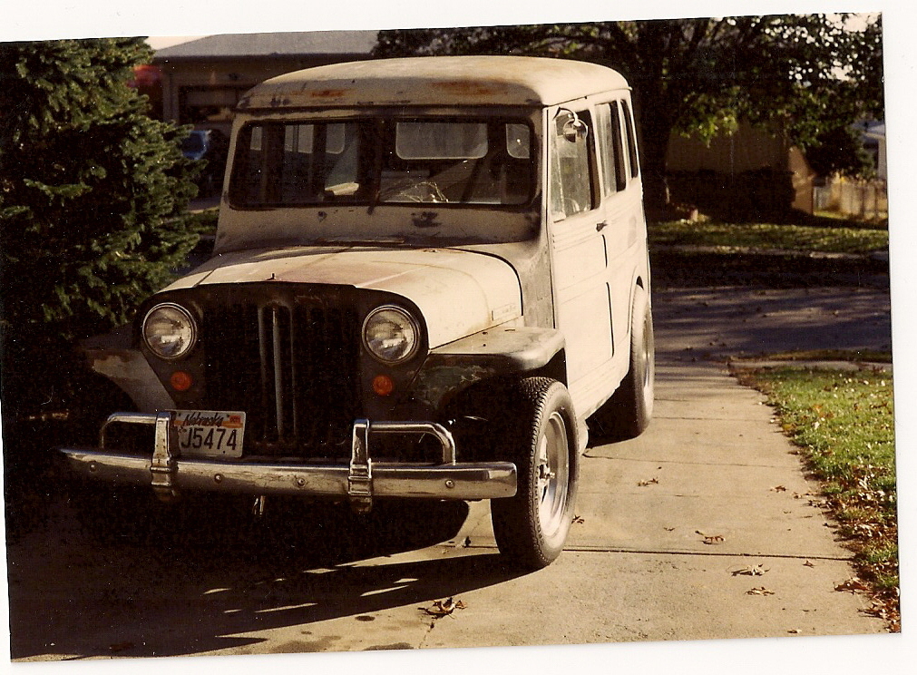

    Lucky Strike 302 chevy motors are one of the most fun engines I've run in my cars. I built one from a 283 and put it in my 49 Willys wagon but kept it when I sold the wagon....put it in my 53 F-100. Shoulda put it in a much lighter body.
    I have almost enough parts to build another one with better parts. Got a set of 11:1 TRW forgings [heavy], a set of NOS Oliver steel rods, an old '65, 283 block and crank with a pair of 186 heads in 1.94/1.50 valve size. No cam or intake yet. I'd love to buy a set of more modern pistons and AFR aluminum heads but ......I dunno.
    If the Pontiac motor in my coupe blows up, I'll build the 301....or 302 or 301.59 or what ever! 49jeep.jpg

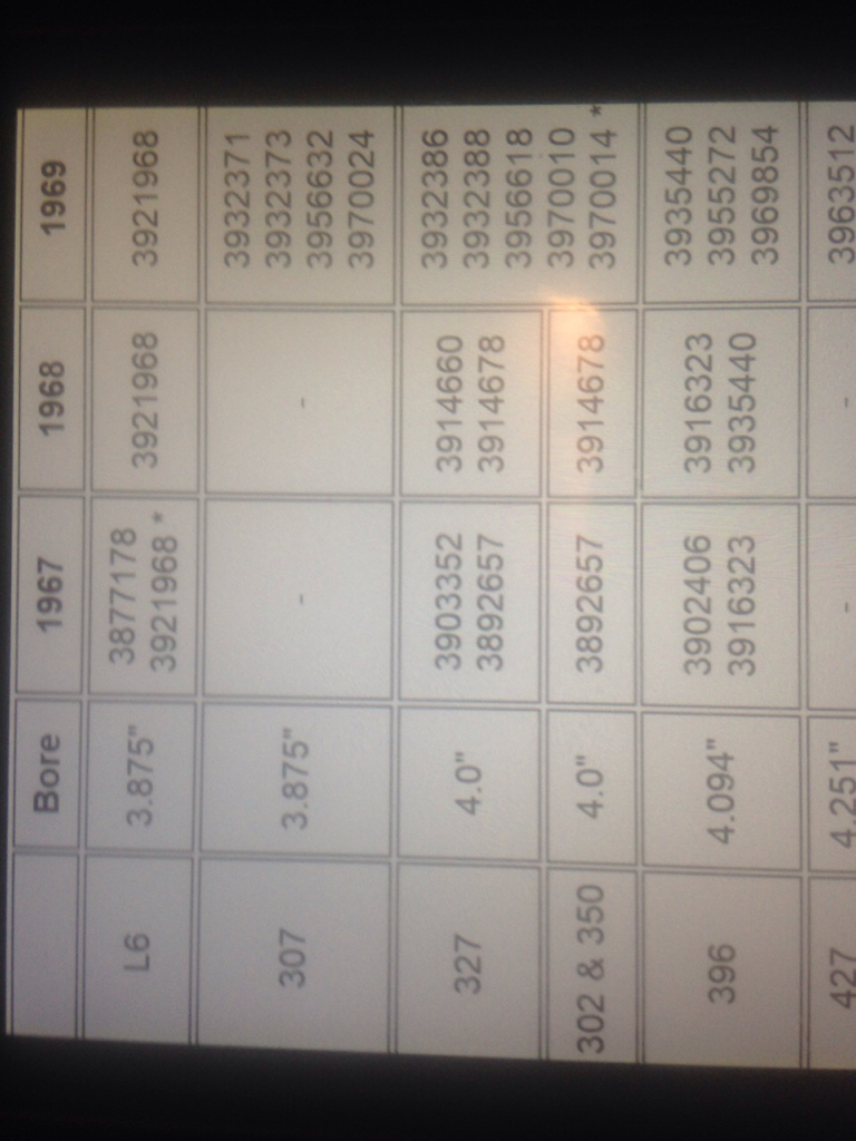

    Old memory ain't what it use to be. After your post, had get the chart. These are f body engine block casting numbers. 014 block was 350 only. There was a 3959512 warranty block also used in some production 1969 dz motors. The mo small journal was used in 1967 and the mp was smog 67 302. I was told that a few early mo small journal with replaceable oil filter cart rage blocks were use in 68 z/28 but never seen any proof. As far as I know in 1968 all 302 blocks r large journal mo.. [​IMG]
