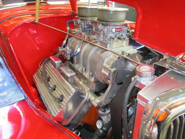

    392 Hemi 1.jpg The machine work should be the same no matter what engine it is.... Parts are where the expense comes in... Hot Heads is the go to place for hemi stuff...You can get a good set of roller lifters for around 400$...You can run up to 11 to 1 compression with no detonation due to the hemi head....I like mine...

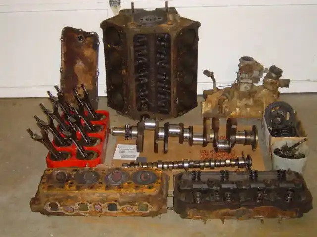

    Those are my lessons learned. I bought a truck 354" (Chrysler Hemi #1619829), originally installed in a Dodge school bus and a set of #555 354 car heads. I have no regrets.
    Before & after::cool:

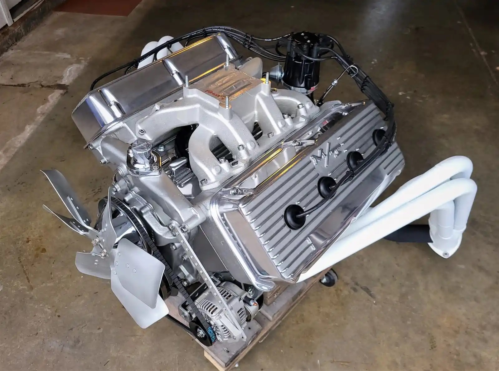

    One day I will have time to work on this....
