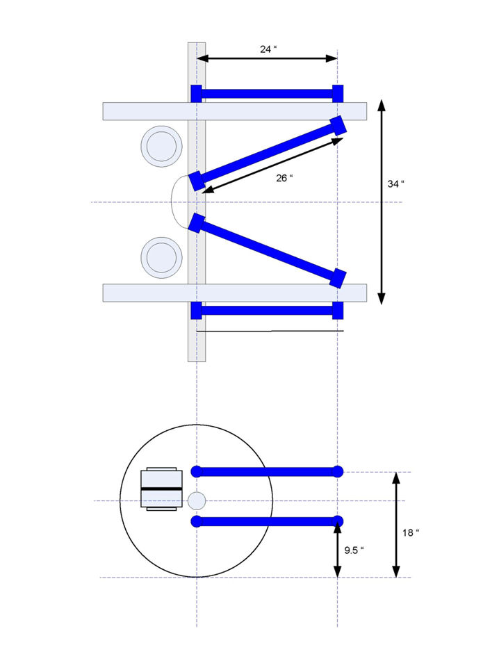

  1. MeanYellowZ
    Joined: Jan 10, 2007
    Posts: 60
    MeanYellowZ
    In a stock Mustang it isn't bags, but the springs are mounted on the lower arms. The uppers and lowers are shorter than in my setup since they weren't designed to have as much suspension travel as I am aiming for. The Mustang uppers are 43* apart and start out on the center of the rearend and aim outward. This is made possible by the brackets that are part of the rearend and center section and the wider frame mounting point. The only thing really adapted from the stock Mustang design is placing the "spring" (bag or coil) on the lower bar at a point between halfway and the rear of the lower arm. This is also similar to a 58-64 Impala rear setup.

    Ned Ludd
    Remember that, hypothetically, a triangulated four-bar can work upside-down. In fact there might be some dynamic advantage in it. It's not the conventional way, but there is no reason you can't have a pair of very long angled lower bars (fronts close together) and a pair of relatively short parallel upper bars. The difference in bar lengths in absolute terms would be greater than the other way around, as the ratio of lengths as seen side-on is what is important.

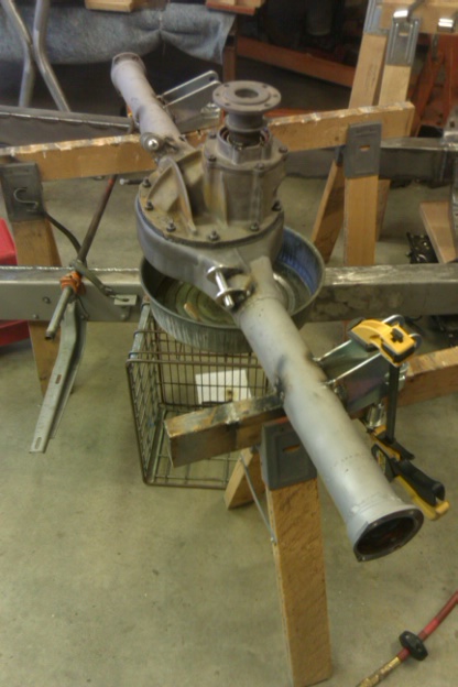

    It depends on what your frame does over the axle (I can't see your latest photos as I'm on a cellular modem and the reception is awful where I am; they're taking forever to load :mad:)

    from il.
    Yes, there it possibly is, no one says that the bars need be straight on the top do they? They simply need to attach at given angles and across a given distance. Therefore if the bars are fabricated with an s curve within then to gain a length advantage will that work? You could then connect at the 60 degree angle as well.

    LaidoutRivi63
    First of all, depending on the size of the air bag you use, you can duplicate the ride characteristics of having the bag on the bar with a bag mounted out back, but it would have to be a much softer spring rate bag. You will, however lose that lift. This is ***uming you know the load your airspring will see on the bar, and have figured how stiff or soft it will be at ride height.
    You may have to if you want a certain setup to work. Not to criticize but when it comes to setting up something like this four-link, planning is the most crucial stage. When I did our 40 merc, the front bridge pieces didn't get fabbed until all the links were in place and in their correct places. If you design as you go, this is the learning curve you will face.

    gimpyshotrods
    Box the frame rails ahead of the bridge notch, run the upper bars parallel to the lowers inside the frame rails, and run a panhard bar or watts-link. Call it done.

    designs that work
    Been following this thread and all the ideas. I am not a expert and I did not stay at a Holiday Inn. You are very concerned about the highth of the top bars, would it be possible to move the angeled upper bars to the front of the axel tube. Right now the brackets set on top of the tube,could you rotate them to the front of the axel tubes and make it work?

    MP4/8
    I do a lot of air ride work. Let me clarify that statement for you... If you use a bag that is to large (as in weight capacity), mounting the bag on the bar will soften it due to the leverage. What that really means is that if you make a poor selection in the purchase of your bags, this is the way to get by. A smaller bag, specifically a firestone F9000 bag, mounted behind the axle like some have suggested, will give you around 8-9" of lift, along with the nice ride your lever system will.
    What you are trying to do, isnt uncommon in the minitruck & sporttruck world. That doesnt mean it is good. It also appears you have bought your parts and got all your info from that same group. These guys here are giving you some good advice. But it appears you waiting for an answer you want to hear. If that is the case, go back to the minitruck forums, and they will tell you how to do it. But if you want it right, listen to some of the advice you have been given.
    And last, early chev truck frames are to narrow to really run a triangulated properly. And by early, that goes to pre 88 chevs.

    LaidoutRivi63
    This is false. Not trying to find holes in your arguments, but if you are going to put a suspension system together, it is best you know the physics of it all. If you mount a 'bag on a four link bar, if it is between the axle and the pivot point, the mechanical advantage is given to the rearend. In other words, the bag "sees" more weight than the car is really applying. Therefore it takes more air to reach a given height than if the same size 'bag is mount atop the axle, which applies a 1:1 or near 1:1 load depending on positioning. This makes for a better ride with a big bag due to the stiffer spring rate of the increased air pressure in the bag. If you do what the previous poster suggested, and use a smaller, sleeve type 'bag, it will accomodate your setup much better, and provide the same results. Smaller 'bag can lift less weight, but mounted out back of the axle, is given the mechanical advantage, and and the spring rate is applied in the same manner, only reversed. Thats a vague and generalized but it gives you an idea of what you are dealing with. pickups are especially light in the rear, so too big of a bag, even mounted on the bar in the location you are suggesting, will produce a very soft, bouncey, ground-pounding ride.

  12. MeanYellowZ
    Posts: 60
    MeanYellowZ
    Well that sure doesn't agree with 90% of the information you can find on the net and my personal findings. Using a larger bag to get the same amount of lift with less pressure has also always been a nice improvement over a small bag with 90psi in it just to maintain ride height. I have bagged a handful of cars and they always ride better with the bag on the bar versus the rearend and are way less bouncy. This seems to work well except for heavy load/ haul/ tow situations. I would never place the bags on the bar in a dually for instance. In many setups where the bags have been moved from the rearend to the bars it always takes less pressure to raise the truck to the same level which results in a better ride.
    Do a google search on bag on bar versus bag on rearend and a mul***ude of sites and threads come up with the majority all for moving the bags to the bar. This is also what has brought on a huge amount of bag on bar suspension setups over the last few years by most of the major suppliers.
    At the end of the day the purpose of this thread was to look into different ideas for my upper bar dilemma with this narrow frame setup. Some good ideas were brought up and I am looking into how to put them in action on this setup. I appreciate those who were able to stay on track and help me with some ideas for that.

    Could you elaborate?
    My second-to-last post was about running the upper links parallel inside the frame rails as a solution to rescue this setup, already partially welded.

    KrisKustomPaint
    Finished the bed floor before the suspension huh? Here's what you do. Take your 4 link throw the whole works in the garbage. Go to the junk yard get truck arms off of the 63-72? Chevy trucks.
    Problem solved.
    You can stick your bags in the middle of the truck arms with out worrying about bending the lower tube.
    No upper links to get in the way of your bed floor.

    from Colorado
    Weld uppers to diff housing, below top of diff housing so as to not hit bed.
