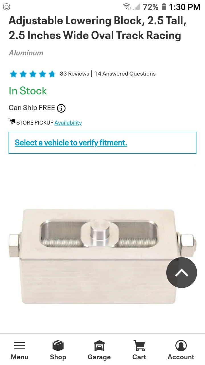

    These are used a lot, but no where near the 4" you are looking for. Screenshot_20210711-133030_Samsung Internet.jpg

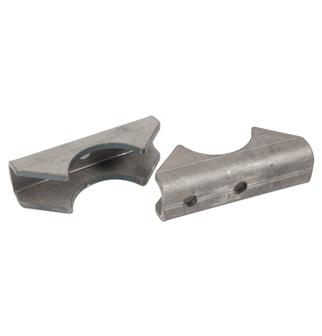

    If I were to use the flat plates that you fabricated I would put a proper U bolt around the plate and the spring on the far side of the pin from the axle to make sure it stays in place. Spring pads.jpg
    If you are changing rear axles you could fabricate extended spring pads similar to these that are intended for 47/54 Chevrolet trucks to center the rear axle. They obviously would have to be long enough to move the axle back but you could also adjust the ride height with how thick they were between the axle and spring and not have to add lowering blocks.
