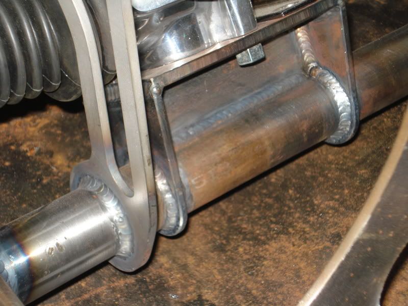

    On our Bonneville car... we want to powder coat the roll cage, and inside the frame rails and belly pan and even under the frame/belly pan (they are one piece).
    Here's an early construction pic where you can see the frame rails and belly pan that is welded to the frame rails:
    But the frame rails are exposed, and we want those to be body color. We will have to do a little bondo work on them to make them perfect... then prime, paint etc...
    Way 1) We would have EVERYTHING powder coated... and then scuff the powder coat up on the exposed frame rails... lay some mud down, block that, cover it with primer... block sand, prime... block sand, prime... etc... then paint.
    Will this work?
    Or Way 2) Should I have the powder coaters put some of that tape stuff on the outer rails so we have bare metal there to paint to?
    Or... Way 3) Should I have it all powder coated, then strip the powder coat off where we want paint?
    If we do it Way 2) or Way 3).... we can have a tape line were it won't be visable... but is there any problem with the paint being partially over the powder coat?
    Your help is muiappreciated!
    Sam
