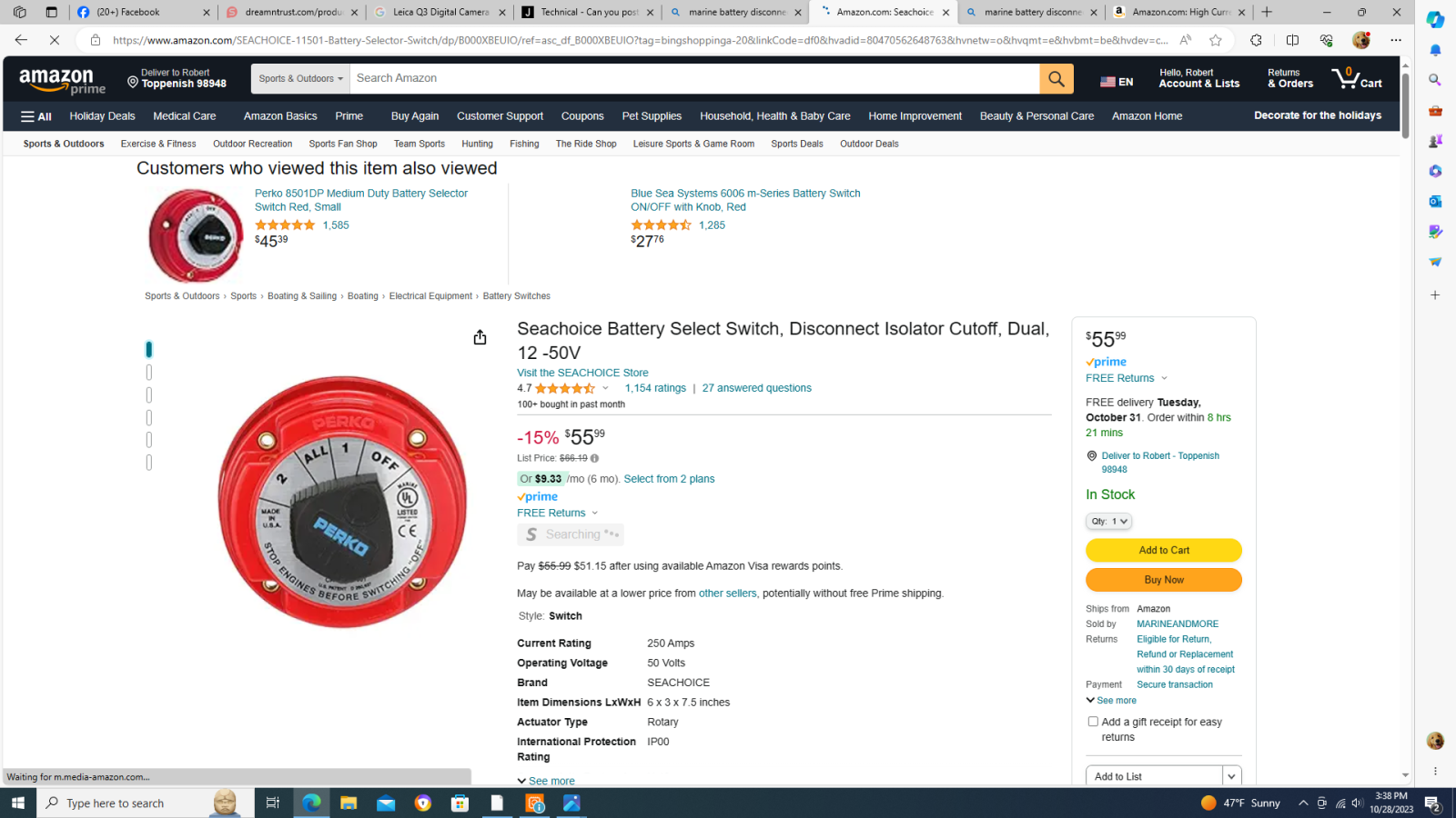

  11. Mr48chev
    Joined: Dec 28, 2007
    Posts: 35,854
    Mr48chev
    A Quick car master disconnect switch is only rated for 140 amps Or the one below it is rated at 300 amps.
    My 25 ft Bayliner with the 350 in it has one of the Perko disconnect switches that works great but they are designed for 2 batteries and are rather large. It might get confusing with one battery. Screenshot (231).png Screenshot (232).png Screenshot (233).png
