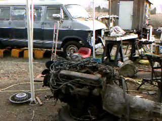

    When my 77 1 ton with a 454 vapor locked due to an exhaust leak blowing on the fuel line I poured gas in the vent tube of the carb and made it about half a mile 100 yards at a time by filling the vent tube and firing it up and going until it ran out of gas and repeat while pulling a 25 foot boat. I'd blown he donut between the manifold and head pipe out.
    That is also how I ran this Cad 500 for a short time.
    Click on the link. https://photobucket.com/u/mr48chev/search/p/cf92272c-8c8d-4652-b971-39be47239035?q=CAD [​IMG]
