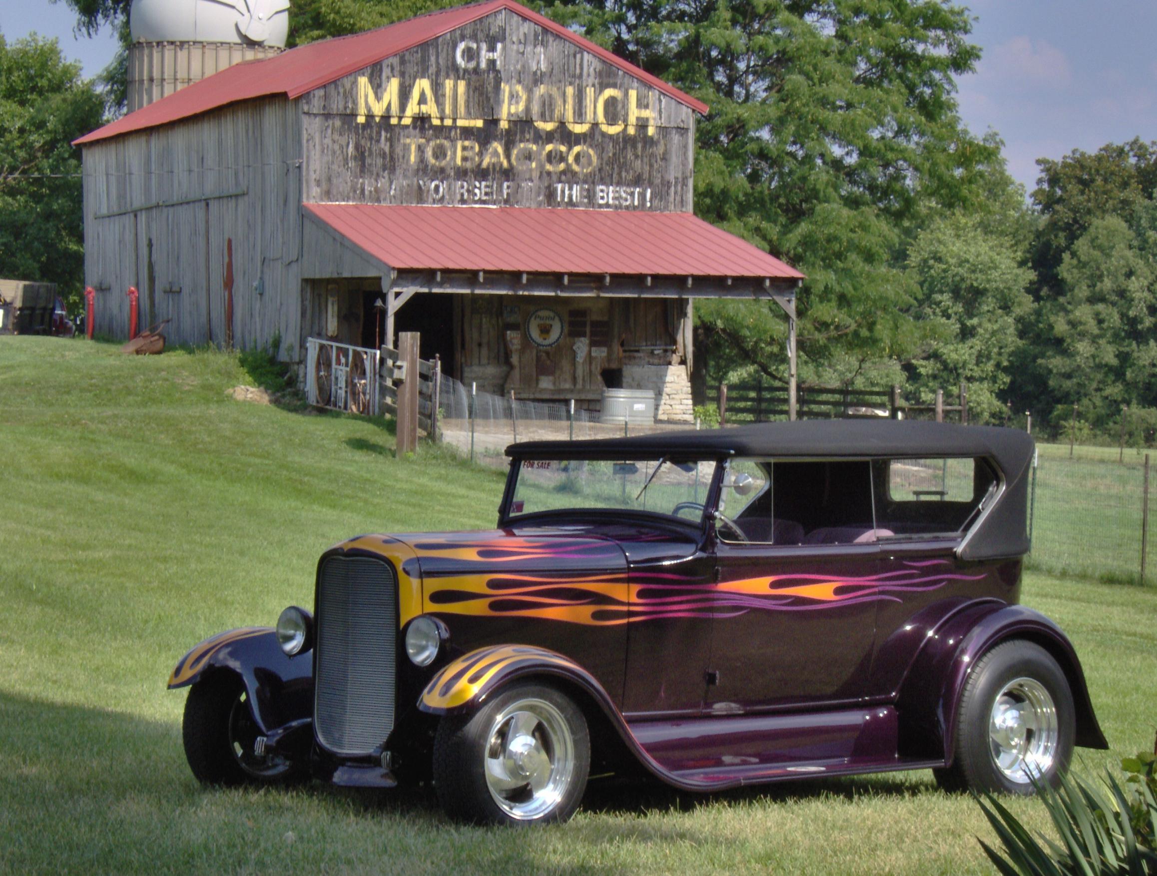

Beautiful truck! Being from Limey Land I'll bet you ride around biting lime wedges just to get the shit eating grin off your face whilst herding that thing down the road. Nice! Nice! Nice!

Oh no it aint mine , you need to check out the The Alexander bros and this was their shop truck which was "The Grasshopper" .
