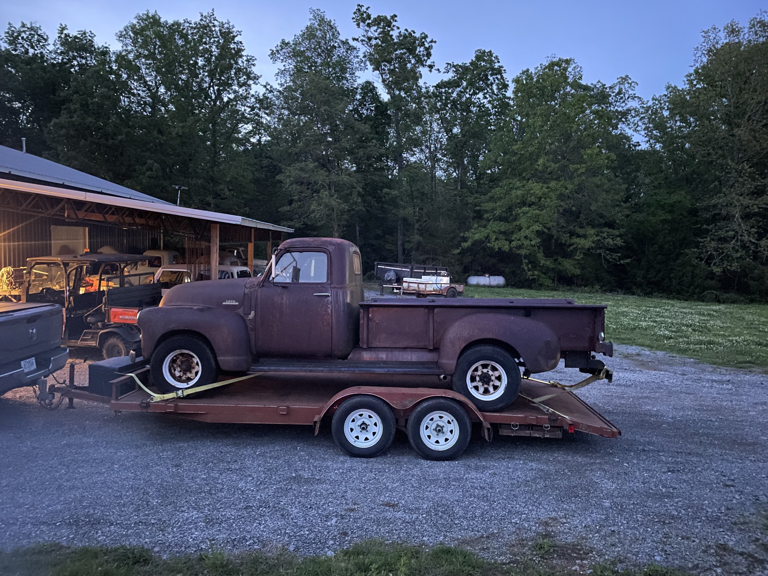

    IMG_7773.jpeg IMG_7775.png IMG_7774.png I drug home a 1948 Chevy 3800 which is a 1 ton truck that has the 9' bed on the back. It has had some cool upgrades done on it in the 60s which includes a GMC 302 straight six. I would like to replace the granny 4 speed with a 5 speed overdrive. I am going to use this as a truck still and was worried a T5 may not be strong enough. Is there another trans that would work like a NV3500 or NV4500 or should I just run a T5? I have several T5s laying around so I could try it but would like to just do it once.

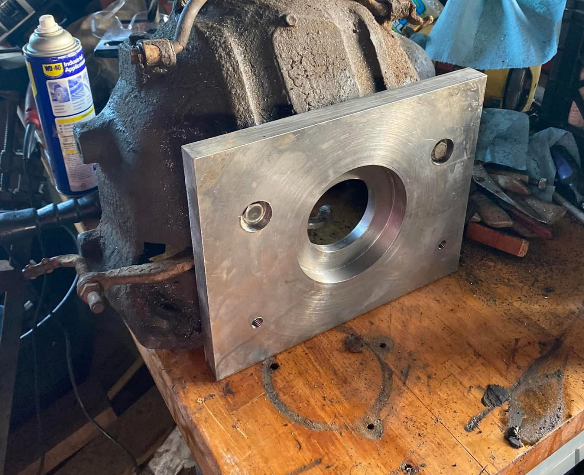

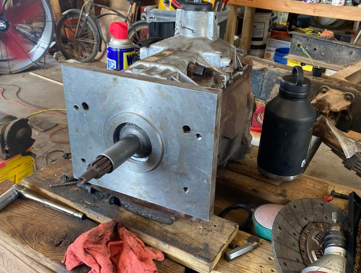

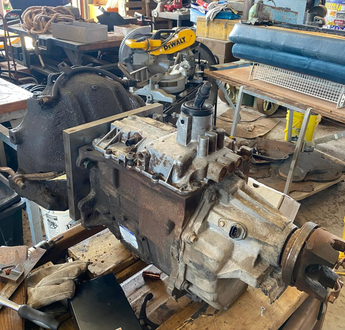

  4. Stovebolt forum could be a good source for info.
    One of the military forums had a guy bore the bell and redrill the nv4500 pattern.
    These pics came from the stovebolts r us FB page
    one issue could be the parking brake.
    if the rear end doesn’t have a provision the trans needs one.
    both the 3500 and 4500 can be found with a parking brake.
    The 3500 has the standard Chevy bell made on it. So an auto adapter could physically hook it up.
    But then you get to figure out making the clutch work.
