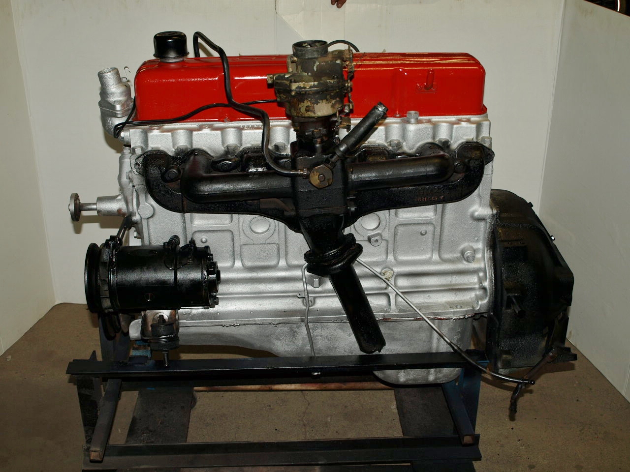

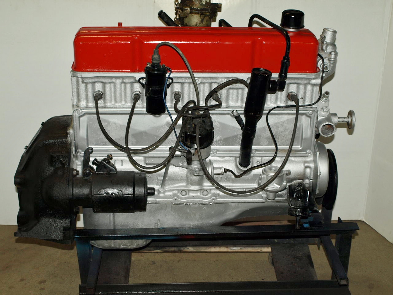

    Here is a pic of what I have.
    I'm thinking that all I need is the rear hose and new filter but since that front hose is so old I should replace it too. All I'm interested in is getting this system working again. I'm not interested in installing a full flow system.
    They way I understand it is that you only knock that pin in IF you are installing the full flow kit which I'm not so I should be okay leaving it where it is.
    So if I order a set of hoses and filter cartridge for a 235 I should okay, right???:confused:
  7. Lotek_Racing
    Joined: Sep 6, 2006
    Posts: 689
    Lotek_Racing
    Yup.
    Think of it like the 305 / 350 engine family.
    Our 261 is just a bigger 235.
    Shawn
