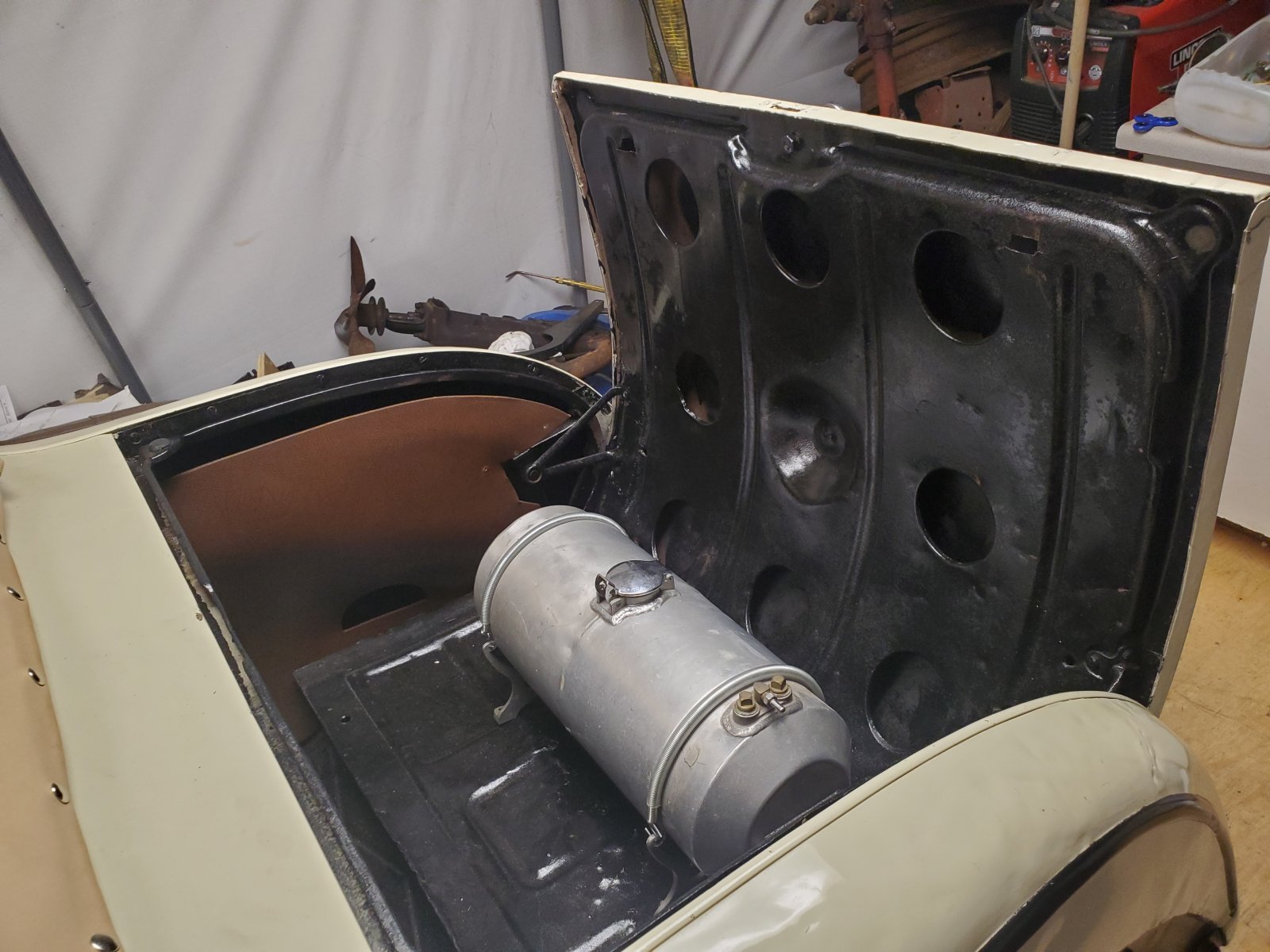

    Brief update,
    Now I finally have somewhere I can wrench on this over the snowy season I can get on with all the little jobs.
    Re wired the whole thing with a factory style harness, swapped in a lightweight and Balanced flywheel with a v8 clutch, mounted my "temporary " gas tank and ran new hardlines from to back.
    Ran into some clearance issue with the stromberg hitting the distributor so I'll be making up some small spacers for my intake.
