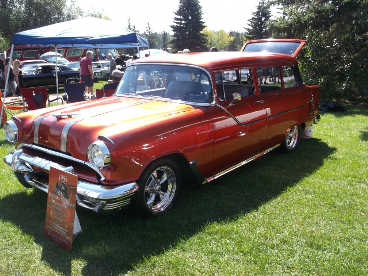

    This 55 Canadian Pontiac 2 door station wagon is a good example. A 55 Chevrolet complete front end (sheetmetal) will bolt/swap right on, and the same with the tail lights. It's hard to see much of the dash, but does it have the 55 Chevrolet dash? I saw a 55 Canadian Pontiac sedan delivery that had a 55 Chevrolet dash. It had a 261 and 3 speed column shifted transmission also. 115 inch wheelbase also, the same as the same year Chevrolet; Chevrolet frame and suspensions, and a Chevrolet rear end. I am Butch/56sedandelivery.

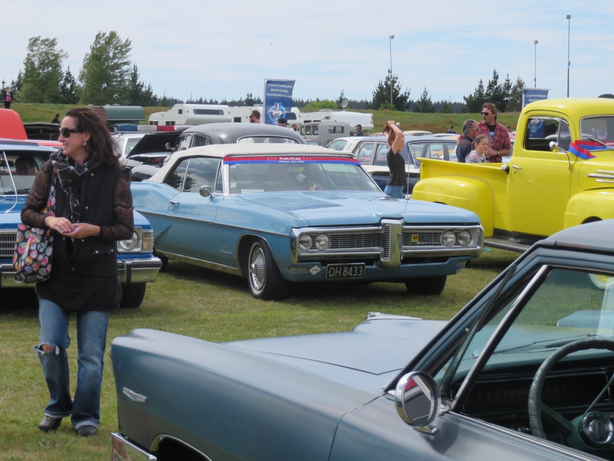

  21. This Parisienne convertible has lived in NZ since new. In comparison the car in the foreground is a recently imported US Catalina two door post sedan
