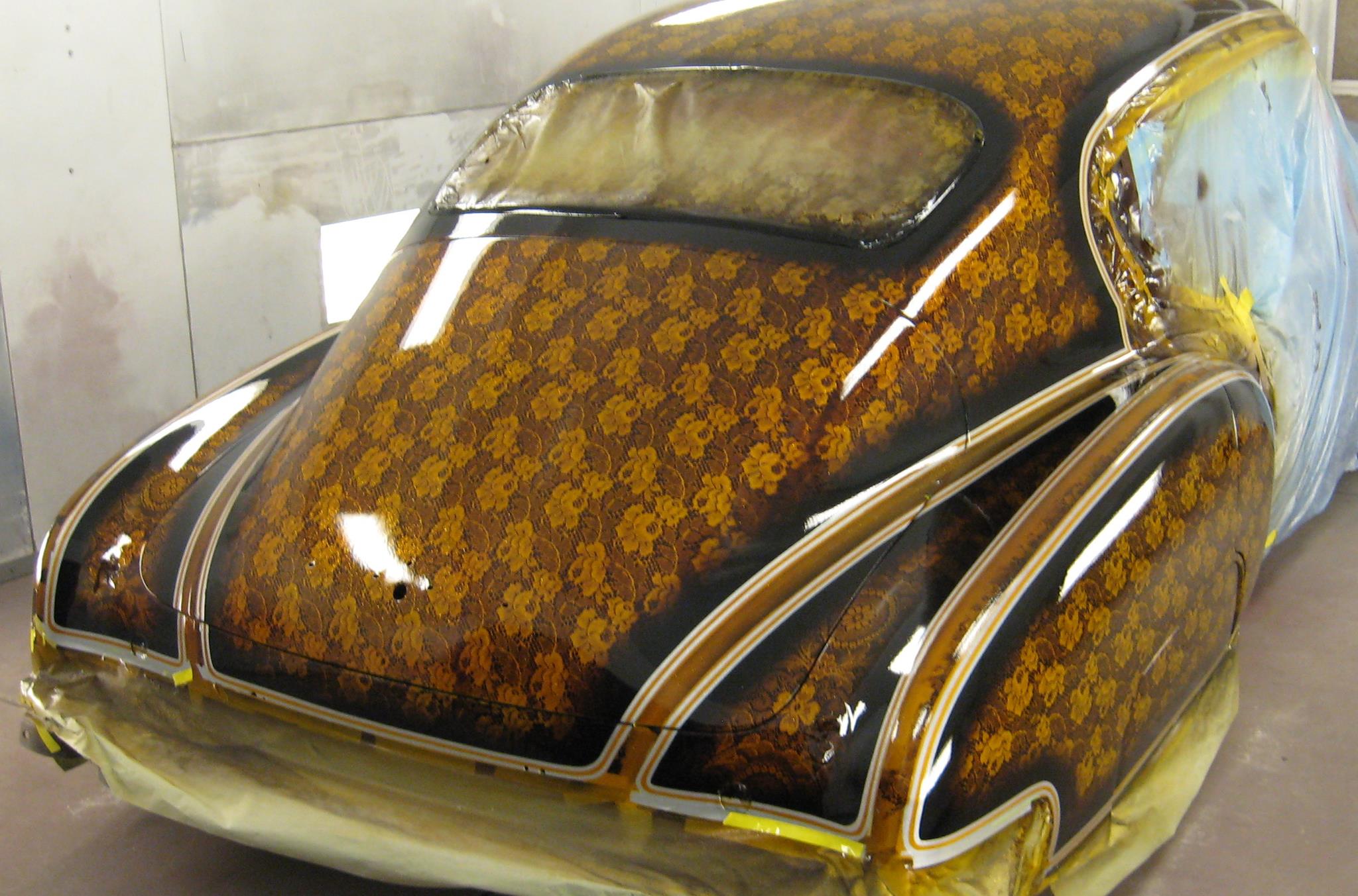

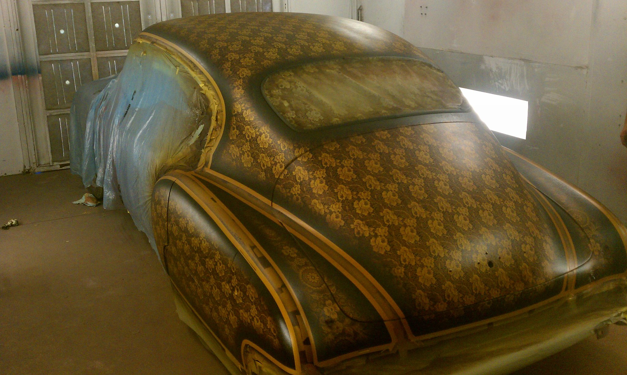

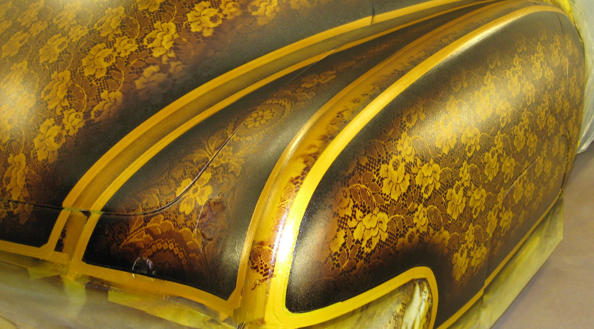

    got some lace candy and flake laid down today not finish 169351_10151033656810489_1860535612_o.jpg
    338847_445737108791358_729143540_o.jpg ed yet

    @Trailer Park Playboy
    i really really really like that man!!
    also how you used different lace patterns on top of the fenders
    can't wait to see how it will be finished!
    i was wondering where do you guys get youre lace?
    i always visit fleemarkets in the hope i'll spot some curtains but it's hard (i'm from the Netherlands)
    most of the times there not filled completely which i like when doin a roof, or the designs aren't that good..
    so where do you guys get em?

  15. trailer park playboy
    Joined: Jun 2, 2009
    Posts: 59
    from tulare ca.
    Honestly i hard a hard time finding it then my aunt was dumpster diving and found it

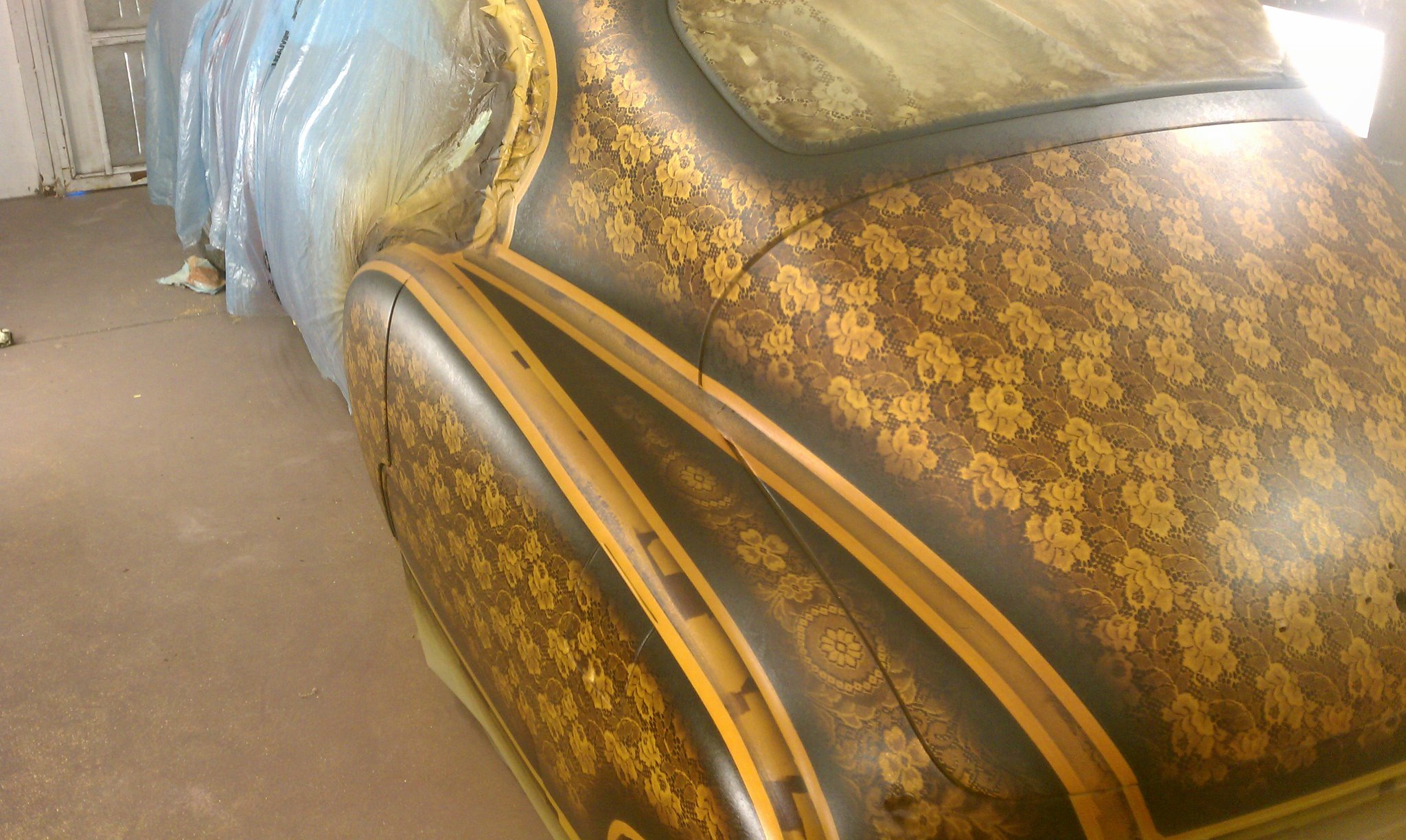

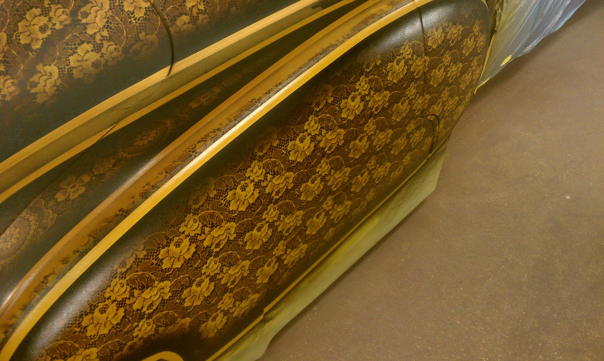

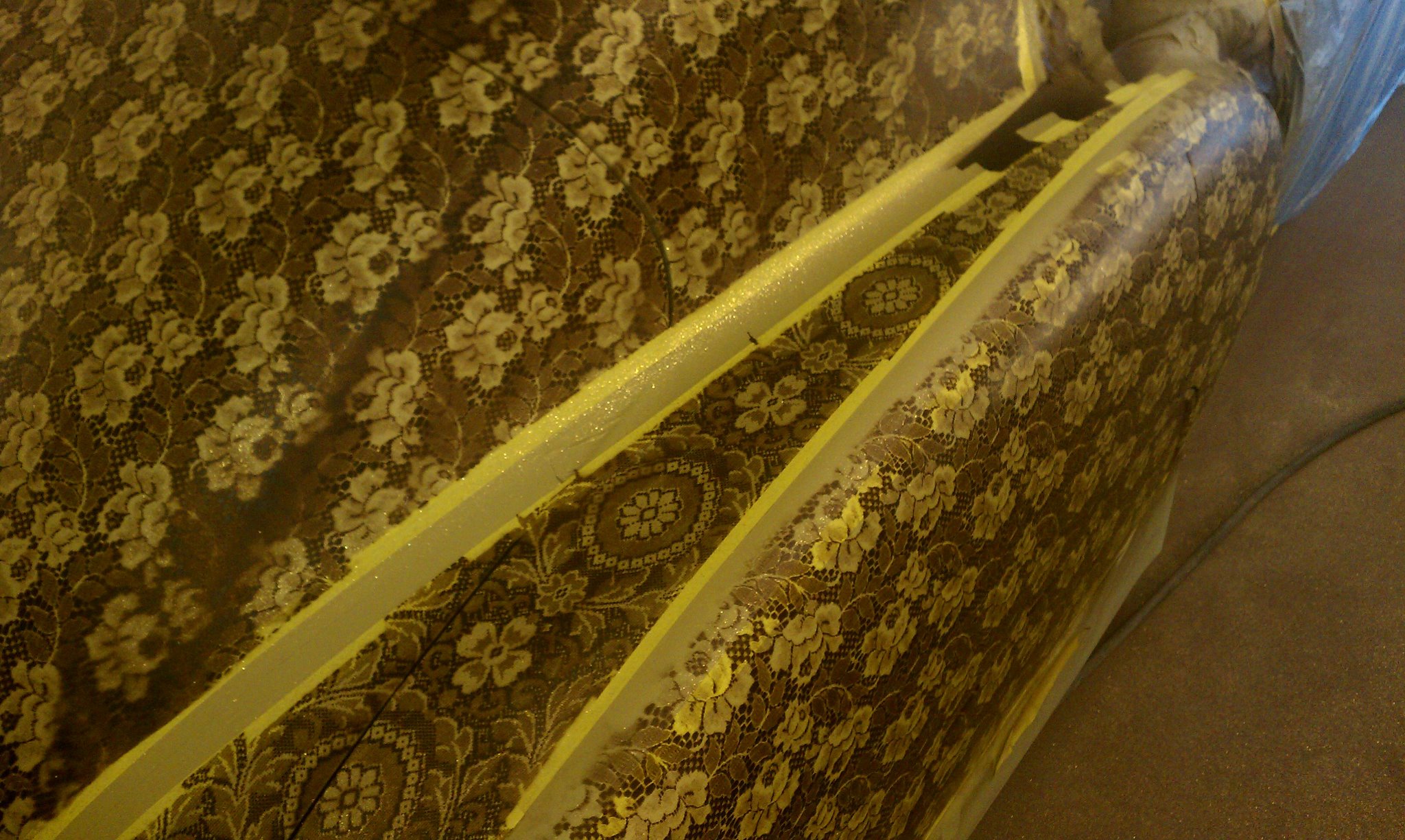

  17. thetwistedpiston
    Joined: Sep 3, 2011
    Posts: 105
    thetwistedpiston
    What Color went on first? The dark or light color?

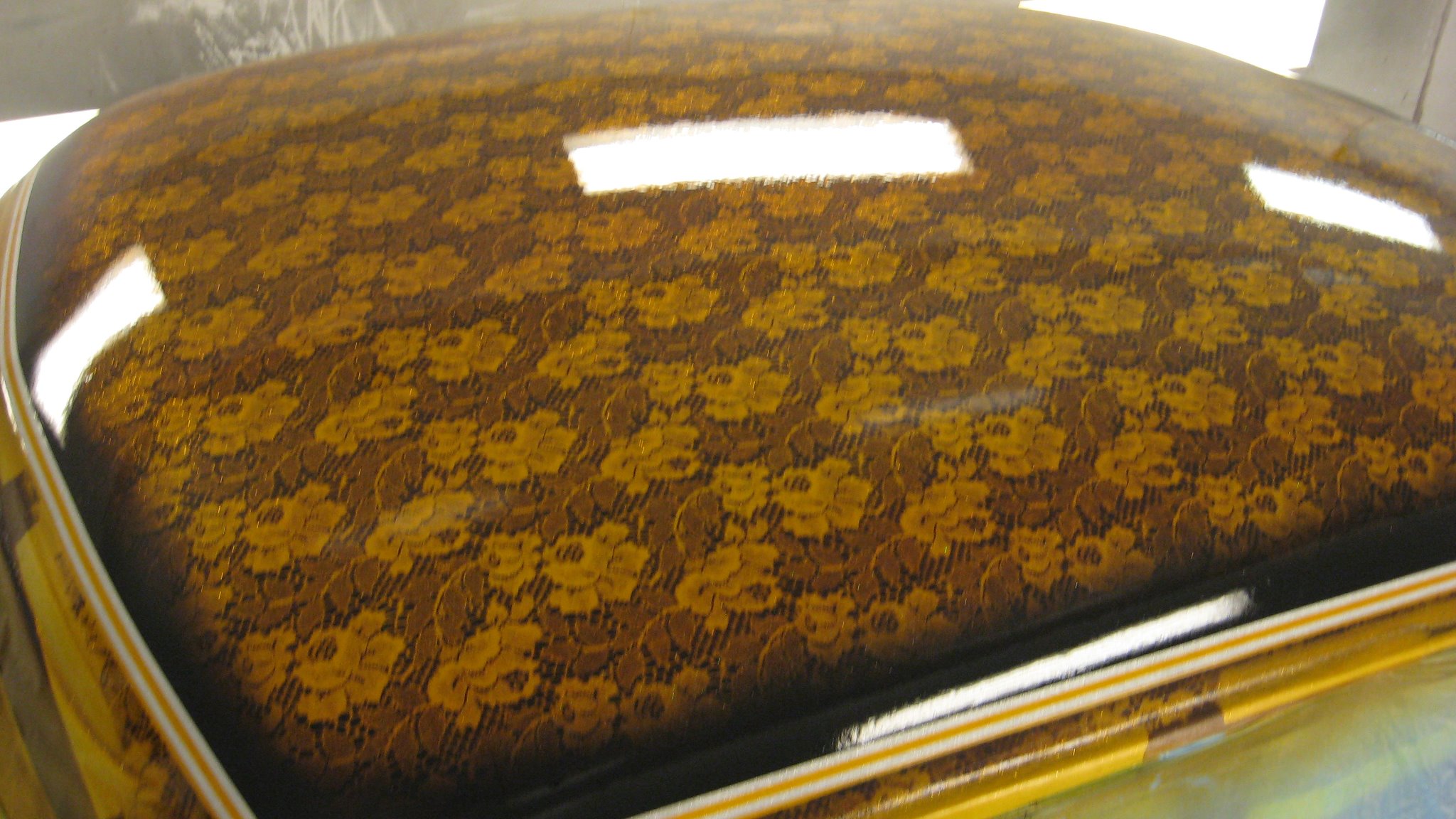

  21. trailer park playboy
    Joined: Jun 2, 2009
    Posts: 59
    from tulare ca.
    got some clear laid down

  27. thetwistedpiston
    Joined: Sep 3, 2011
    Posts: 105
    thetwistedpiston
    That's Bad Ass! Great work. I want to do lace on my dash but I can't even figure out what color goes on first.
  28. El Caballo
    Posts: 6,328
    El Caballo
    from Houston TX
    I believe that the light color went down first; if you look at the lace between the paisley bits you will see larger dark purple "squares" where the dark paint was not filtered by the lace. If I am wrong I'd like to know, but I think that is how that went down.
