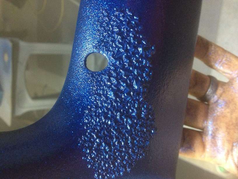

    Would you know what my problem with this window trim is? I can't say why? I have flaked a bunch of stuff but not an expert for sure. Just looking to not have it happen again. Its weird it's not all over just in certain spots. The heaterbox it more all over but trim pieces are just in spots and no reasoing where. I was thinking I didn't wait long enough for inter clear whats your thoughts? Thank you

    Here's what puzzles me. Same pieces done right next to each other. Same everything. One bubbled one nothing.

    That looks like some kind of solvent got onto or under the paint. Yes it is possible you didnt wait long enough before the intercoat. Also possible that you didnt sand enough for good adhesion or didnt wipe it off good enough after sanding the primer. It is also possible the primer had not cured enough and was extra thick on that spot but more likely is the first. Only fix is to sand it off and start over.

    that shit just happened to me on a car i just layed some flake patterns on. only one spot on da whole car it lifted up on. i blamed it on da painter only adding 2 coats of clear. did you spray the flake over a regular base or over a base that had been cleared before? if it was over a base wit no clear than im gonna agree wit delpalas statement.

    Had 3 coats of clear over the base. I think it was not enough time after clear. I'll try again this week. such is life.

    hmmm how long did the clear dry?

    About 24 hours. 5hrs in the sun.

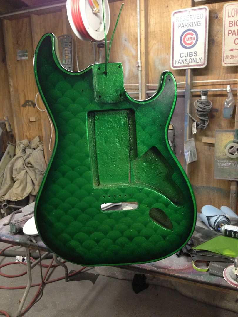

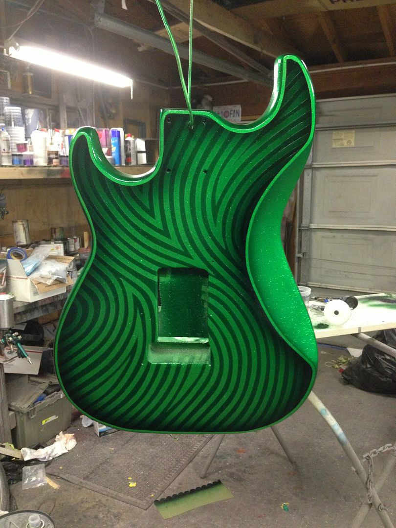

    did this guitar last night also.

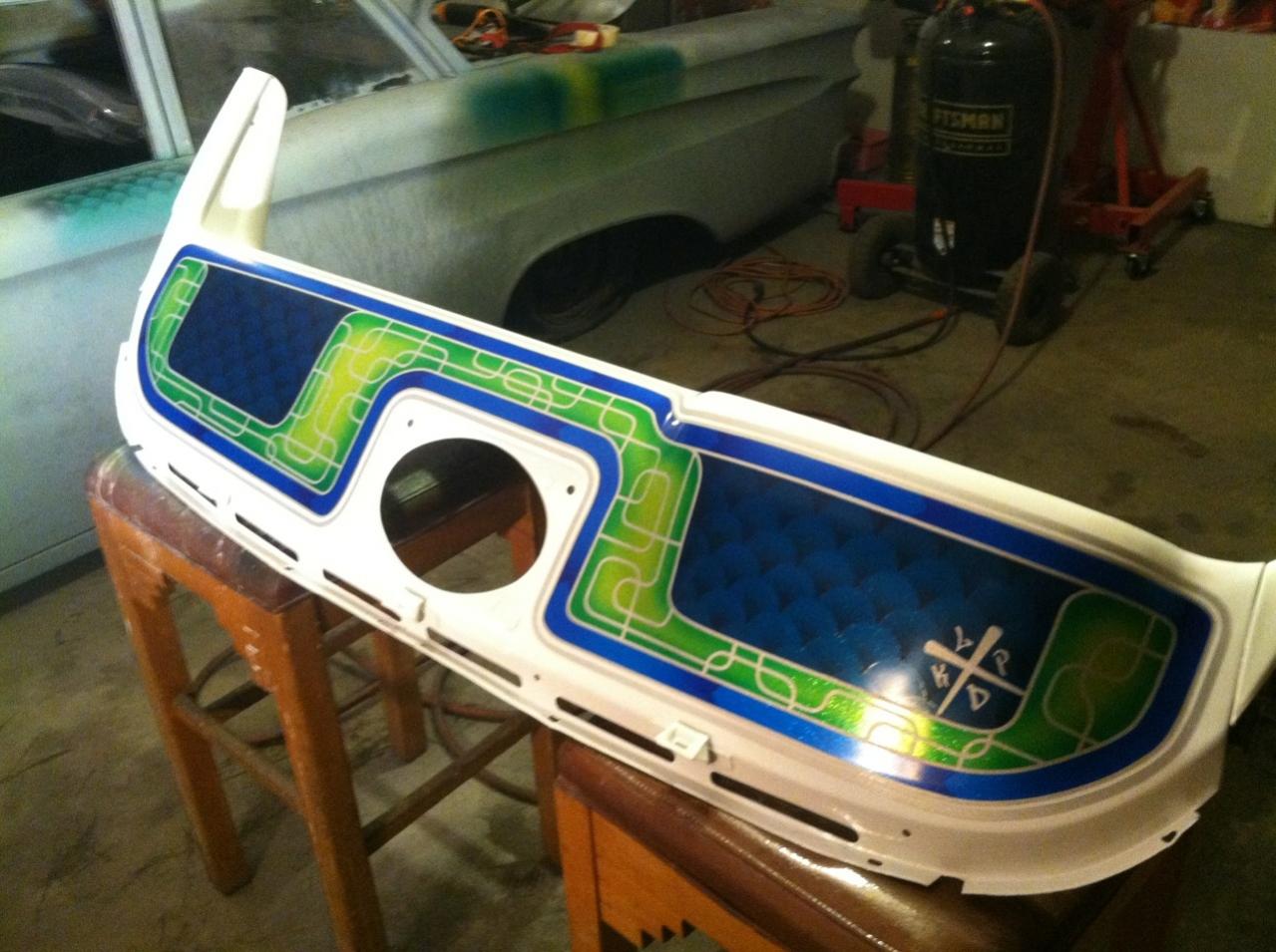

  24. The dash I did this weekend for my 59 Edsel. Still needs clear.

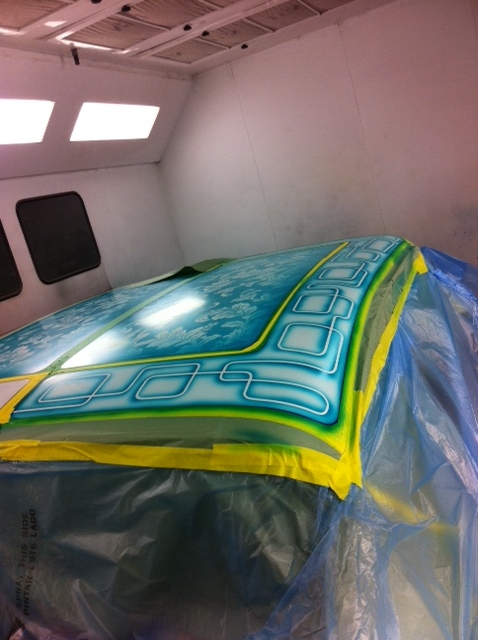

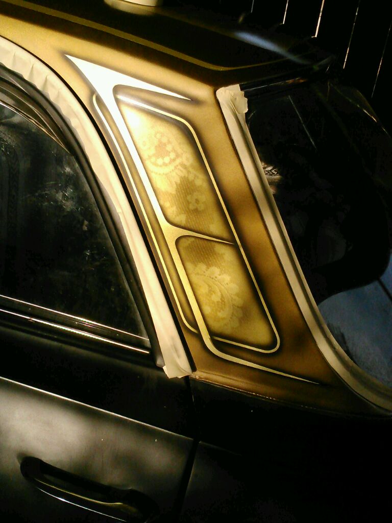

    A sneak preview of my roof in progress
