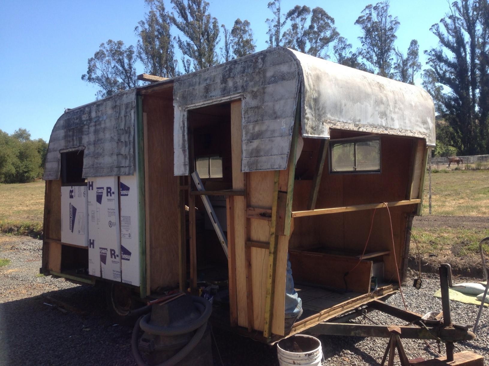

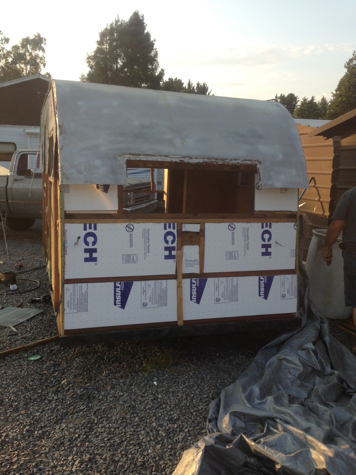

    Here is some more pics of my build, i went a little crazy fixing and improving it. haha lol But my **** will be warm in the cold and be solid !!!

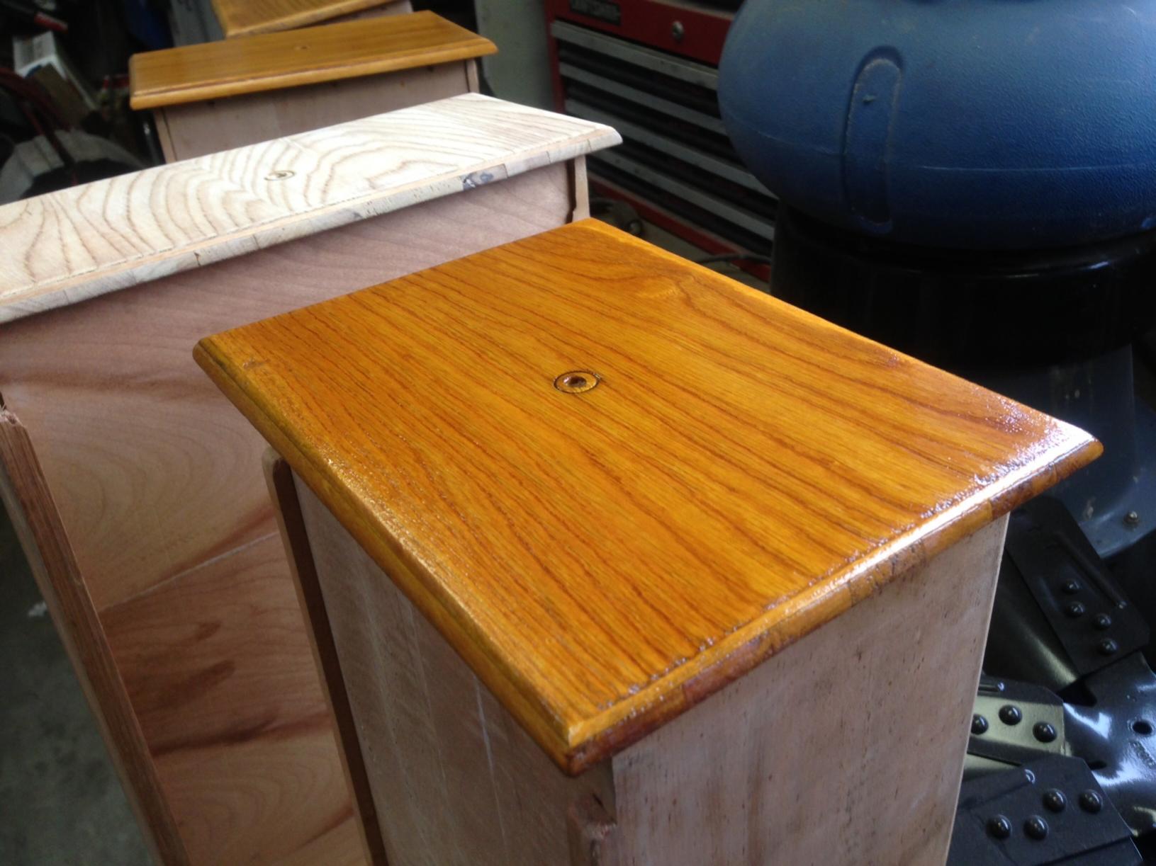

    There's a lot of cool art deco touches on this Shasta trailer . One of the coolest is this magazine rack that attaches to the wall.
    Of course it was broken sometime in the past. Its just too neat not to re-produce and use again.
    We made a bunch of faces out of oak and birch to replace the broken one and handed them to the owner so he could pick the stain color he wanted for the inside of the trailer. They chose the light brown on birch. We'll probably go ahead and finish all the racks.

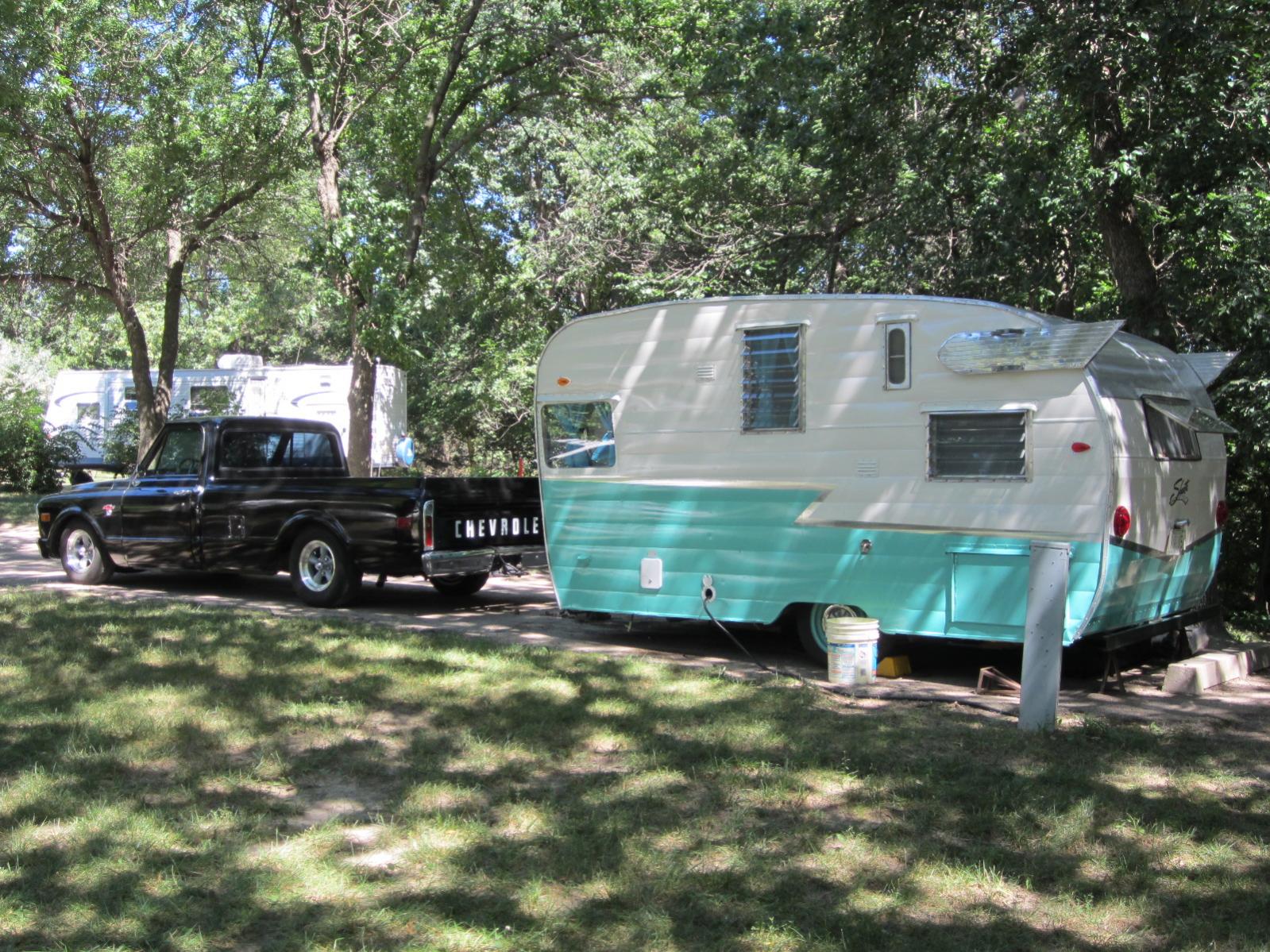

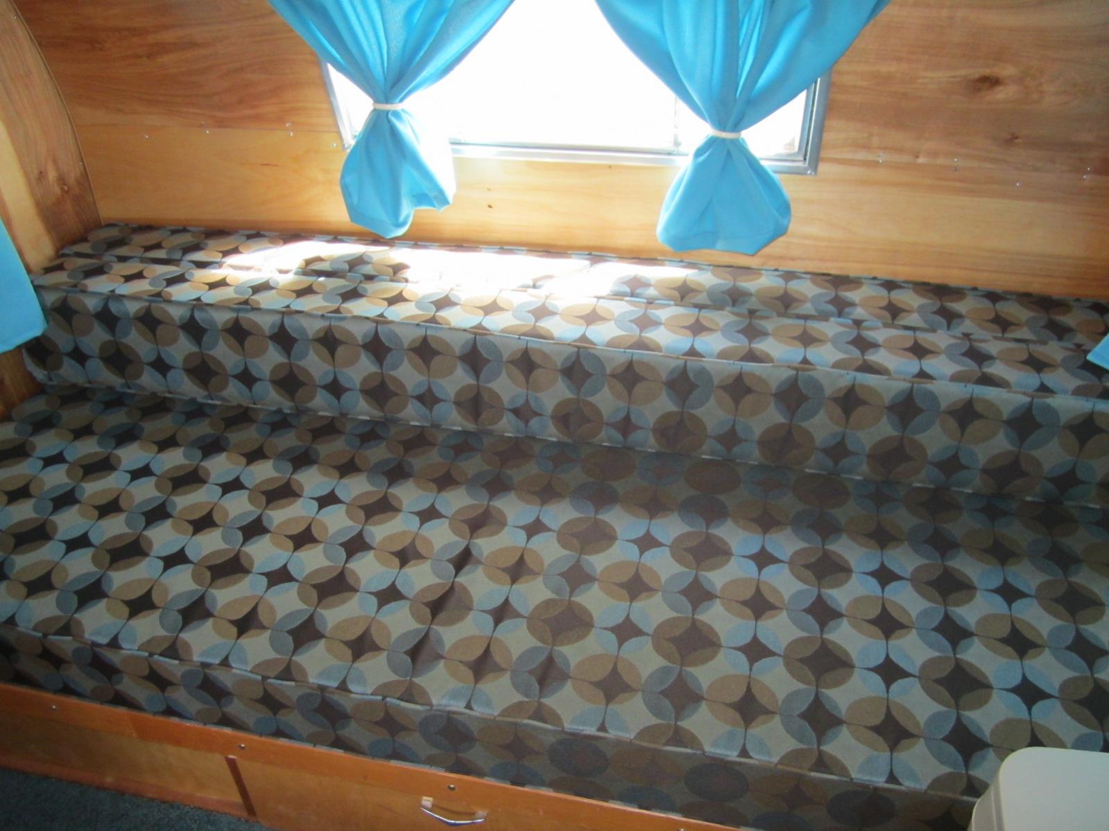

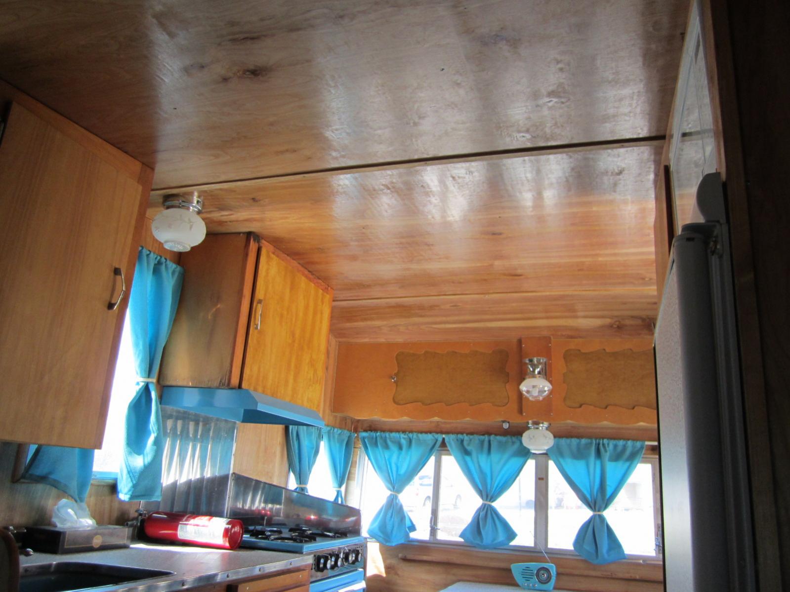

    WOW !!! This looks like a great candidate for restoration, but Im a little bias. Here's a few pics of mine. We love this thing and try to get out in it as much as possible. Gary

    I'm presuming you painted the stove/oven.... Does the paint hold up near the burners? What paint did you use?

    Yes, It was originally brown. Theres a local company here that does electrostatic painting and I took the pieces over to them for the repaint. Its amazing with no problems around the burners or oven. I wouldn't use anything else. Gary

    I'm presuming "electrostatic painting" is the same as powdercoating? Or am I way off as usual?

    Two different process's. Im pretty sure powder coating won't hold up around the burners. Red would look pretty cool. Gary
