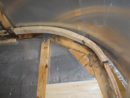

    Today we started pulling the roof panels. We knew there would be some problems here, because you could see the water damaged paneling around the rear window, and the roof near the vent had obviously gotten wet and the paneling was all deformed and droopy.
    Much to our surprise the framing in these areas was still quite nice. The paneling was all that had been affected. There were a couple other problems however.
    The factory just bored a 1/2 inch hole in the 3/4 inch framing to bring wires through. This left only a quarter inch of material on the frame member.
    We'll replace this. There was also some rot on the front and rear top bends that will have to be replaced. This will require opening up the outside aluminum to do the job correctly... That's next. This pic should be rotated 90 degrees to the left, but I'm a bit of a luddite and cant seem to figure that out.
    The droop in the ceiling was nothing more than a warped frame member. An easy replace. All in all, not as bad as we expected.

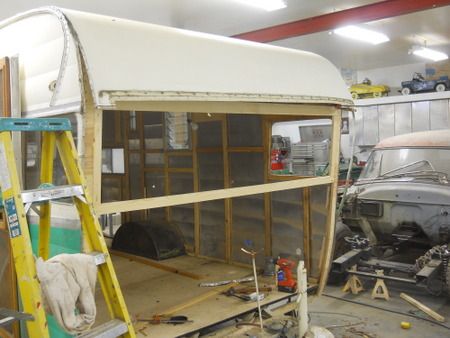

    spent some time re building the front framing.
    Having been a cabinetmaker I really learned the value of pocket screws. We've been using them to attach the braces instead of nails. They are so much stronger and less apt to loosen. Here's a close up of a pocket screw attachment.
    I replaced the rotted window frame as one unit and it really made a solid replacement.
    Here's a quick shot of all the rebuilt framing across the front. Probably after our next two work sessions all the framing will be done and we can begin paneling the inside of the trailer.. Looking forward to that!

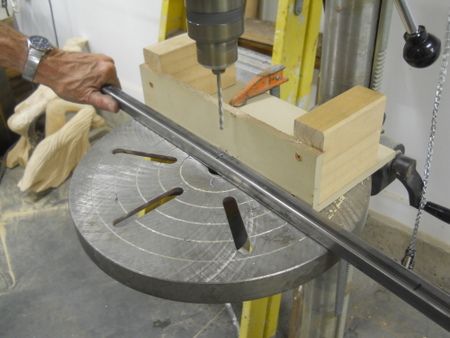

    The roof bracing was a real problem. The framing slats are 3/4 x 1 3/4. spanning about 7 feet. The roof was all saggy because the slats had warped. We decided to strengthen them with a steel rib at every slat . We would put a slight bow in the steel ribs, so that water could never pool on the roof. First we cut some 3/4 x 3/4 steel tube to the correct length.
    Then with our trusty home made roller we rolled a 1 1/2 inch bow into each of the six
    ribs.I know this looks like the hokiest tool ever, but it is a VERY valuable shop tool. We use it pretty often, and its helped us out in TONS of situations.
    Each rib was then drilled every 10 inches so it could be screwed to the wooden slat.

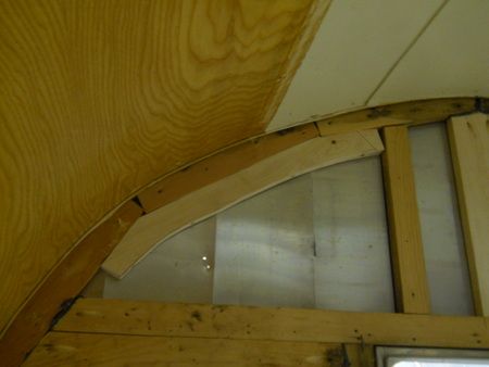

    We screwed the 3/4 x 3/4 square tube to each of the roof crossmembers. It worked great! Now there are no warped supports below the roof, AND there is a slight crown to the roof braces to ***ure that water will never pool on the roof.
    We also took time to epoxy curved wooden braces to the front and rear of the rounded ends of the trailer. All the structural work is now done and we can begin paneling the inside walls and ceilings.... Stay tuned!

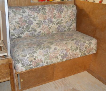

    With many thanks to Hot Rod Roadster here on the hamb, We figured out the front seats and their fitment. Here's a photo of one side of that area. The cushions still need to be re-upholstered, but everything fit just as it should.
