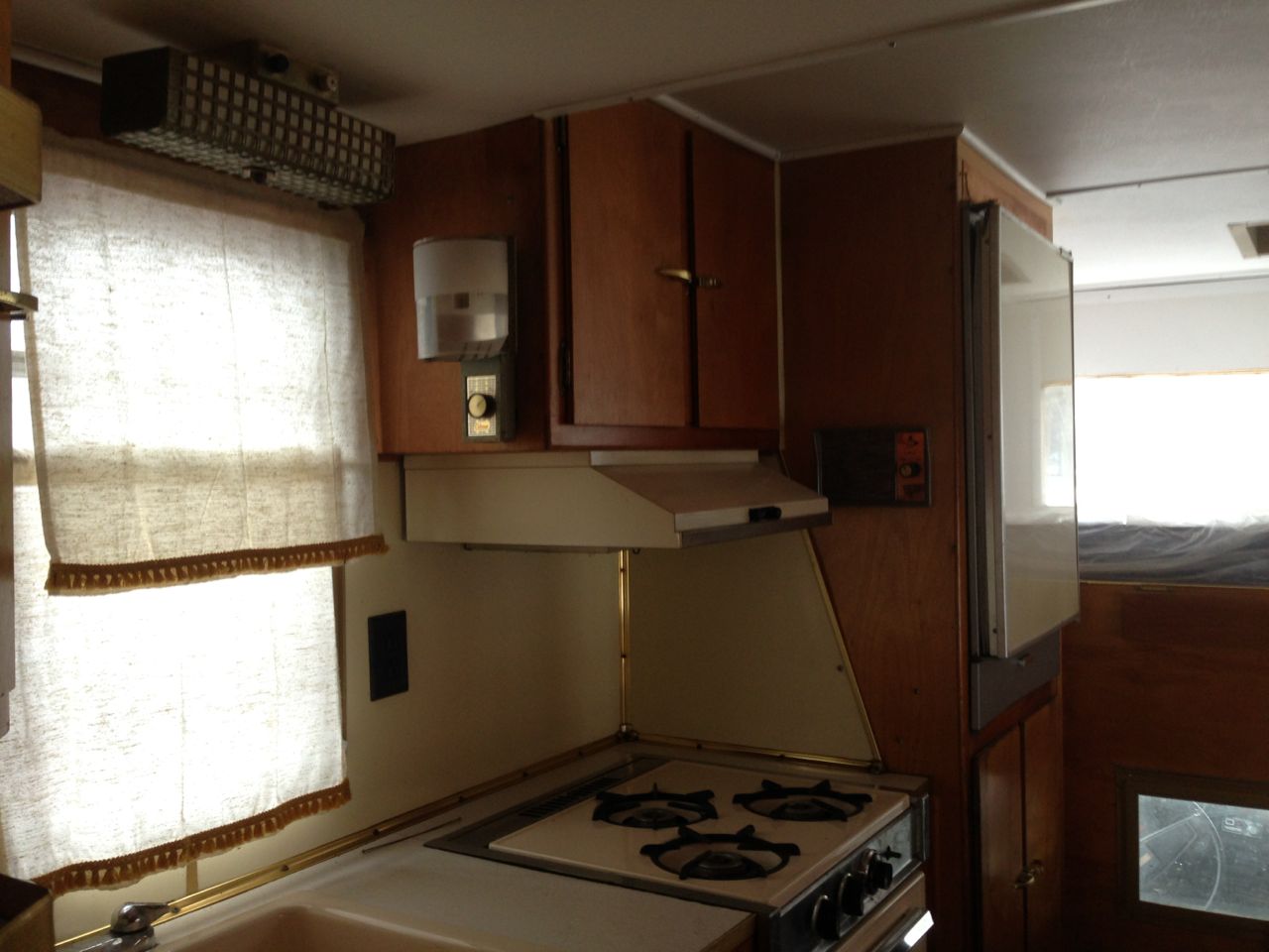

    Chaz, No, it's easy, just lube the track and the welt up with silicone and they slide right in.
    You're doing a great job with this trailer! Looks like it's gonna be a nice rig. I spent some time this afternoon finishing up the inter trim in my Del-Ray truck camper. It's looking pretty good for an old dog, next up, get the roof sealed, 'cause I had to get it out of the shop when the roof caved in a month ago! I don't know what we're gonna do with it, other than maybe go to the local cruise night. It may be big, but it sure is ugly…
    Brian
    QUOTE=Chaz;9599369]Hey, Flynbrian48! We were discussing how hard it must be to thread the awning through that extruded piece of aluminum on the trailer. Yours is the first I've seen that actually accomplished it. Is it a real PITA?[/QUOTE]
