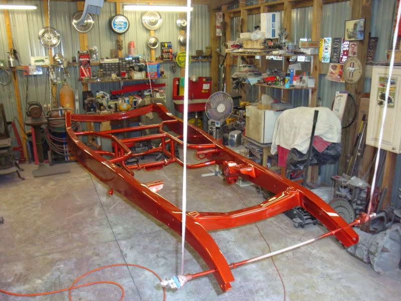

    More paint shot today.
    [​IMG][​IMG]

    Even more inspiratonal, the shop is actually clean.
  3. PoPo
    Joined: Jan 3, 2008
    Posts: 1,102
    PoPo
    is it me or do you not mask anything and just throw overspray EVERYWHERE... how do you keep it so clean in there cause i don't see the overspray on the ground. hey houdini do tell!!
    im still loving this build also!!
  4. Hot Turkey
    Joined: Feb 21, 2007
    Posts: 1,239
    Hot Turkey
    I try to clean the shop twice a week, sweep and shop vac. There is overspray every where. I dont care and it's not finished yet anyway. The other side will someday be a downdraft booth. It's all plumbed up and just needs to get finished. I started building cars in the garage in the house but made everyone in the house sick after spraying paint. It took me many years of work to build my shop all by my self but now I can paint again. Oh ya, worked my *** off on it today. Getting ready to spray the frame! Can't wait.....

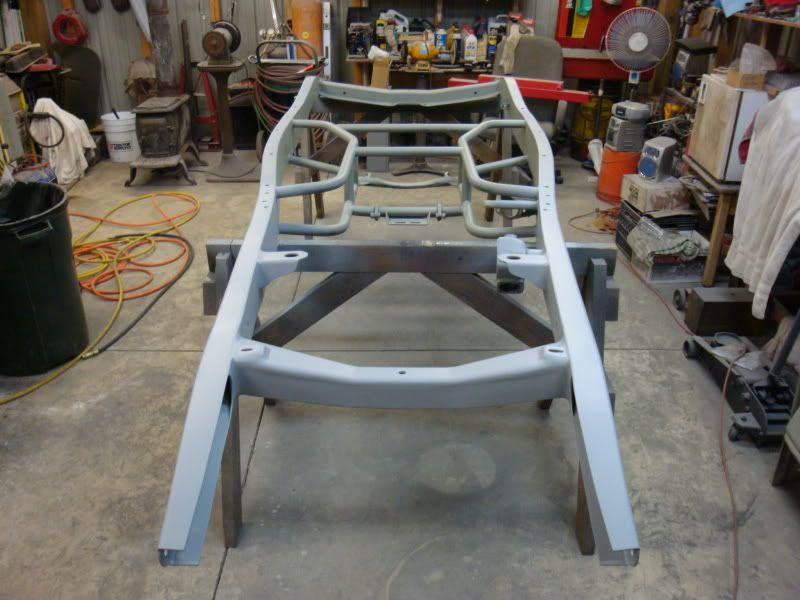

    Got the frame primed! Well, the top of it.

    Flipped the frame over and primed it.

    Wet sanded all day, guna flip the frame over in the morning and finish sanding. Then a coat of sealer before paint.

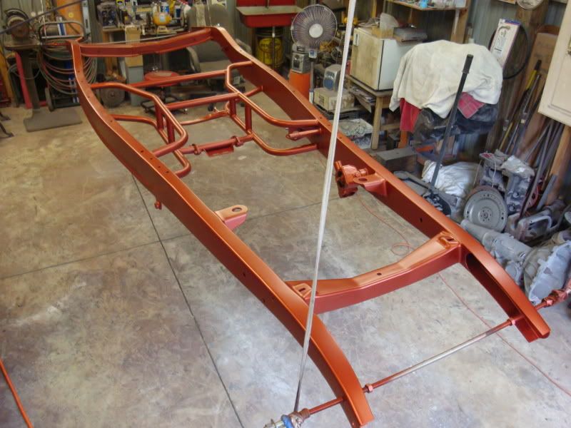

    After spraying dark gray sealer we shot some color!
    My buddy Don shot the large spots with the big gun and I hit all the tight spots with a small gun.
    The clear was messy stuff! It was very hard to hit all the small tight spots without running. I'm still sticky.
    Now I'm going to let it sit over the weekend and dry. I'm going to sleep for 12 hours now!

    Awesome build, superb detailing and workmanship. Only 2 things catch my eye, but who cares, it isn't me right? But here goes;
    1. That v-notch taken out of the bone and rewelded.....how strong/safe is that? Will it withstand the tension/compression/lateral forces placed on it?
    2. The color. That copperish hue screams 2009. For such a traditional type build, I expected a much more 'traditional' color. But color is so personal, whatever floats your boat.
    Again, don't take this the wrong way, I wish I had 1/10th the skill you have! Lovin this thread, can't wait for the next episode! :)
  17. Hot Turkey
    Posts: 1,239
    Hot Turkey
    I take my welding very seriously, from the bone you spoke of the the pitman arm I cut up into three pieces and welded back together. My life and those around me are at stake. I know this and believe me, the welds will hold. You asked a good question "how strong/safe is that?" This car will be as strong as I can make it, but it will never be safe. It's a hot rod, not a Volvo. I dig the color. Color is a very personal deal, I just don't like black or red. I drove to every car lot in town and looked at all the colors in the sun shine. I don't like Mitsubishi, but that 2009 rotor glow kicks ***! Sorry, I know it's not traditional. Thank you Antny for your questions and no, I didn't take it the wrong way. Thanks.

    Exactly. That's why I asked. I had a friend do something similar, welded it up good then ground the weld to make it purdy. I'll make the story short; he only lost an arm in the accident. It coulda been way worse.
    Totally agree on the color being a personal thing. No need to apologize, if you dig it, that's ALL that matters.
