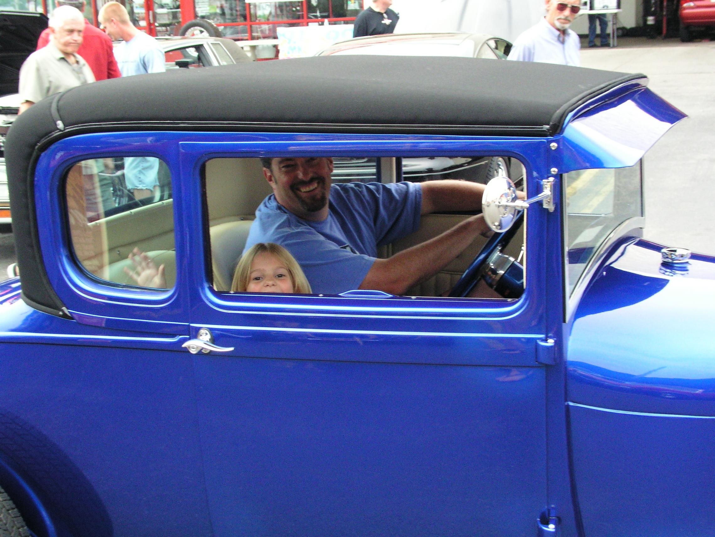

    Whew, that explains it. I thought you were some madman, getting all that work done in such a short time!
    I am really enjoying your thread. When you are done you can get some shots like these :)
    my girls did not help me with the build, but they do enjoy riding in it.

    I can't wait to take my little girl for a ride! Page 26 on this thread is January of this year, every thing before that is from the past years. I was slow at first because I was still hunting parts and there's no way I could put that much money into it all at once.You know when you hear people say, People just don't understand how much time, money and energy goes into building a car. I understand now..........
