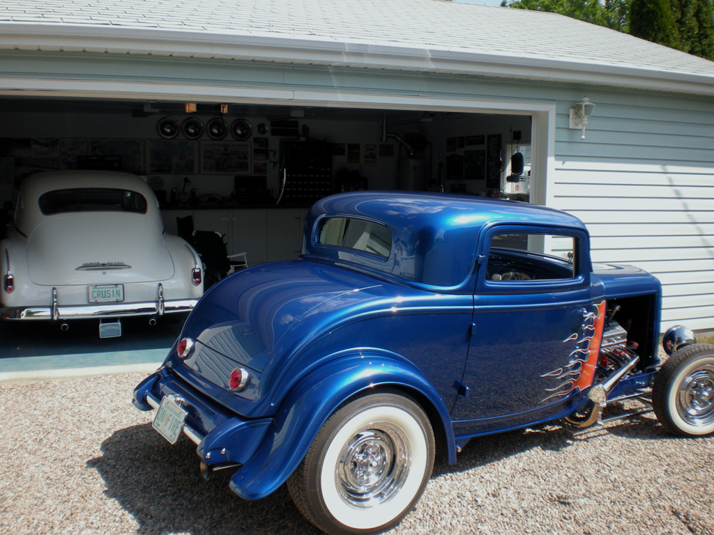

  25. rodderbilly
    Joined: Nov 19, 2005
    Posts: 451
    rodderbilly
    from italy
    cool your project,,i'm for the steel body but the 3w is another planet and not for all,,i go for a 32 3w i will go for the same choice,,have fun!

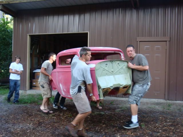

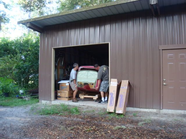

  26. Hot Turkey
    Joined: Feb 21, 2007
    Posts: 1,239
    Hot Turkey
    Called up some of my buddies today and got the body on the frame. That damn body gets heavier each time we move it! Full of wood now. I'm sure glad to have such great friends tIhat will stop what they are doing and help me out.
