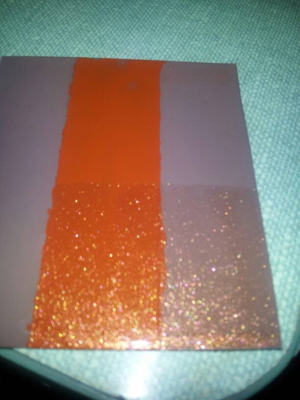

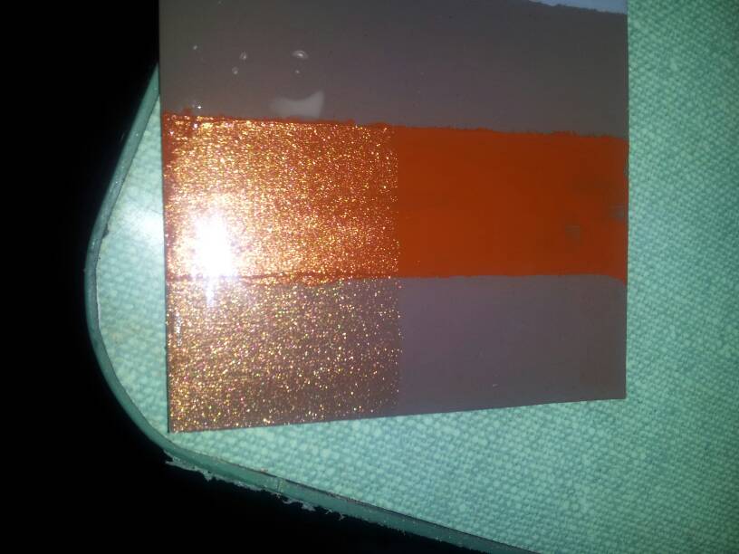

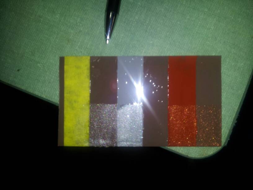

    Ok I did true red oxide pigment next to industrial red oxide and the orange pearl on top. I have to say I really like the red oxide pigment with orange pearl on top.
    Next to that is the gray primer and industrial red oxide with a crystal pearl on top. Notice the face and flop!
