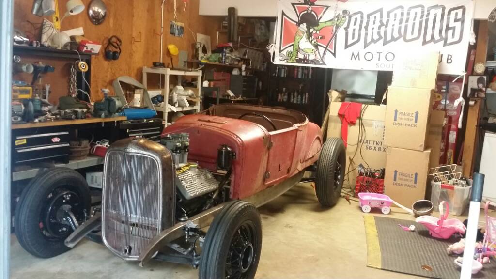

Projects Can't believe how lucky I got ........... 23 T or 27 RPU

    Sooooo, after more consideration seems like the best course is to build the T Bucket into a runner with the parts I wont be needing for the RPU and swap out the stuff I will need for the RPU.
    I see that some suggest that disc brakes and an IRS are not appropriate for the RPU, I also see where the subject has been well discussed in other posts, and I have seem many really great looking rides utilizing the same basic parts to include some really high dollar stuff from some pretty well known builders, think I'll stick by my guns on that one.
    I admit this type of build is new to me and I know little to nothing about the specifics of the differences between T's and A's and the associated parts. That is why I am here. To learn how to build a safe and practical ride that I can take pride in and enjoy with my SO.
    I do pretty well at repairing / rebuilding most things and can handle some modifications that require welding but lack the Fab skills that many of you seem to excel at so I will be looking for systems and setups that work within the realm of the average builder.
    Since my pockets have more dust than cash I will have to use what I have or what I can put together as funding comes around. First step, build and sell the Bucket to finance the RPU and keep looking for the correct parts. Sure hope I can count on the HAMB to guide me as I move along.
    Give your opinions please:

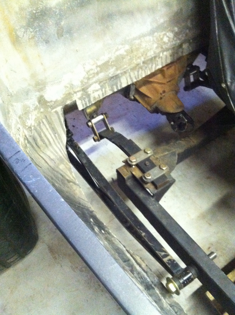

    2. The Bucket came to me setup with a quarter elliptical spring setup in the rear. I have never seen one setup that way. Is it safe? Should Do I go with a more conventional setup?

    I would run the bucket with the 1/4 elliptic springs and what ever it's set up for in the front should be fine.

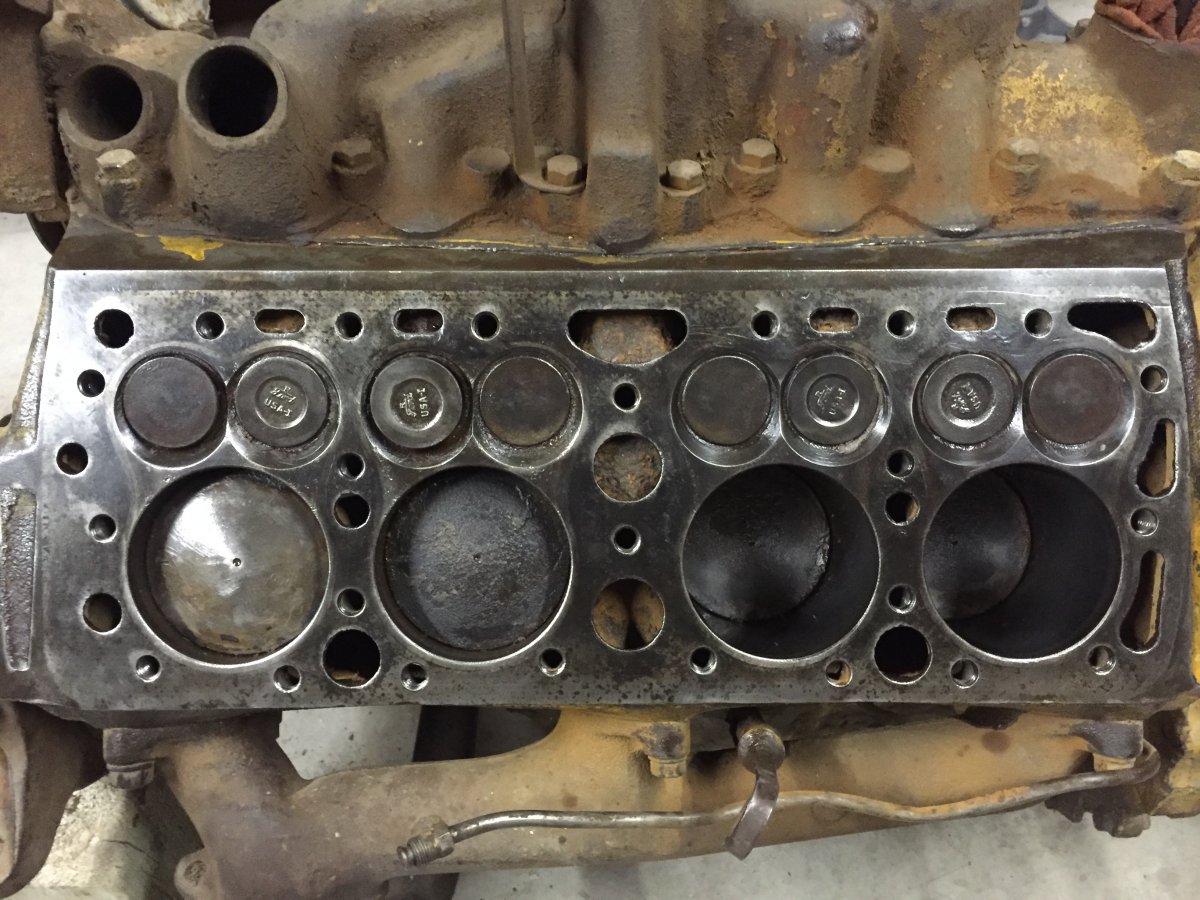

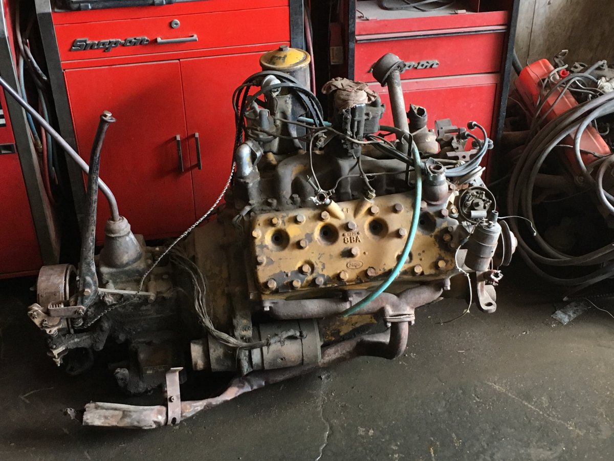

    Well it's been a long time since my last post here and it's time get back moving on this project. I decided to go with a more traditional build and finally located a motor to build up, my first flathead. Local long time mechanic had one stored for 10 years or so that he had purchased as a runner with intent to retrofit into an old ford tractor.
    Here's the first I saw of it.
    Talked the PO into opening it up for a visual inspection and with the exception of two head bolts that snapped during disassembly, didn't see anything suspect and was pleasantly surprised at the condition of what we believe to be a 49. Couple hundred $ for what you see plus 2 new/rebuilt water pumps. Got it home and started the cleanup in earnest. Couple hours with a gasket scraper, razor blades, wire brush and wipe down with oil this is what I got.
    No visible crack anywhere and all but one cylinder look really good. The engine had been stored in the shop for all these years but the plugs were removed at some point and managed to get moisture in it. Most cylinders have a little discoloration and the number 6 cylinder has just a bit of surface rust at the top. Here's what it looks like. IMG_0720.JPG
    Yes, there is a bit of carbon on the pistons and valve faces, but much better than I expected. The valves cleaned up real nice and the 2 pistons I started to clean up look real good as well. Found the whole assembly turns over quite nicely and the valve train operating as it should. I'm thinking a light honing to clean it up and good to go.
    Since this all looked good I also pulled the intake and was pleasantly surprised to find this.
    Amazingly clean for a 60+ year old engine. No sludge or debris at all (except gasket remnants I got there). This thing is leading me to believe that a good cleanup, light honing, reseal (gaskets, etc) and reassembly might be all that's required, and budget begs for this to be true.
    Yes, I know that would be a bit of a crapshoot and that only a thorough hot tanking followed by magna flux and pressure tests could declare it road worthy, but the budget...........
    Tomorrow will see the trans come off, and the flattie mounted to a stand so I can get the oil pan off and check the bottom end.
    Interested to hear your advice .........
