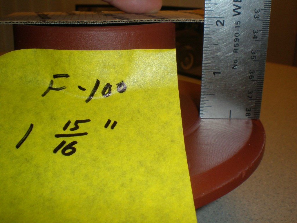

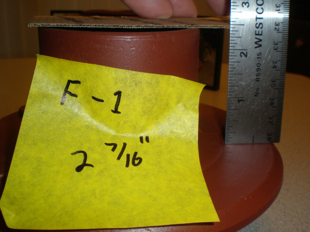

    Here is info on the F series brakes; hopefully it will be helpful.
    Wheel cylinders WC9090 & WC9091
    Adjuster H1500
    *Retract springs NAPA UP80304
    *Adjuster springs NAPA UP80503
    *Hold downs H4020HD
    *(I listed separate parts because if you order a hardware kit, it will not have enough or the right kind of springs as the current kits are set-up for self-adjusting brakes).
    Link pins H1414-2
    Shoe retainer Help 13896
    These parts fit both '48-'52 F-1 & '53-'56 F-100 backing plates (which are exactly the same).
    If you have F-1 hubs ask for '80 Bronco REAR drums (don't tell the counterperson what or why; that will just confuse the issue). Best deal is usually Raybestos 2677R drums from RockAuto.
    If you have F-100 hubs ask for '53-'62 F-100 front drums nothing confusing. Same deal Raybestos 2600R drums.
    If you don't know what you have measure from the back of the flange to big end.
    There can be a small variation as there were several versions of the hubs.
