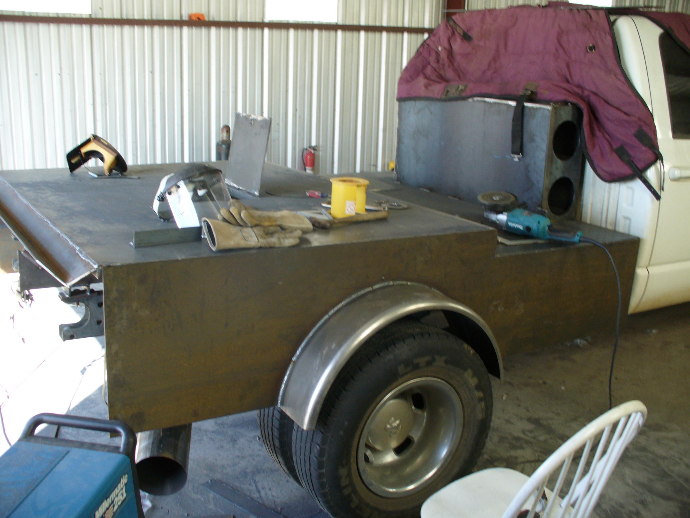

    For people that are having a hard time seeing the puddle, I recommend a Pancake hood. I have been using them for a while and while they are funny looking, I will never use a standard hood again. They have a Balsa wood eye box that you sand down until it fits your face perfectly, therefore ZERO outside light is seen while welding. Of course it will only fit one person but that is the whole idea. Being as no outside light is seen you are able to use a darker shade lens for more eye protection but the puddle is very easily seen. I use a shade 11 auto-darkening lens in mine. But standard lenses work well too. They are the hood of choice in the Pipeline industry. I'll see if I can find a pic of mine. Google "Sarge's Pancake Hoods" or "Wendy's Pancake Hoods".
    You can see the hood on the rear of the bed I'm building below, notice the wood eyebox, And for a right handed welder they have a side shield that covers you left ear. As I said...funny looking, but nothing makes it easier to see the puddle than a Pancake hood.
