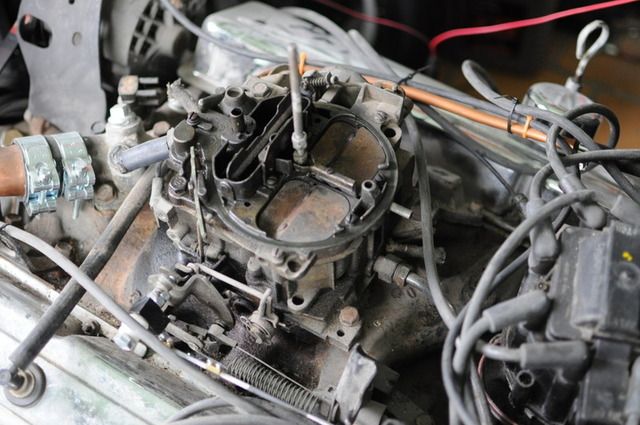

    An old Quadrajet might be better, or a different 4bbl carb. I though the 86 caprice had a computer controlled carb? with some wires going into it. But since you are in Belgium, things might be different?
    If you could post a photograph of your carb, we might be able to help you figure out what it is that is leaking, and how you could fix it, or suggest a better carb for you

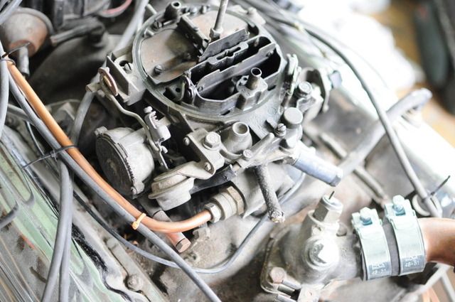

    Hi,
    there's no computer involved;
    here some shots from different angles,
    the leak is on top at the front, and also a little lower than "on top"; the joint is tight.
    M.

    First thing to do would be to overhaul the carb. Get a "carb kit" (repair kit with the gaskets), and a new float, and a spray can or two of carburetor cleaner.
    You might be able to find some small rubber or plastic caps to put over the fittings you are not using. At least it would look better.
    The intake manifold you have is a "spread bore" design, so most of the normal hot rod carburetors like the Holley and Edelbrock will not fit without an adapter.
    If you want to spend some serious money, you could buy a different intake manifold and a new carburetor. That would be the best thing to do. But if it were my car, I would work on the carb you have to fix it.

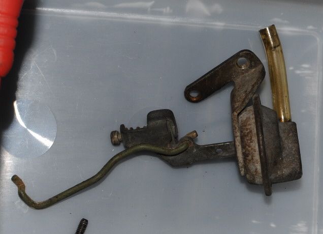

  5. Float level is too high or the float is saturated and is no good.
    Fuel is not supposed to be that high in bowl.
    If it's sloshing out during use, you need a new top gasket, minimum

    Hmmm.....i noticed you do have vacuum advance on the distributor as well as no wires running off the car, so no computer. Did you import this 86 caprice from somewhere else or was it originally sold in Belgium?
    Trying to rebuild the carb is a possibility---i'm sure you can get a rebuild kit shipped to you.
    OR i think jegs or summit can ship you a professionally rebuilt quadrajet from SMI.
    The other possibilities are new carbs----the holley 4175 is a direct replacement. Everyone feel free to chime in on your thoughts on this carb. i don't have anyexperience with it, although it looks to be good.

    the leak is here,
    float level indeed seems to be too high;
    And the vacuum advance on the distributer ... :confused: needs some leads, or a comp ..?

  13. the above advice on lowering the float level is dead on.

    you need a top gasket and a new accelerator pump.Thanks for the last picture.You can leave the carb on and just take off the top and replace these parts......

  19. I am with the squirrel on this one. You can repair the carb or as he suggested go with an older quadrajet.
    That is a smog engine. It has an EGR valve. See arrow in picture. it can be blocked, just remove the valve and make a little plate to cover the hole.
    You can also make it a little snappier by getting an advace curve kit for the distributer, there are better distributers but if you must work with what you got the advance curve kit will help a bit. Maybe this is a future modification.

    The choke requires a "hot air" tube from the intake manifold to the choke housing. The lower end of the tube is shown here:
    the upper end connects to the place where there's a bolt stuck in a short rubber hose on the housing on your carburetor.
    Also there is a thermal spring in the choke housing, attached to the round plastic piece. You can adjust how much for the spring exerts by loosening the 3 screws and rotating the plastic piece. It should just close the choke plate when the engine is cold, and should open by itself as the engine warms. It is a complicated mechanism, and takes some work to get it adjusted properly.
