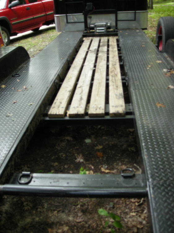

    Mine is steel diamond plate runners with open center. I've had the trailer since 92 and I planked the center a long time ago. I think it's on the third set of planks. I've never had a problem with the diamond plate buckling and my trailer sits outside year round. I also like the steel rather than wood because things that will catch in the wood slide on the metal. Here's a pic of just one of my parts trip loads. There's also a motorcyle crossways on the front. I have had as many as 3 cabs and a T sedan on it. They slide a lot better on a metal deck than they ever would on a wood deck.
