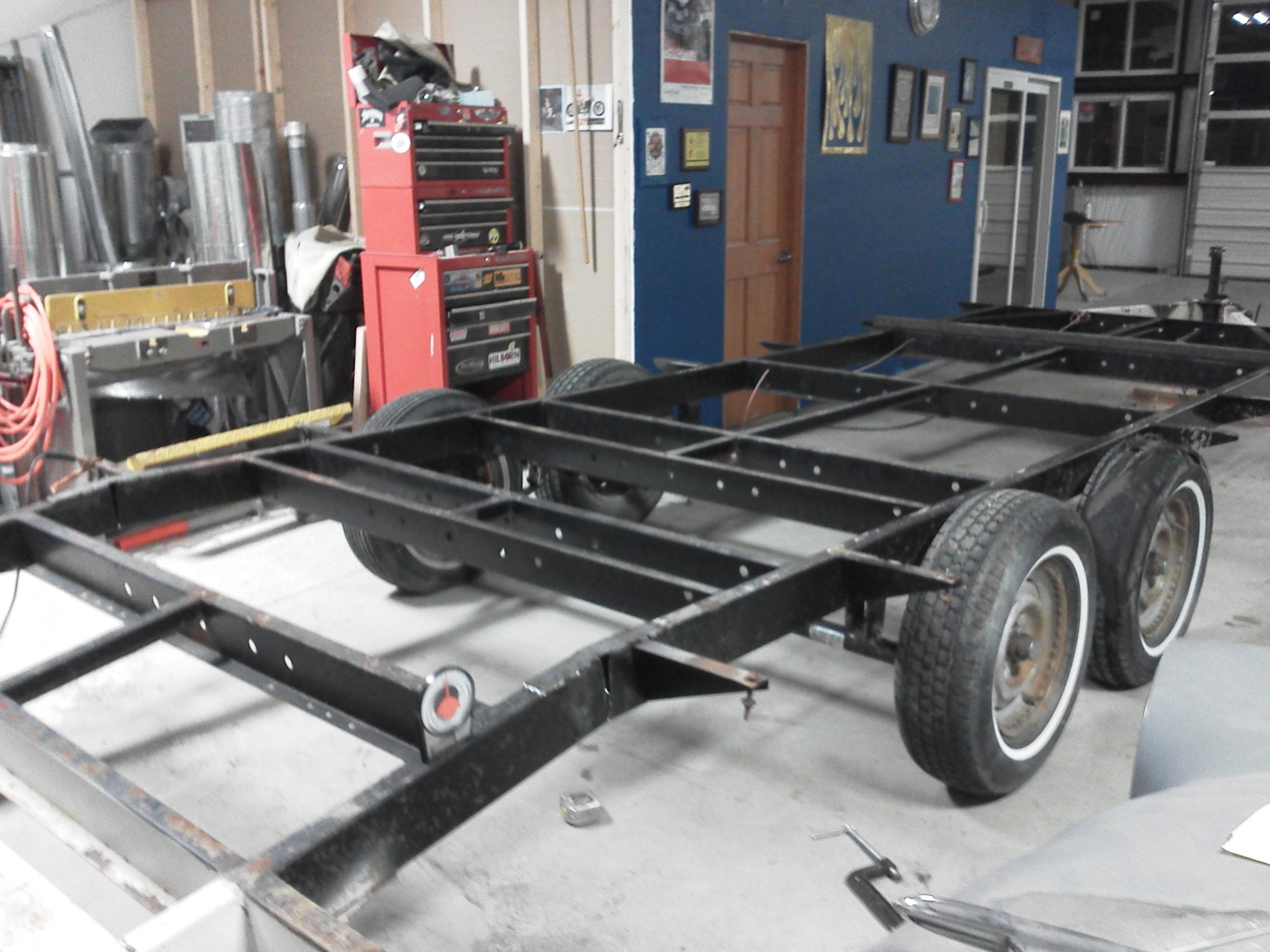

    I know it aint a car but Its a pretty nice trailer I think, maybe some of you will appreciate it.
    I'll make it short and sweet.
    I spotted a camper trailer frame sitting in a driveway here in New Mexico. It had been there for quite a while. I poulled in and asked him if he'd be interested in letting it go, I pulled out with it for $400.

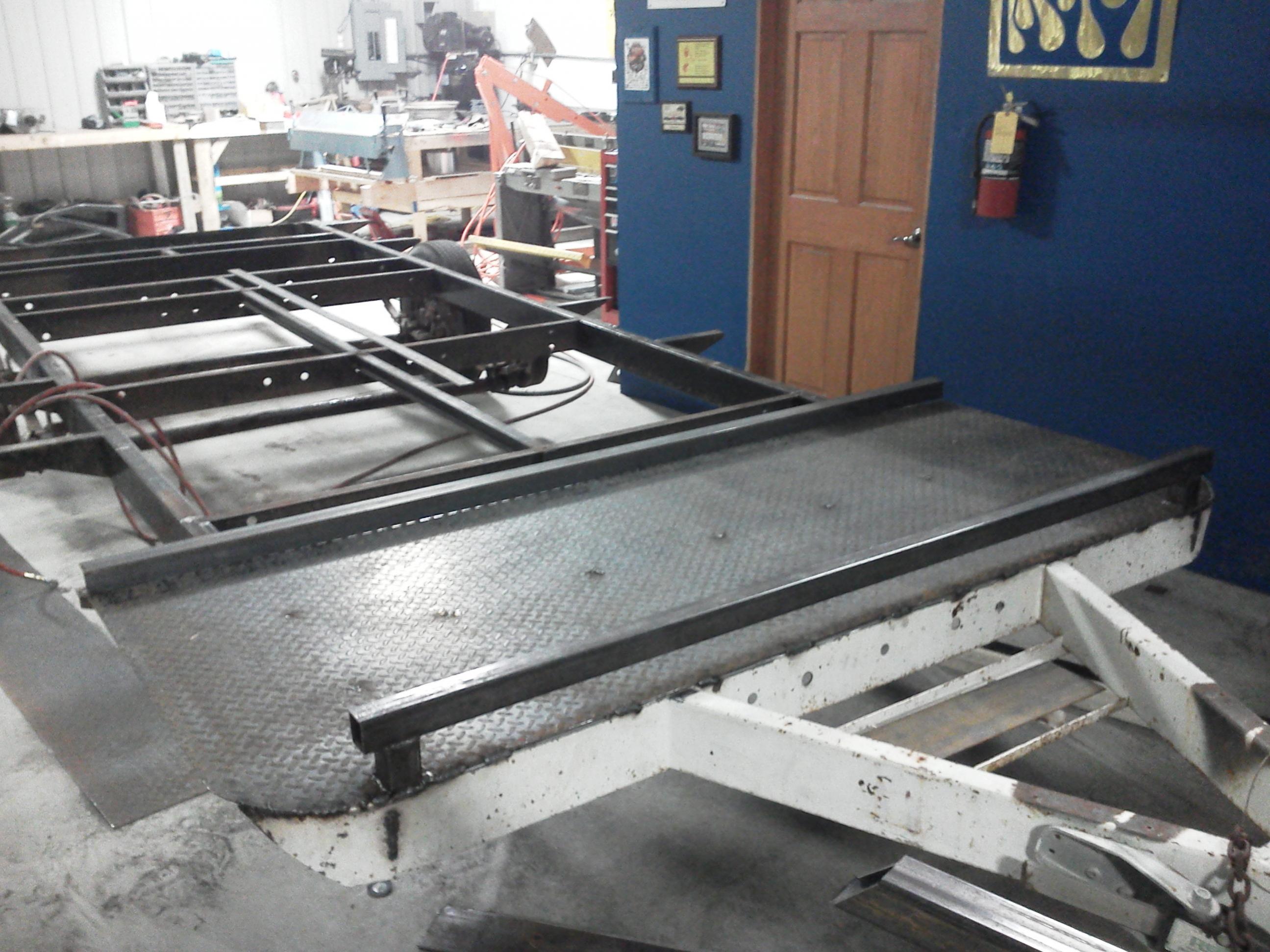

    I took it back to the shop and first thing I did was flip the axles, I want to be able to retrieve a really low car but I need to be able to get up and down driveways and dirt roads. This is a vintage tin recovery trailer. Also I'll be able to haul stuff for you guys around the southwest.
    I did a 30 inch dovetail in the back, braced the heck out of the kinda weak trailer frame, put a sheet of 14 gauge diamond plate in the front for a good area for tool boxes, tires, air tank etc.

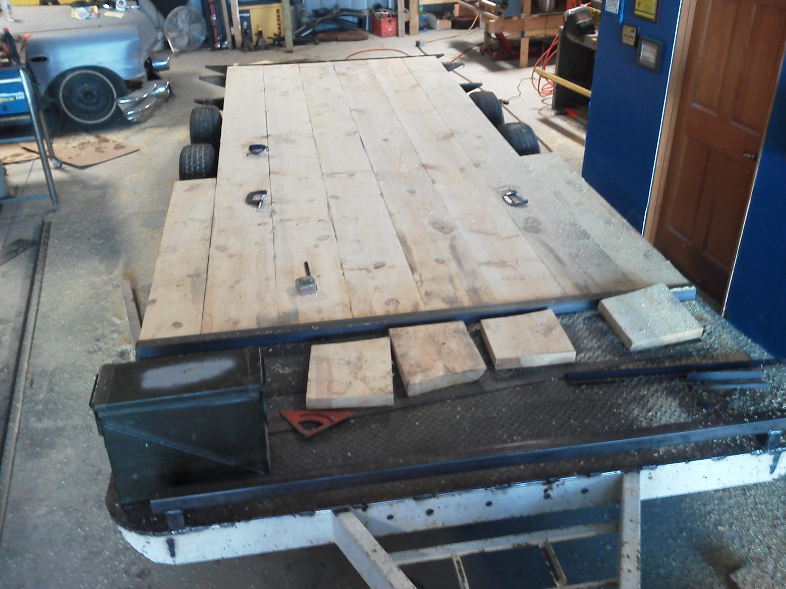

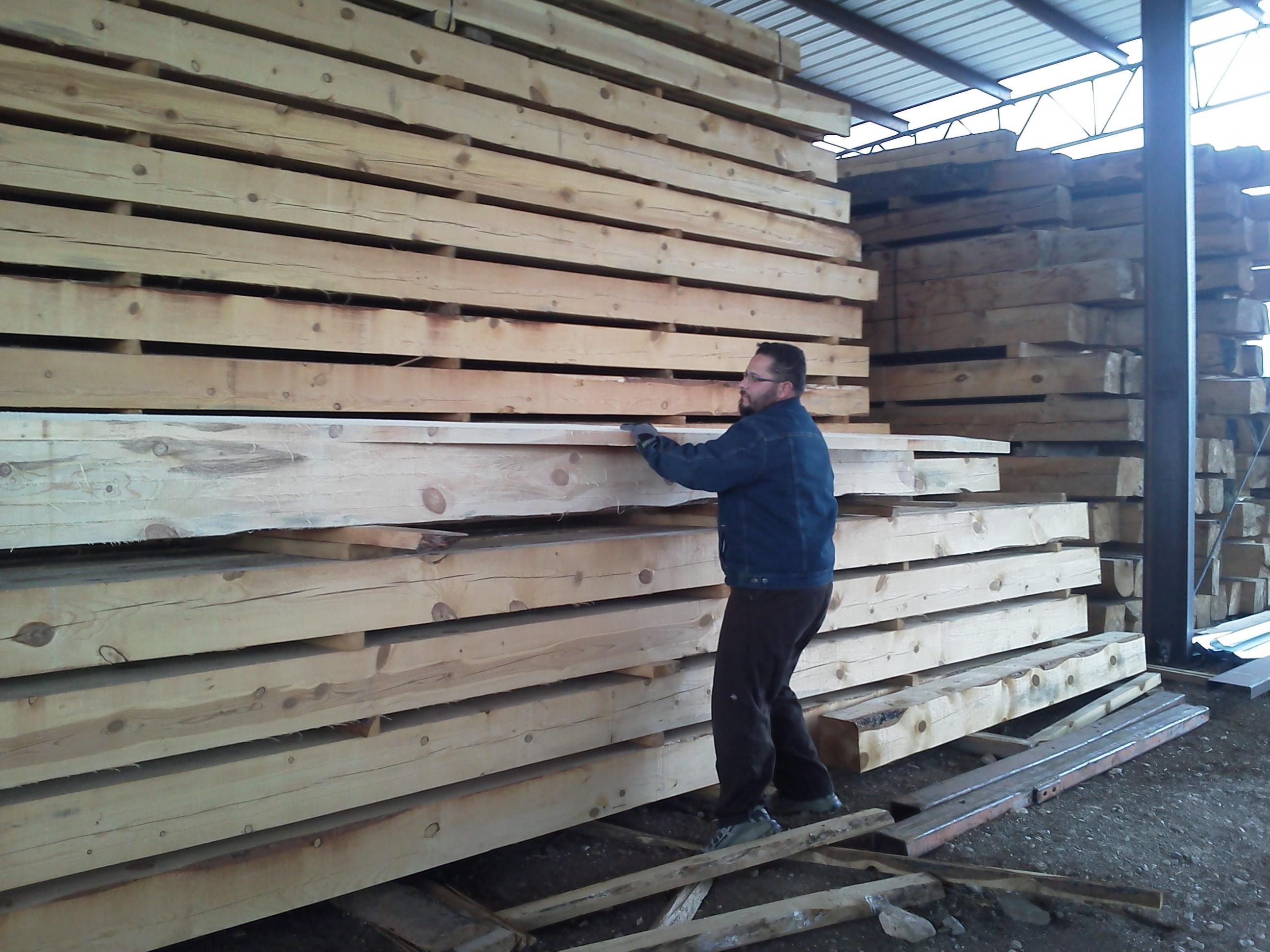

    Then I decided to get some rough cut lumber straight from the lumber mill. That was a cool field trip, all the true dimensional 2x12s were cut from one tree. HEAVY and wet.
    I hauled themn back to the shop and did my precision trimming with a chainsaw.

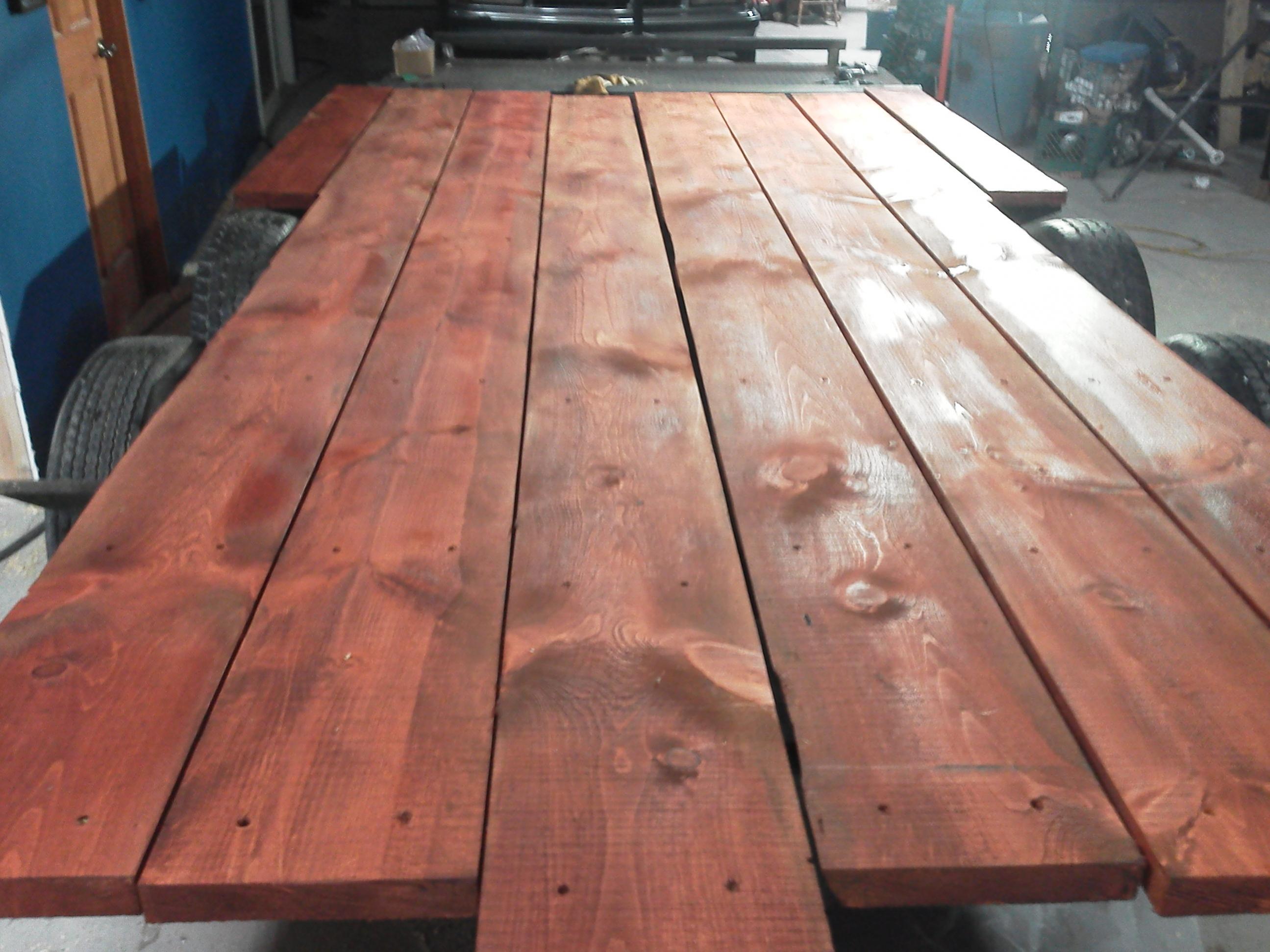

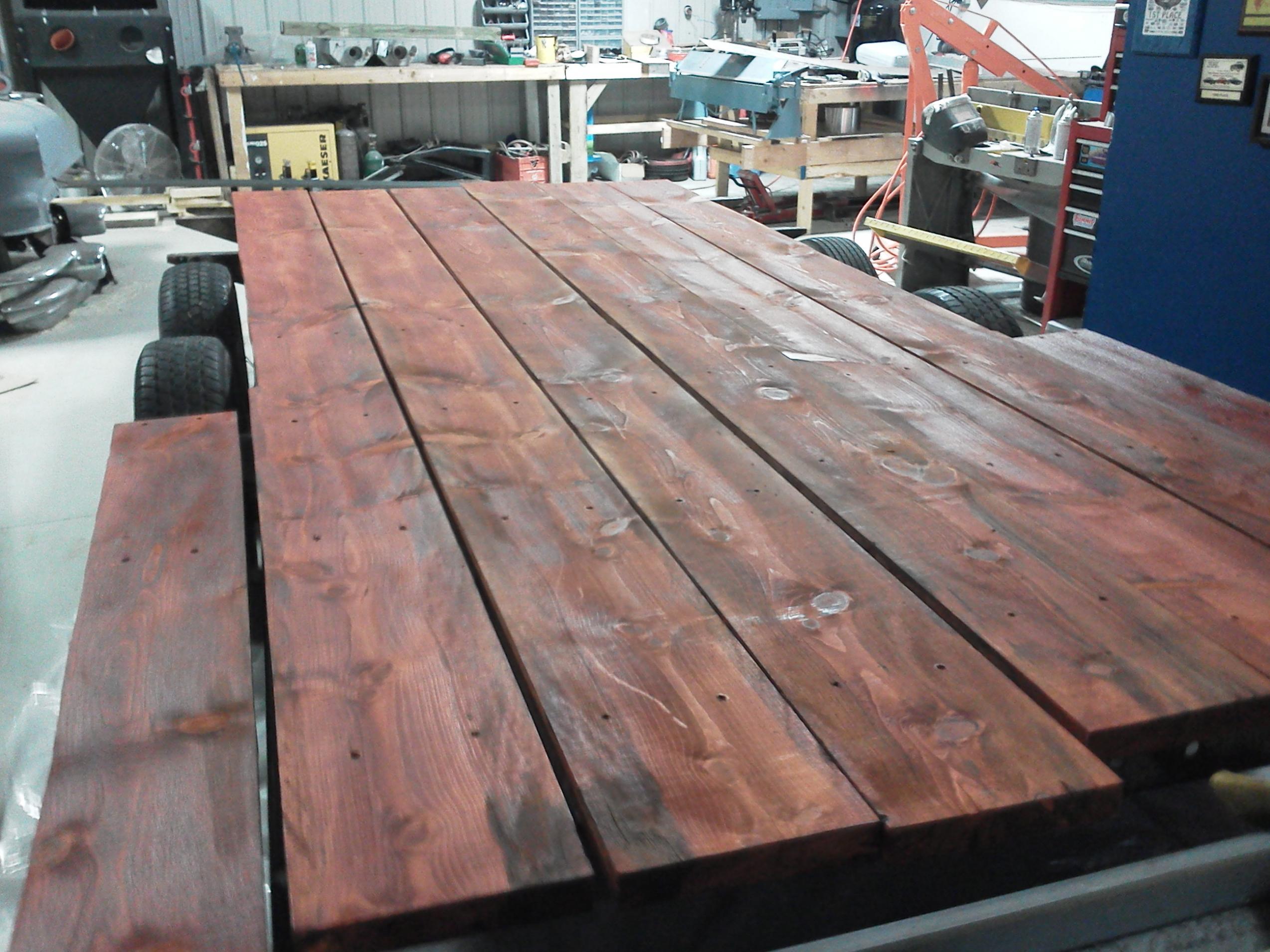

  5. Badillac56
    Joined: Sep 28, 2004
    Posts: 41
    Badillac56
    After the precision chainsaw trimming was done I had to research what kind of sealer to use. I decided on cabot. Pretty oily stuff. A lot of folks said to use diesel fuel but I figured I'd smell like a gas station evert time I go tunder a car on the trailer.
    I stained all sides of the rough cut and bolted it down right away. I didn't want to waste 200 bucks of timber letting it warp.
    I butted the boards right up tight next to each other and its a good thing I did. It's been only a month and now there is almost a half inch in-between each board.

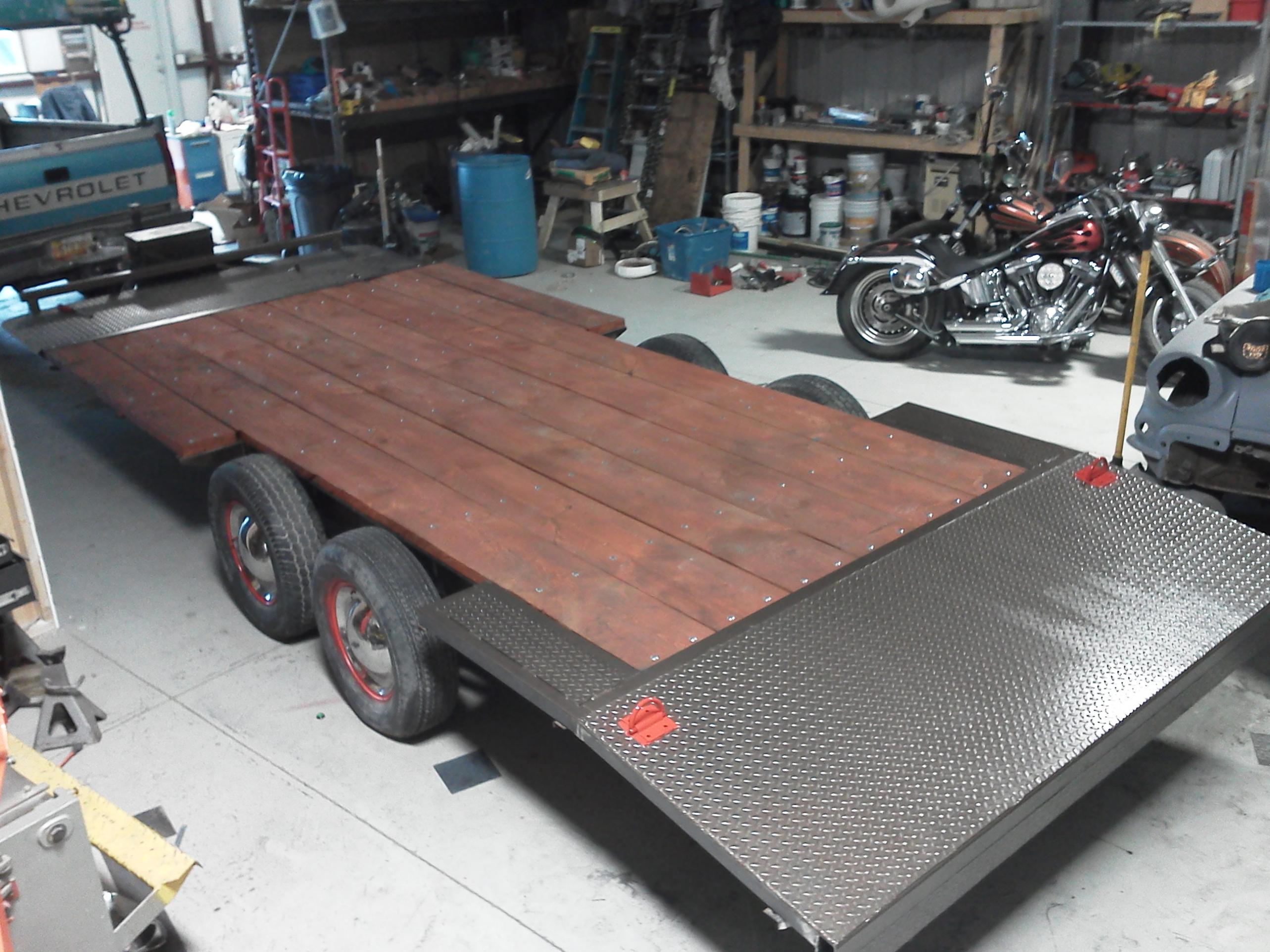

    After all boards were bolted I contemplated it for a while and decided to go with 1/8 inch diamond plate steel for the dovetail. Finished that up yesterday.
    Oh and I painted the wheels red and I have some 50s chevy hubcaps on it. All the diamond plate has been painted with rustoleum, I used a roiller and put a thick coat on.
    Found some d rings and welded them on too.
    All I have left is fenders, lights, and to go through all the state weigh in and deputy inspections them I'm on the road. And the ramps.
    I'm in it $1150 right now and about 50 hours labor.
    It's almost 8 feet wide and 20 feet long.

    It has 7000 lb axles with brakes on all 4, if I was going to build another trailer this beefy I might look for 10000 lb axles.
    Fortunately the tubing is really solid

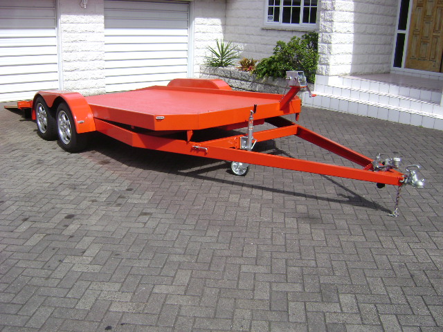

    You can see the actual tongue in this photo is the piece underneath [ it's not a support like you suggest ]
    What he has done here is raise the coupler height [ or lowered the trailer ] , so instead of putting a "Z" in the tongue he has taken the top piece back to the front x-member.
    Nice workmanship!
    I have built trailers using 2"x6" ,because you have greater beaming strength from a 6" blade [standing vertical ] you can get away with 1/8 wall thickness.
    I have also folded up "lipped channel" to make a tongue 2"x6" tapered down to 2"x3" with 1/8" wall thickness
    Channel has poor torsional strength but good beaming strength, I couldn't mount the jockey wheel on the side
    Here is an example, total weight is 680kg's [1496 lb's] for this example , it towed like a dream
