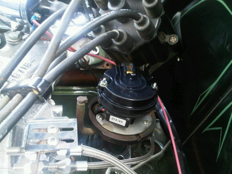

  30. 55oldsrocket
    Joined: Jun 29, 2007
    Posts: 138
    55oldsrocket
    from Santa Ana
    these pic attachments show how its currently wired. i am switching the coil tonight and see what happens.
    do i need a resistor or not? and how would i wire that? i wired the car with a rebel kit
    coil is an accell
