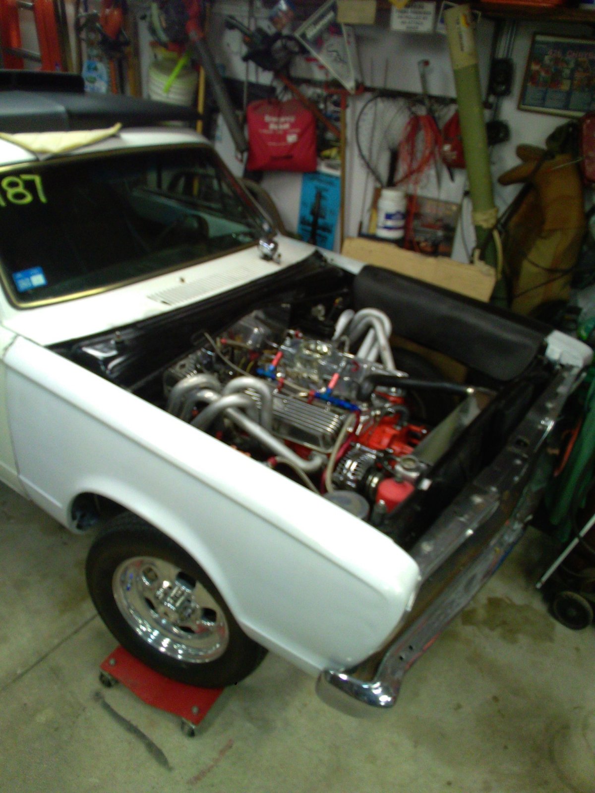

    There are posatives and negatives with running fenderwell headers. I think under hood temps are lower due to more airflow, but removing the inner fender does remove some strength from the front. The structural strength can be restored with a tubing brace from the firewall to the frame rail. Under ch***is headers are a total ***** to install on most Mopars. I imagine its even worse on early A bodys.. Fenderwells are super easy to install and remove. Tire selection will also be limited to smallish front runners. If you plan to build your own headers, fenderwells should be much easier to build.
    My Valiant is a street terror that i race and go cruising in, but wouldnt use it for transportation. This is how I have driven and raced it for the last 24 years. KIMG0063_111756.jpg
    Sharpone likes this.

    Cool car, well I’ll erase the scratch out line. I’m not looking to build a daily driver, just a toy, maybe go to the strip a couple three times a year.
    I JUST LOVE THE BUNDLE OF SNAKES look, if I was practical, sensible, not a hoodlum I wouldn’t be here on this site would I ?
