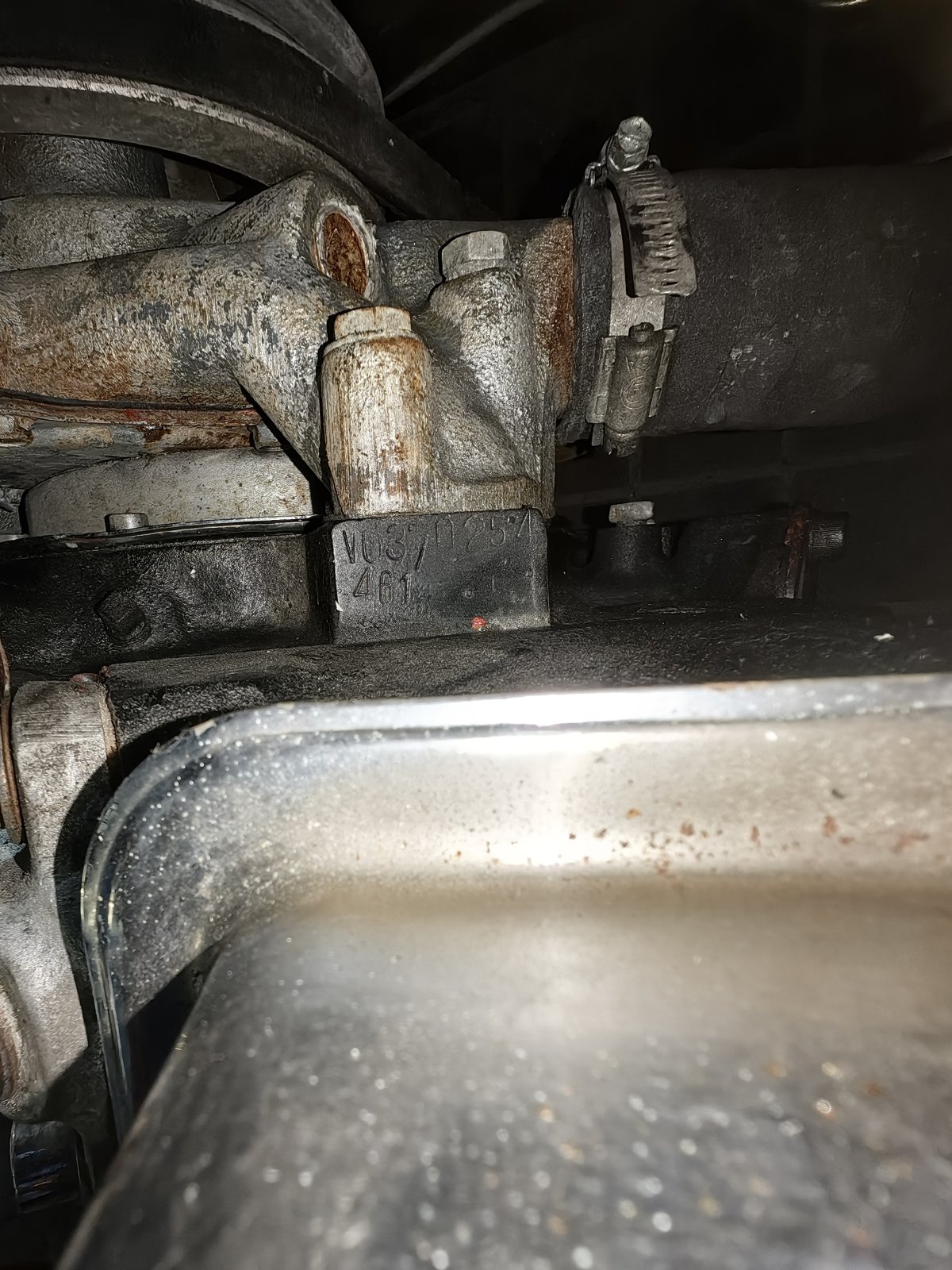

    I bought a used car years ago with a Chevy V8 small block gen 1.
    (at least I think it's a gen 1)
    I'm not able to find the engine code, so I' don't know what it's out of.
    It's a weekend driver, it's always started and ran fine, but had that hot restart issue.

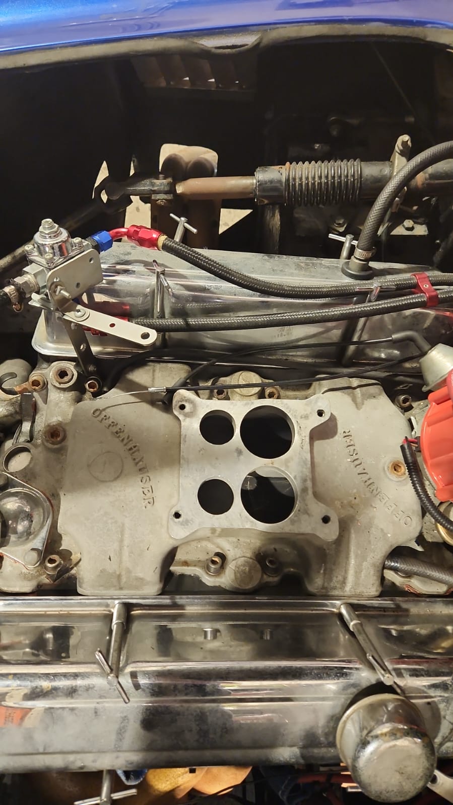

    But my intake manifold, doesn't have the right bore sizes to match
    This is the adaptor on there now, I had switched to plastic cause of the hot restart issue.

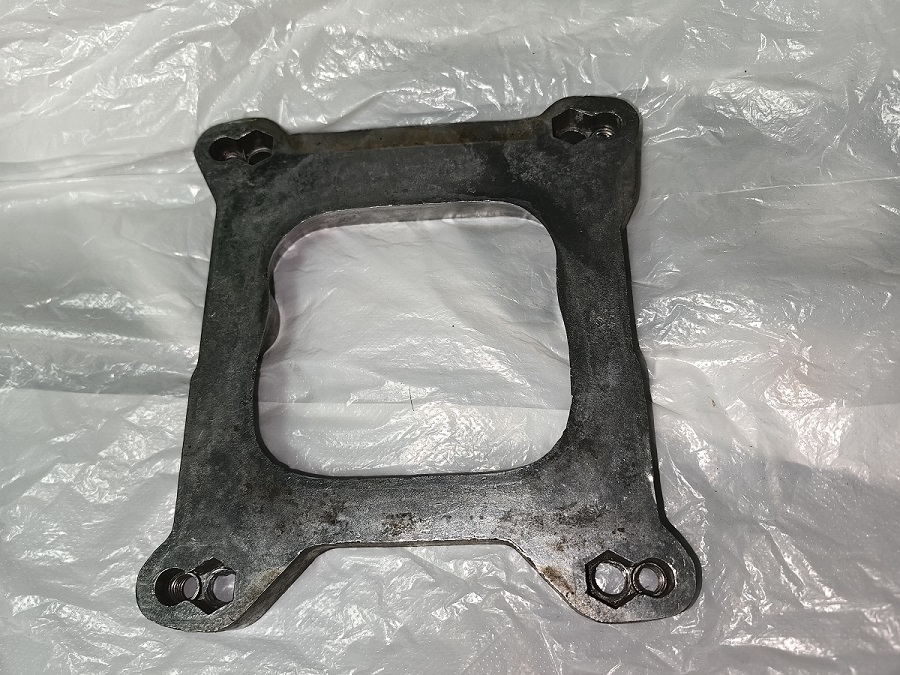

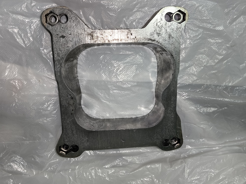

    This is the adapter plate that was on the car when I bought it
    (this is the one thats been on the car for years)
    Mechanic says no way the car can run and drive as it's just dripping fuel in.
    But I've been driving in on and off over the last few years when using the metal spacer.
    I know it's not a good match tough, so we're trying to figure out a way to fix this.

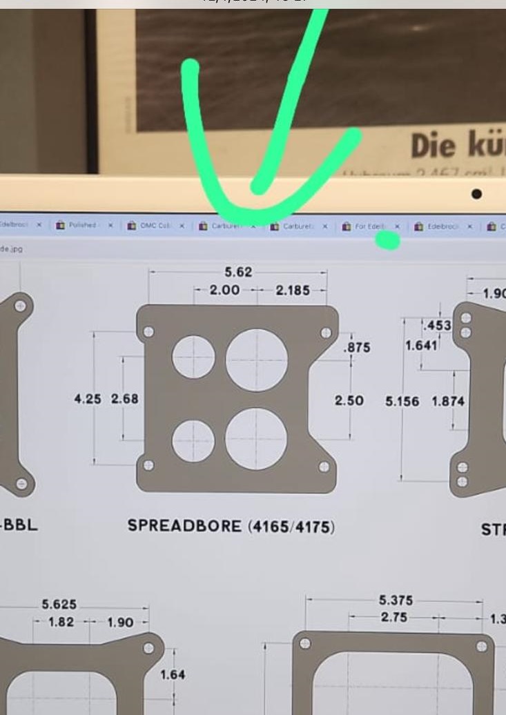

    He showed me a pic of an adaptor plate with the pattern to match the intake manifold
    Also it should have some "groves"? (not sure how else to describe it) on the top surface of the spacer in order to match the vacuum ports on the bottom of the carb?
    I'll bring him the old spacer to put back on, but he suggested I get a new one with the bores matching and with the grooves for the vacuum port (not sure if I'm describing it right)

    you need to put the adapter that was on it when you bought it back on, also I moved this thread to the main forum, questions and suggestions is for questions about how this site works

  4. You need to use the original adapter to mount the "square bore" 1850 to the spreadbore manifold. The dripping fuel is an issue with the carburetor-float setting, pressure, dirt etc.

    there is a pretty fair chance that that square bore spacer did not completely cover the secondary bores in the manifold causing a vacuum leak.....

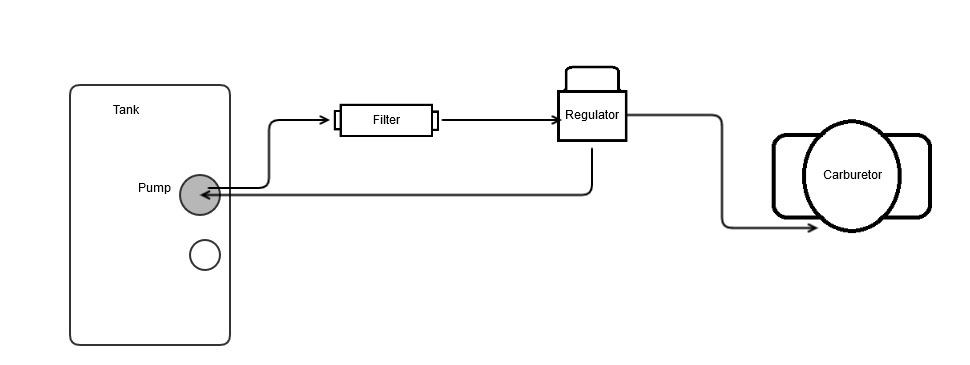

    I have 2 filters and 1 Holley FRP, but no relief valve.
    I had read a few posts from the internet where people converted to the return line system, but this is the first time I am hearing of a relief valve being needed.

    The problem with modern fuels is they vaporize at about 180° which is the same as under hood temps.
    This isn't a problem with EFI pressures.
    You need about 15psi to prevent vapor lock [more is better] but this is too much pressure for a carb
    With the bypass regulator shown in your schematic, any pressure above the setting is returned to the tank .so the whole line would be the same pressure [usually 6 psi]
    What can be done [in a race situation or bad vapor lock situation] is to use two regulators inline, and an EFI pump. [set the regulator at 15-20psi]
    Between the Bypass regulator and carb mount another dead-head regulator set at carb pressures [eg: 6psi]
    All fuel before the dead-head regulator is at 15-20 psi [so it won't vaporize] after the dead-head regulator is at carb pressure. And the EFI pump flows enough volume to keep the fuel recirculating and cool.
    On my race car I used a Bosch 044 external EFI fuel pump and only a dead head regulator mounted close to the carb.
    Just prior to the dead head regulator a return line was T'eed off back to the tank and a 15 psi inline relief valve was mounted near the tank.
    The whole fuel system including the return line was 15 psi
    The inline relief valve serves the same purpose as a bypass regulator

    Looking at the other thread I'd question whether the regulator you have is a bypass regulator or not. To run a deadhead regulator in a bypass system the regulator needs to be needs to be downstream of a fuel log, in the return line.

    The fuel regulator does not look to be a bypass.
    How is it marked ,is there a part # & brand on it ,
    Is bottom marked " in ", left & Right out ,

    "Dripping Gas" on a Holley 4 barrel usually indicates high float level or a blown power valve. Or that way more than you need fuel pump pushing too much pressure and pushing gas past the closed needle and seat.
    Your "mechanic" is suggesting this style of adapter. That maintains individual runners rather than the open plenum That the spacer you have does. The individual runners being a bit better for Idle and low speed adjustments while the open style works for wide open throttle but can be a challenge to get the idle as smooth as one wants it. At highway Screenshot (729).png speed running down the big roads you don't notice much difference.

    Thats another rabbit hole of a story.
    At the time when I ordered it, everything was on backorder due to supply chain issues. so the
    "CARBURETED BYPASS FUEL PRESSURE REGULATOR" part number 12-803BP was not available,
    However I was able to get the Holley 12-803 o_O
    Some forum posts talked about modding the 12-803 (non bypass) into the by-pass version as both
    I forgot which forum I found that thread on, but here's video that shows it:
    Thunderhead289 also did the same,
    and he also has the Holley Blue pump. He also had vaporlock issues
    Until he converted to a return line setup.
    So that what brought me down this path...

    My engine doesn't have any casting number anywhere. I guess the previous owner used a rebuilt/refurbished block.
    The only number anywhere where by the front right of the car (when viewed from the driver's seat )
    These number are not cast, looks like they were stamped in. It reads "VU370254461"
    I've tried to decide this, with no luck.
    Anyways, I was hoping to identify the block so I can buy a intake manifold like the one the mechanic suggested.

    Here's a close up picture of the intake manifold in the car.
    As you can see, right under the circular inlets, it's one big open space shared by all the banks.
    Seems like thats a problem?
    Tough I have driven the car before, however it's also never been reliable....
    I've had serious hot restart issues and plug fouling.
    If the new intake manifold helps, then I'd be happy to get it.
