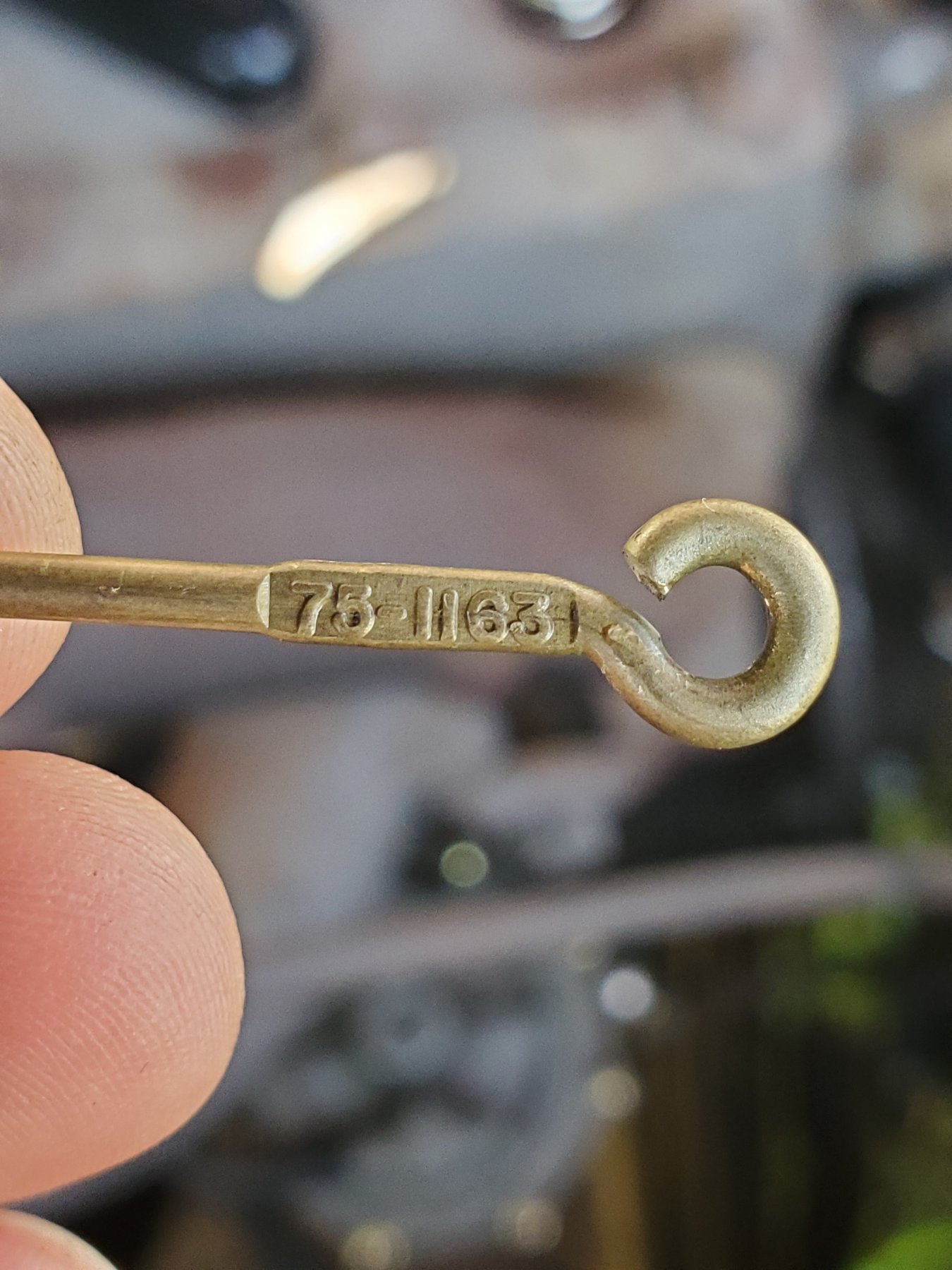

  2. White Nightmare
    Joined: Sep 20, 2007
    Posts: 45
    White Nightmare
    from WA
    Okay, so I kept wondering if maybe I swapped the main jets when I rebuilt the carb. I opened it back up to find the bigger of the two sets in the front (Primary), and the smaller in the rear. The weird thing is, the rear jets with the smaller openings have a bigger number on 'em. They read 120 on the top, and 175 on the bottom.
    The front jets with the bigger openings read 120 on the top, and 165 on the bottom.
    Also, the rods read 75-1163
    Is this normal or is something weird goin' on?

  6. carbking
    Joined: Dec 20, 2008
    Posts: 3,975
    carbking
    Carter part numbers, in this time period, are part numbers. Not until the mid-1960's did Carter codify the jets with the actual sizes.
    Metering rod part numbers are.......................part numbers.
    But your rods are just plain wrong, and exceptionally lean. IF your carburetor IS from a 1953 Packard. I may have missed it, but did not see where you posted the tag number.
    Jon.
    White Nightmare and Truck64 like this.

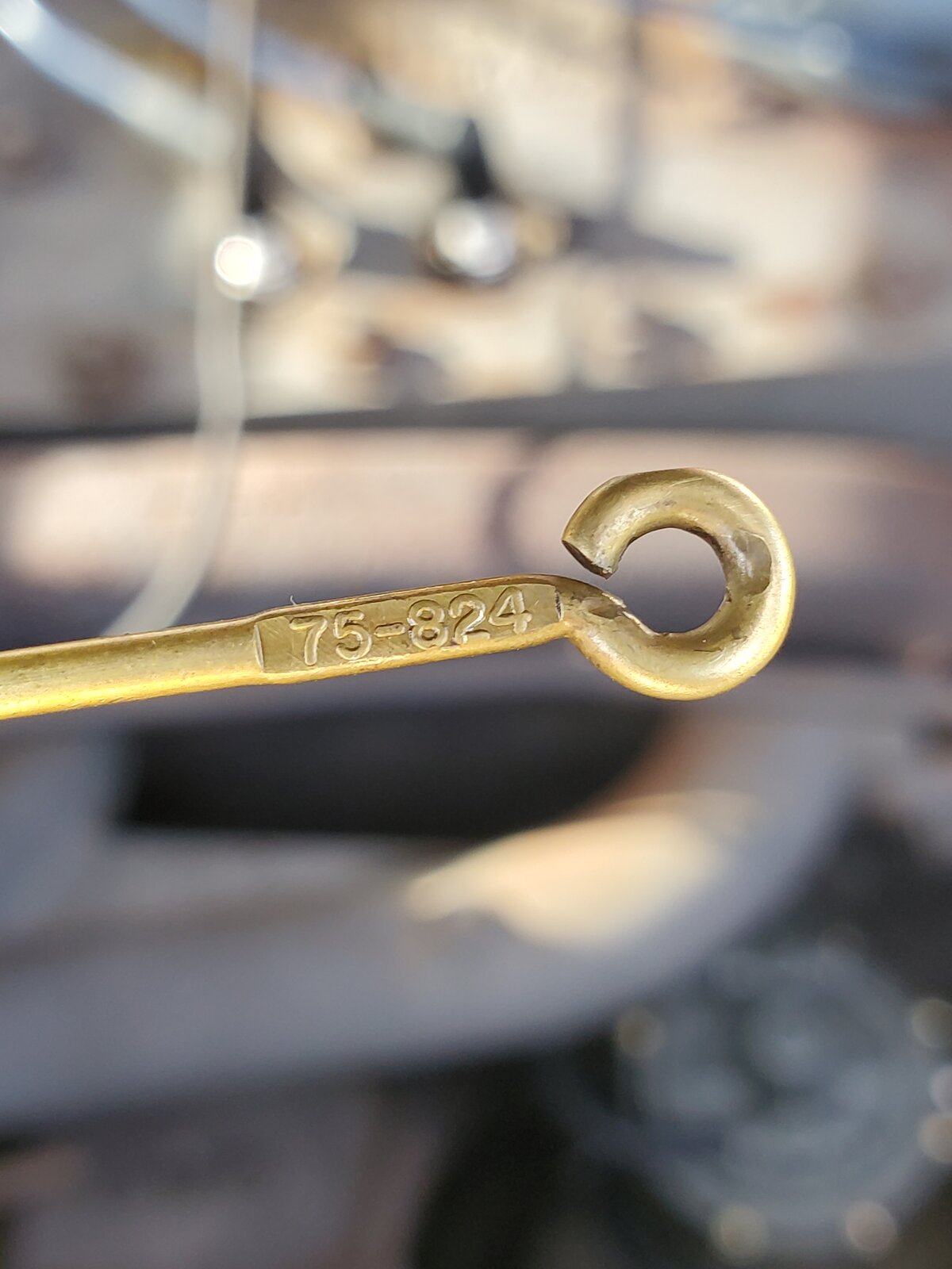

  9. White Nightmare
    Posts: 45
    White Nightmare
    from WA
    We did it bois!!!
    It was those damn metering rods this whole time!
    Once I was convinced that the wrong ones were in there, I went over to my spare engine and pulled the metering rods out of it. Sure as ****, the factory (Standard) 75-824 rods were in there. I threw 'em in the convertible, took her for a drive, and she's a TOTALLY different vehicle. I couldn't believe how nice she drives now.
    Funny enough, it's not at all surprising that the wrong rods were in there. When I initially rebuilt the carb, every single adjust was so out of wack it was insane. There were even small misc pieces that were missing. That spare engine donated those parts as well.
    I've been trying to make sense of those rods though, just for the sake of trying to understand their thought process. The only thing I can think of, is maybe the floats were adjusted really high, causing her to run really rich. Instead of fixing that, they installed these super lean metering rods to try to fix the rich issue. Who knows though, it's fixed now and I suppose that's all that matters.
    Anywho, I guess the morel of this story is, don't ***ume a stock type of vehicle is totally stock and un-messed with. Even totally stock looking Packard's can be screwed with by people that don't know what they're doing.

  15. carbking
    Posts: 3,975
    carbking
    GUESSING here that this was just a question of a previous "rebuilder" not understanding what they were doing.
    The rods you have are from a 1954 Packard WCFB. Carter increased the primary jet size by a LOT for 1954, and then sized the rods accordingly.
    Possibly, this individual had a couple of WCFB's and "made one from the best parts of both". When we were still restoring carbs, quite often we would get this request. No one every liked the answer!
