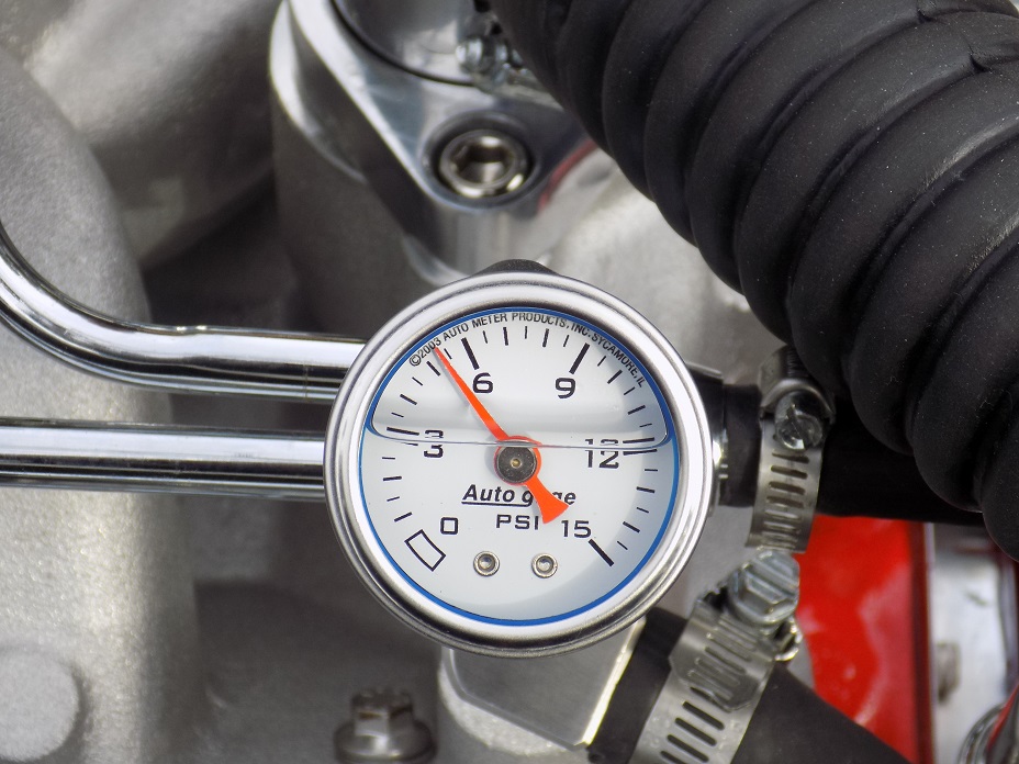

  9. bobss396
    Joined: Aug 27, 2008
    Posts: 18,814
    bobss396
    I use an Auto Meter fuel pressure gauge, not cheap but works well.

    I was watching a video from Holley. They said in there that if you are using a mechanical pump. They are low pressure, so that you don't need a Pressure Regulator. Haven't done the vacuum Gauge with the mixture screws yet, but I will. Now once that is done. My Wife is going to step on the brake, and put it in gear. Whatvscrew do I adjust now??
