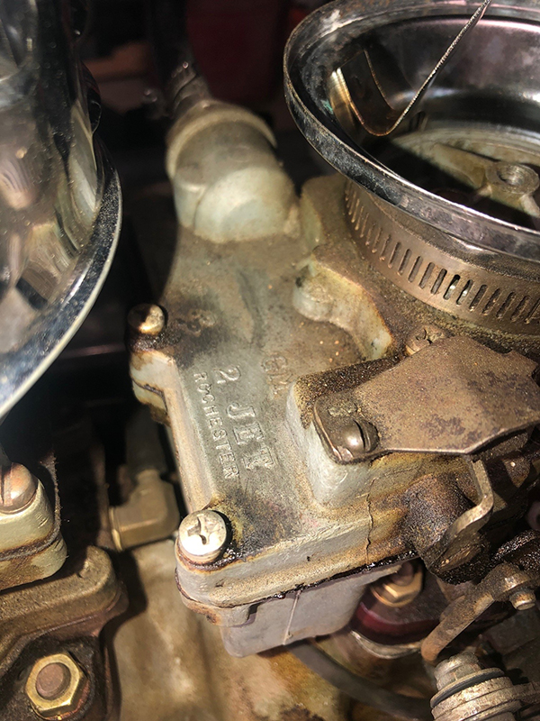

    I have three of these on a tri-power setup. No tags or numbers. How do I know which rebuild kit I need?

    Post pictures from several different angles, include the linkage arms and maybe we can narrow it down for you.

    I see a bowl vent and side inlet, a screw plugging choke shaft hole on the air horn with aftermarket intake manifold and linkage.
    all good clues.
    more pictures would help, front, back and both sides of all three.

    Thanks for the help guys! I think you have me on the right track. Pic of the coupe.

    I can see what looks like idle screws on at least the rear secondary and primary throttle arm on front secondary.
