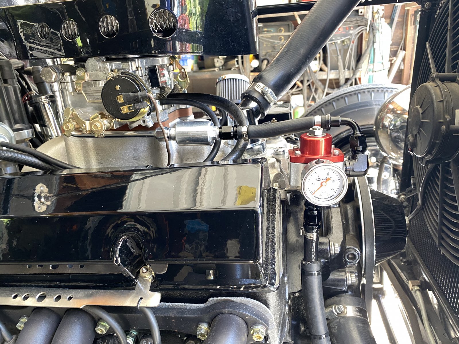

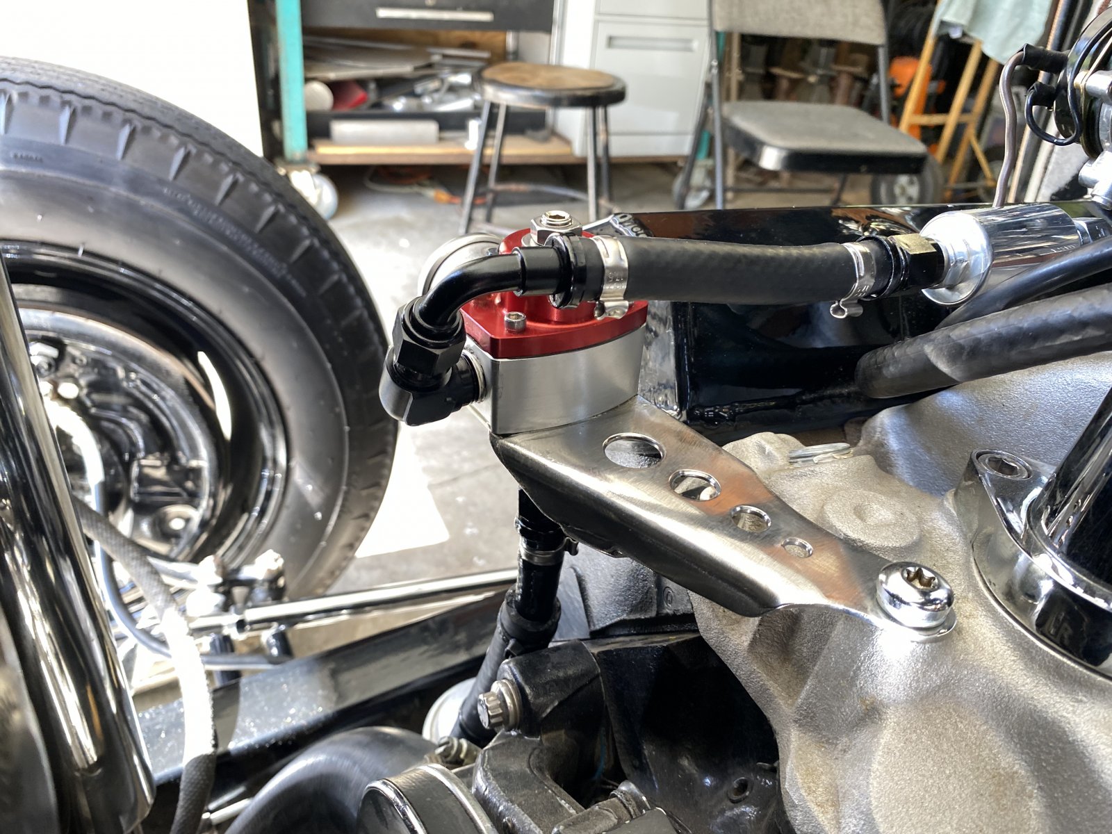

    Update....got the regulator installed and set at 5.5 psi......all is good....starts, runs, idles better..... F9E670C8-0504-470F-96D2-828A4E19243B.jpeg 0FD4B45F-0927-494A-837C-12EB8D028203.jpeg

    What concerns me is the folks at Edelbrock didn’t offer that advice. Glad you got it fixed though.
    mad mikey likes this.
  14. Nice fix. Yea , those Edelbrock carbs hate high fuel pressure. 5-5.5 is good to go.
    olscrounger likes this.
