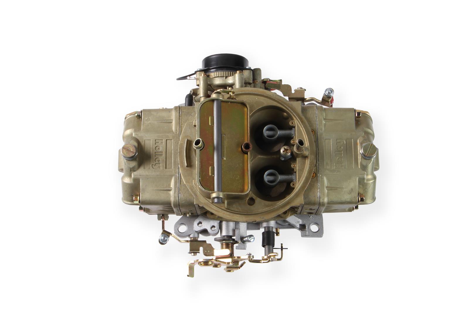

    Something that's easy to try...remove the linkage connecting the two carbs. See how it behaves.
    here's a picture of a 750 holley, and a 450 holley, looking down. Compare to yours. I think you have way too much carb. See if you can find a single 4bbl top for the tunnel ram?
