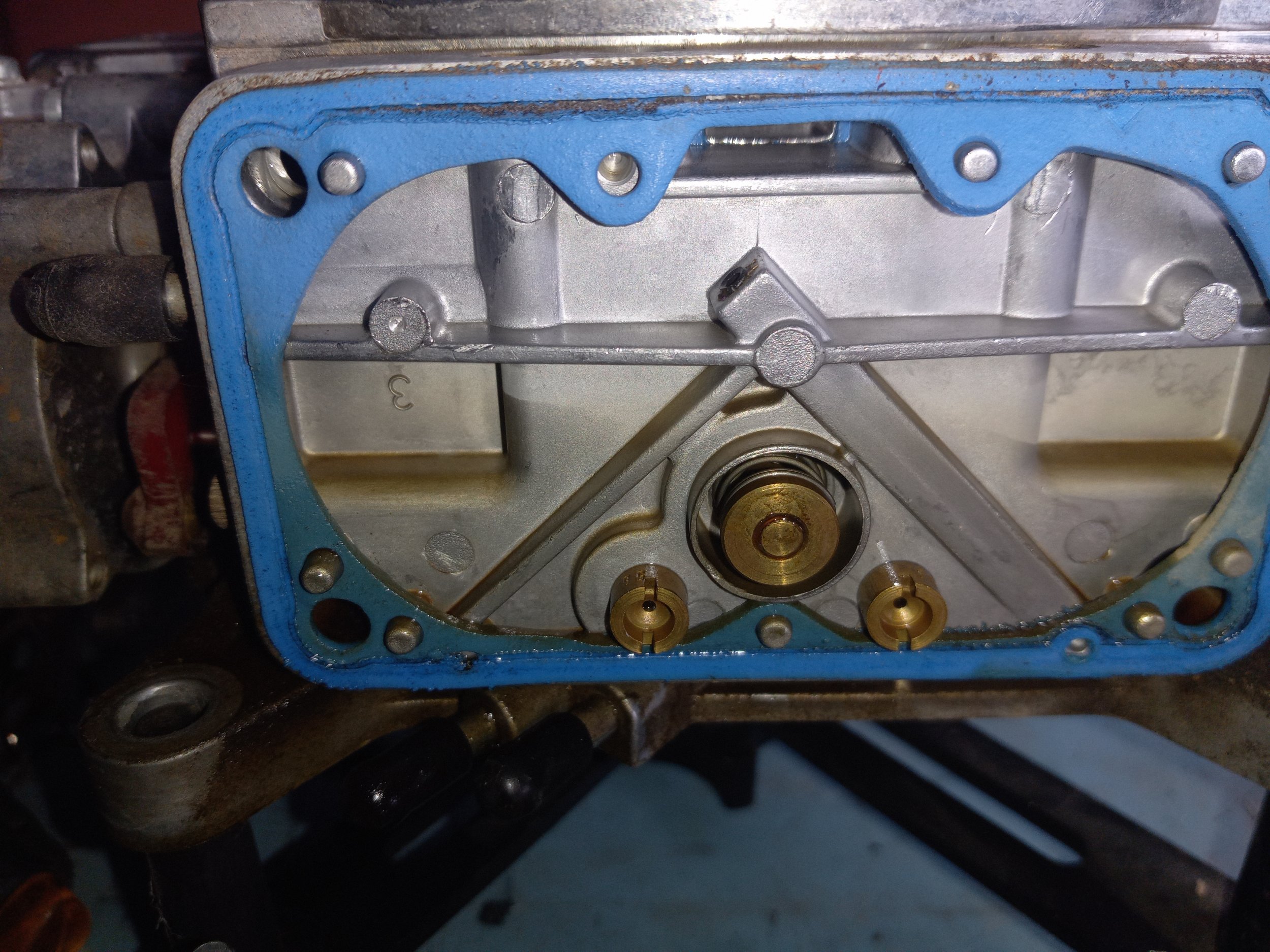

    Apart
    Bottom screws were tight, so I'll take another crack at them soon.
    Going to try less obnoxious liquid than carb cleaner, hoping to save the labels.

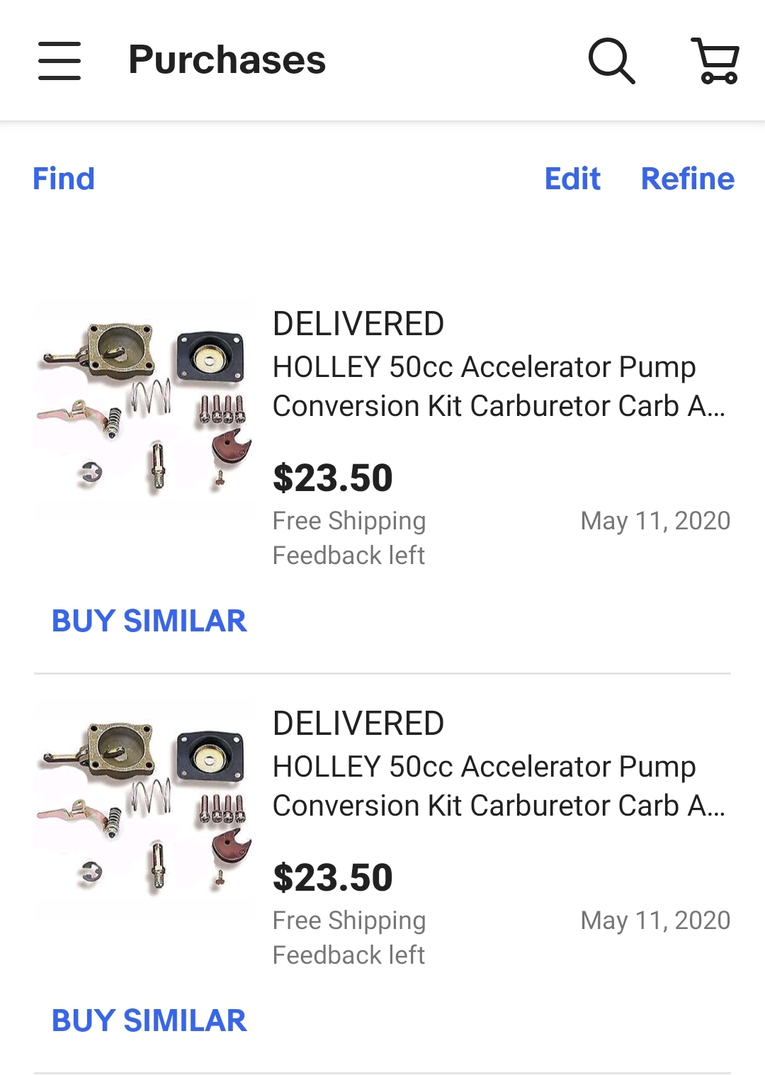

    So this is the least expensive kit I saw from the USA. $45 each. I'll call this one Basic.
    https://www.ebay.com/itm/194017830687
    @gary macdonald and @swade41 I have a couple of dumb questions, since I haven't gone this way before.
    1. What I'm seeing is the more expensive or Deluxe 50cc kits have 2 cams, Brown and kind of Yellow. The Basic kit only has the Brown and that seems to be the one most single part sellers have. Were you guys using the Brown cam?
    Here's a Deluxe kit with both cams and the arm for the next question.
    https://www.ebay.com/itm/285018444578
    2. Both kits come with a new arm, which I understand, but the Basic one has an exposed spring like a 30cc arm, where the Deluxe one and other 50cc carbs I've seen have a tube, as shown. I'd ***ume that will work for my app, but is this okay? Looks like it's stronger, too. If I need the Deluxe kit, I would rather buy once, cry once. The kits swade posted are like the Basic one.
    3. When looking for the Yellow 50cc cam separately which seems to be not listed, I came across this, a wide Brown cam. From all the pics, the arm is only so wide and should ride on the 'narrow' cam just fine. Is it just for the tube arm, for edge cases?
    https://www.ebay.com/itm/170478745767
    From a review on this item
    Do you have an application that requires a 50cc accelerator pump? If so, pick up one of these pump cams. It is slightly different from the standard 336 brown pump cam and has pre-drilled holes for both the #1 and #2 positions. It also has a wide top surface for better geometry with the pump arm. The cam profile will give a relatively mild shot for low throttle angles, and it gets progressively more aggressive with increasing throttle rotation (hole #2), or a little bit more aggressive early shot (hole #1). Only use it if you need it and have already tried all of the standard pump cams. Probably NOT needed for most typical double pumper applications (dual 30cc pumps - 60cc total). Good for a lightweight car with a manual transmission and shorter rear end gearing.

    You don’t want to open the secondary faster , if anything you need to retard its opening . The idea is to keep the velocity mixture up so fuel doesn’t drop out of suspension and lay on the floor . Do anything to keep the velocities up . Thats what a small plenum does . I’ve gone so far as to , well lets say I experiment alot and a brick didn’t work .
    the pump cams are interchangeable

    Got everything cleaned up, wiped down and both arms adjusted. One did have a bit of play but doubt it changed things much.
    Still need to buy studs to install, and either the cams or the 50cc pumps. If I get the pumps, I'd expect to use the included Brown cams, so won't buy both. Still researching sellers, since I don't do paypal or amazon.
    Jegs and summit want 11 bucks for regular shipping unless I buy more stuff. Wondering if I should just wait for sales in a couple weeks and try it as-is. Not much driving weather left.
