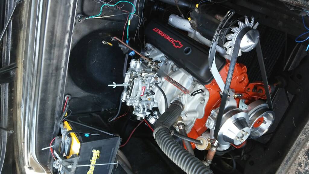

    Hi All,
    I've read several threads but haven't gotten the info I need. I have a SBC350 in my 53 Chevy (I believe its from a 73 Chevelle) which I use to just cruise around. It's harder to start up after driving it for a while and letting it sit for a few minutes. I suspect I need the right spacer or gasket combo. I have an Edelbrock 1406 carburetor and what appears to be a 0.5" (or maybe thicker) aluminum spacer.

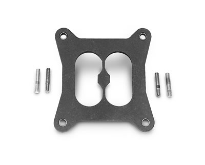

    I thought about getting the Edelbrock 9266 insulating gasket and keeping the aluminum spacer and getting a new thin gasket for the aluminum spacer to intake side. Does anyone think that will work fine?
    While we are at it, should I be getting gaskets with an open center or divided center?

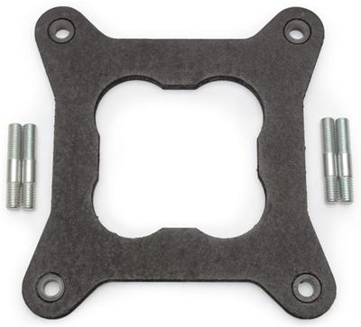

    Edelbrock has the 9265 which is an open insulating gasket and I don't know if I should use the 3899 open gasket for the spacer to intake mating.
    I could also dump the aluminum spacer and get a phenolic and two gaskets.

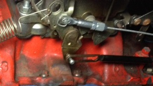

    I checked and have a 5psi rated fuel pump but haven't observed the actual fuel pressure. Here is a photo I had from a while ago, (not at home right now to take a new photo, note I also added a second return spring).
    Thanks.
    9265 insulating gasket

  2. chargin03
    Joined: Jan 8, 2013
    Posts: 518
    chargin03
    I used a insulating gasket and that took care of that problem for me.

    the "spacer" on that is most likely an adapter to fit the square bore Edelbrock carb, onto the stock Quadrajet intake. Not really the best setup.
    My old Suburban has a quadrajet on a similar intake, and doesn't have any heat soak issues at all. But it also has a return line and 3 port mechanical fuel pump.

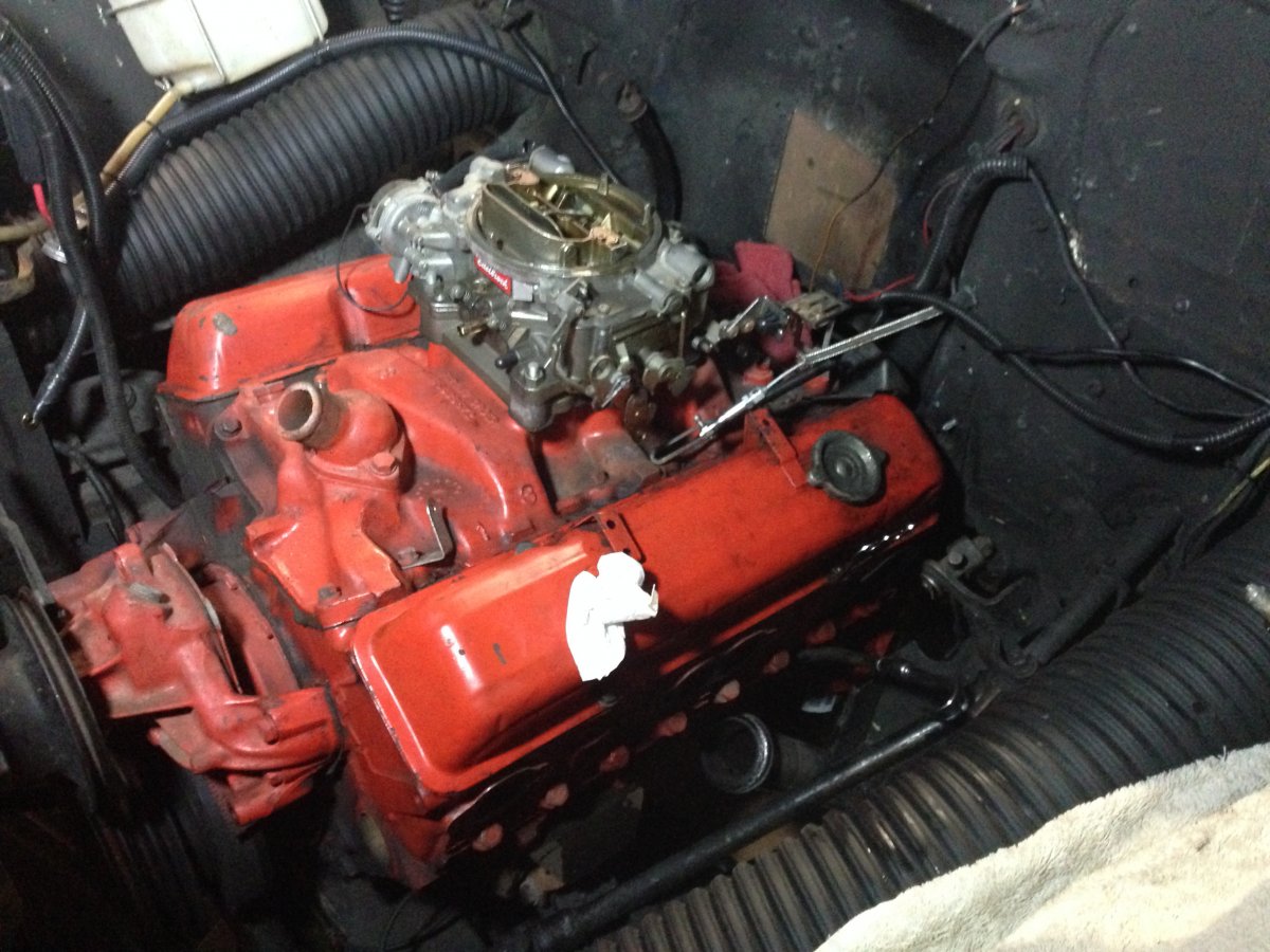

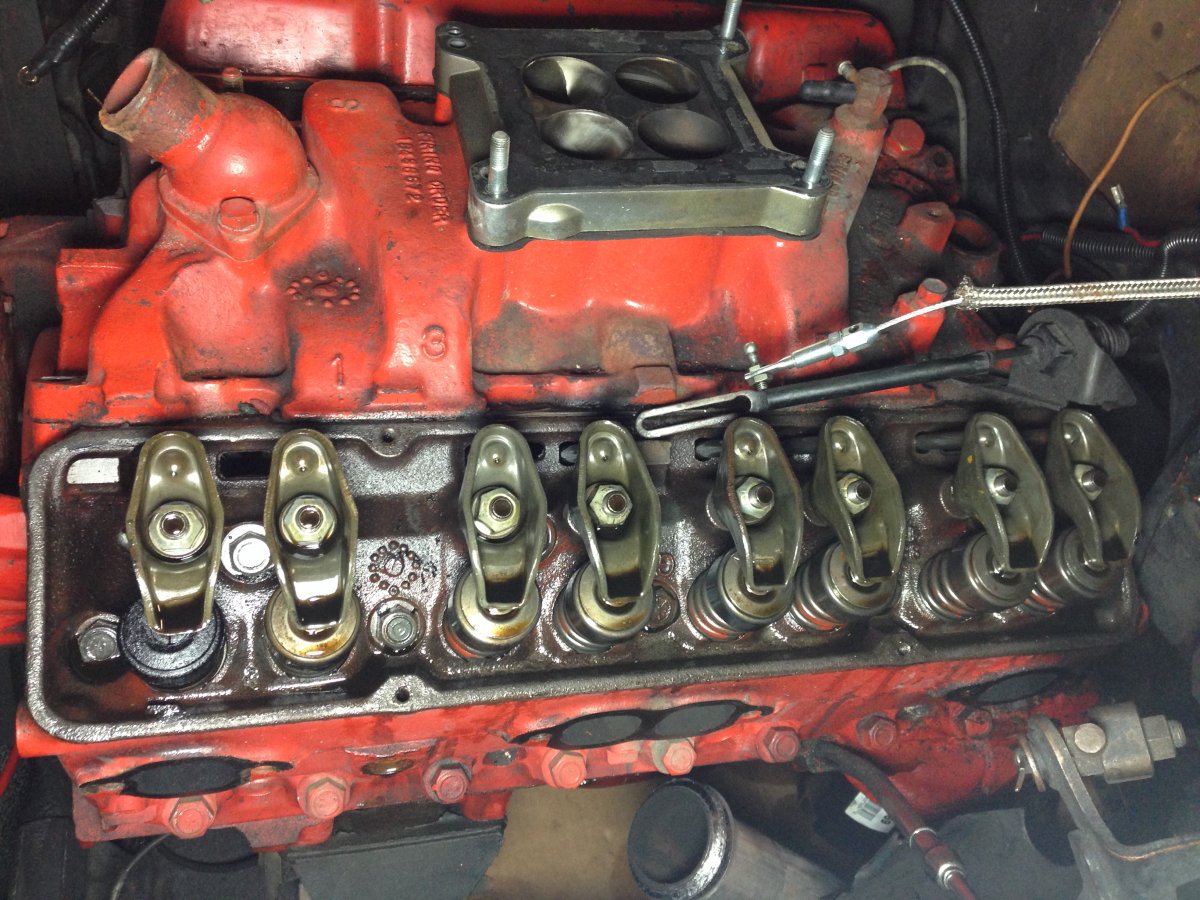

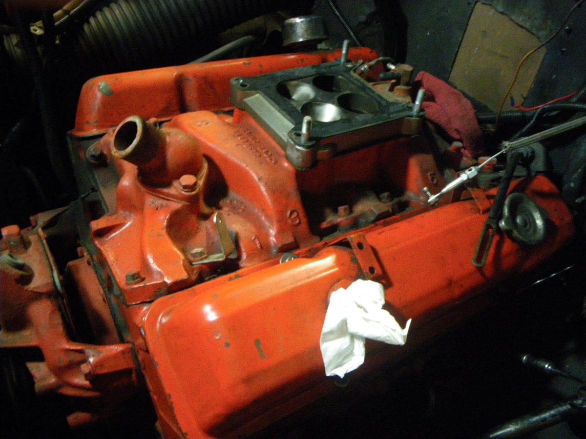

    Can anyone tell from the photos below whether I have a spacer or an adaptor?
    These are old from when I took out the driver side cylinder head early 2015. I supposed I could also take the carb and that adaptor or spacer out and look at the intake to see what looks like under the spacer/adaptor. I can't remember.
    I was thinking of getting the Edelbrock 9266 heat isolator gasket that has the center divided and placing it between the carb and that spacer, and then replacing the gasket on the plenum to spacer/adaptor with a regular open non divided one.
    Sadly, when I took out the head/intake out and put it all back together, I reused the carb gaskets. I imagine that was a bad thing to do reflecting back now and perhaps could be the cause of a vac leak that may have to do with the mysterious beep noise I've reported before, although I could swear the noise is coming from the trans.
  15. gimpyshotrods
    Joined: May 20, 2009
    Posts: 24,513
    gimpyshotrods
    That is an adapter.
    It facilitates mounting a square-bore carburetor on a Quadrajet manifold.

    Thanks it looks like it might be a 2697 adaptor. Do some people use a 1" phenolic spacer on top of an adaptor like the one I have?
    My preference is to get the Edelbrock 9266 divided center metal insulator gasket which is 0.3" thick and use it between the carb and that adaptor, and use a thinner gasket for the adaptor to manifold side with the four round holes (whatever gasket the 2697 needs). Any thoughts?

    Cannot tell for certain from the pictures, but appears to be a square->spread adapter. Before spending more money on band-aids to fix a poor installation, try this fix THAT COSTS NOTHING for hard starting when hot:
    http://www.thecarburetorshop.com/Troubleshooting.htm#Hardstarthot
    Save your funds to fix it right in the future. If you really want to use the clone then purchase a square-bore intake to install; or, as previously mentioned, find a Q-Jet core or TQ core, rebuild it, and install it. If you watch NASCAR racing, think of the adapter as a poorly designed restrictor plate. You can easily lose 40 percent of the carburetor's capability using the adapter!

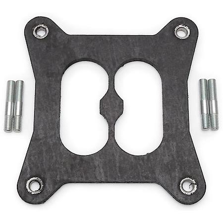

    I'm going to use a 1/16" thick Mr Gasket 56C for the intake to adaptor side.
    I will use a heat isolation gasket for the adaptor to carb side but should I go with an open, a split or 4 hole? The open and split are 0.3 thick and the 4 hole comes with two gaskets that are 0.125" (not sure why that one has two)
    9265

    notice the gaskets that have a grommet at the bolt holes...that will help keep the carb from warping, as it limits how much the gasket can compress.
    I would not worry too much about the flow restrictions, I get the feeling this car is not used for racing very often.
