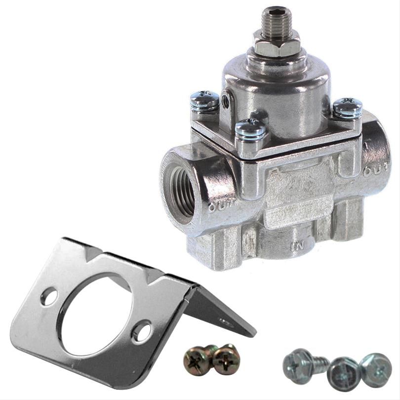

    Do you think this regulator is any good? I can plug one of the outlets. Not sure if I can install it closer to the fuel pump which is moutned close to the tank externally. I don't want to run it in my engine compartment if I don't have to.

    I cannot speak to the quality. You will need a gauge in one of the OUT ports.
    Pressure is pressure in a closed system. It can go anywhere in the system, however, as close to the carburetor as possible is best.
    When the float drops, and flow goes into the bowl, it will cause a momentary pressure drop in the line between the regulator and the carburetor. This is when the system is effectively no longer closed. The longer the distance between the regulator and the carburetor, the longer the delay there will be in stabilizing the pressure in the line when the float rises, and the needle closes.
    It probably unlikely that you will experience an issue due to this, but I cannot say for sure.
    Why don't you want it in the engine compartment?

    Thanks that makes sense regarding the fuel pressure delay stabilization when the flow goes into the bowl. I don't like the look of those especially with a gauge on there and it's another item I have to drill holes into the firewall and mount. I have steel line coming up from the passenger side along the firewall, then it goes to rubber into the carb but routed well away from exhaust and secured with clamps to the firewall.

    Just out-of-sight should be fine. It's not like you are going to be flowing out the entire contents of the float bowl with that setup.
