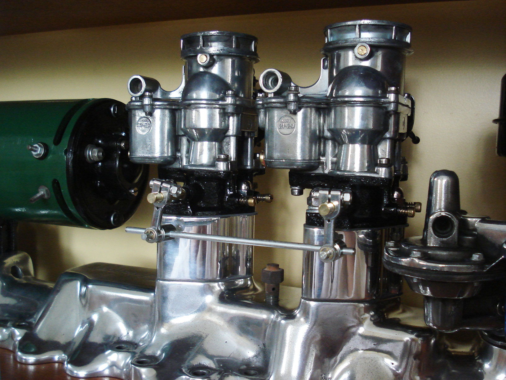

    Take a look at Dashman H.A.M.B. alliance vendor
  10. dashman
    Joined: Apr 15, 2009
    Posts: 774
    dashman
    from Viroqua WI
    I have yet to have an engine not respond positively to a spacer, especially vintage manifolds that were relatively flat to begin with.
    These days with the poor gasoline an insulator is a must, I prefer phenolic. A 1/4" phenolic riser will cure about any heat soak problem. If a lot has been modified from stock, fans, low engine, or like a huge air cleaner that acts like a heat sink, a 1/2" thick one might be better.
    1" and up aluminum carburetor risers work, period. Too tall can be a problem, but most guys that run too big of a carb try to make it better with a 4" riser, it won't work.
    Any engine that is modified will benefit. There are some really fancy risers out there and will produce results, but often you will have to dyno tune that engine to see the full benefit of that particular riser. It might not be worth the extra money unless you have the dyno time.
    We typically see an average of 15 HP on a riser, a cheap price to pay for that kind of performance.
