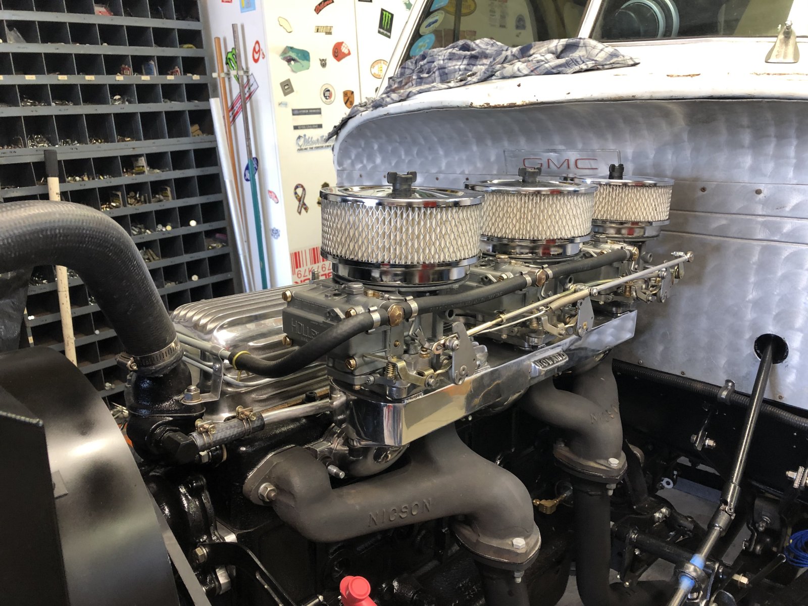

    IMG_2893.jpeg Yeah but you need to spread them out..:rolleyes::rolleyes::rolleyes:
